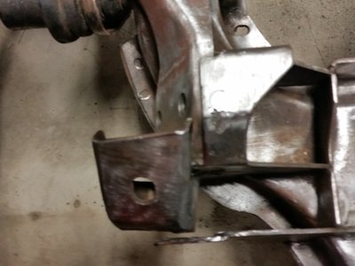

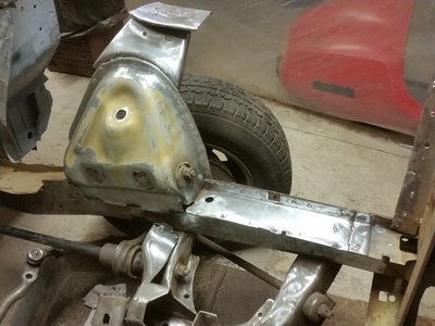

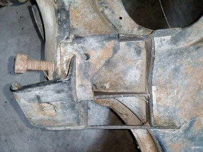

The more I look at it rr6pak the more I think it's been relocated. Here's a really good pic of a nice K-member.

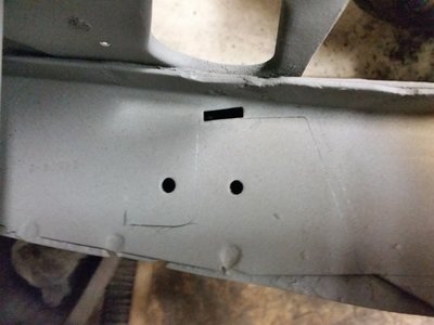

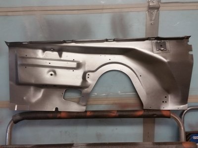

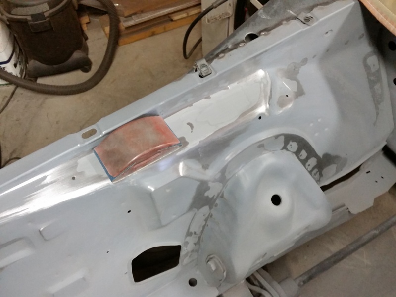

See the drivers side mount - the location looks different than mine. But until I get some real world measurements, I won't know for sure. But I have a buddy who has a 1971 Cuda. I will be looking at that K-member and taking some measurements from it. Until then, I'll keep working on other stuff, namely getting the drivers side firewall done. So here's what I have so far. Yours truly measuring up for a patch. And here's the patch (with a magnet to hold it)

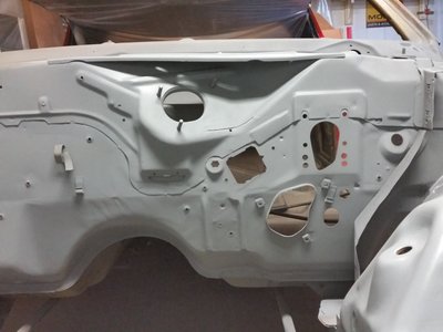

So this weekend was able to get some Zero rust paint on the frame rail.
And was also able to finish the firewall on the drivers side. So now I can go back and concentrate on the engine mount. I was able to see the K-member in a 1969 Charger and took some measurements. So looking at mine here. The mount is too far to the left by 1.5" - that's compared to the Charger mount. I will go and have a look at an E-Body K-member to confirm that measurement, so I won't do any cutting or removing till I have seen the E-body one.-

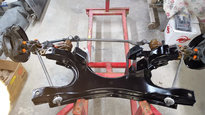

O.K. after taking little break (like going for 2 weeks to my home country of Croatia) I'm back working on the car.
After some more investigation and getting another k-member to use as reference, it turns out that both engine mount perches have been moved. So therefore I will be getting another k-member.
The good thing about getting another k-member is that I will be able to put the engine and front suspension parts on it, then drop the car over it when the time comes - just like Bruce did with his white one.

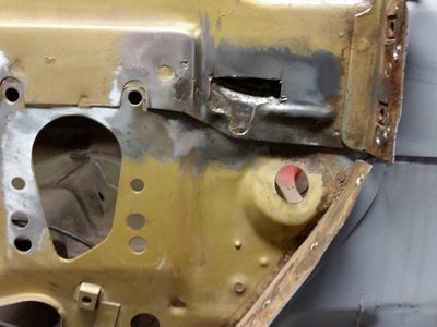

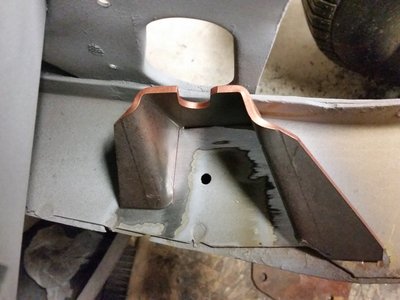

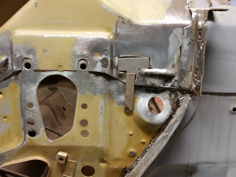

Today I prepped the bracket for the 4 speed z-bar. The raised area at the top goes into the slotted hole in the frame. Then grind the area clean & fit-check then weld her on and finish with a coat of primer. After that I started prepping the outer surface of the drivers side inner fender to get it ready for some rust bullet paint.

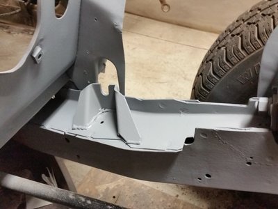

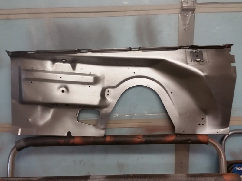

So continuing on, I had a small spot on the rad support to put some metal prep on and finish it up.
Then I primered the drivers side rad support. Next is to fit-check the inner fender and plug weld it in.- sdweatherman

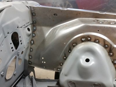

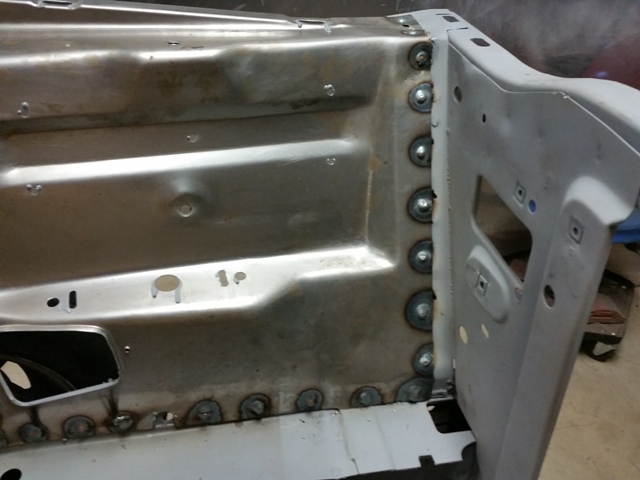

Ok so this weekend is the weekend I end up with a head cold - crap.

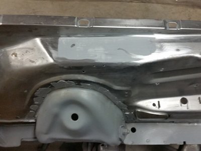

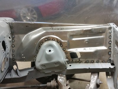

But I still got a chance to weld up the drivers side inner fender. Next step is to clean up the welds and put on a little putty.

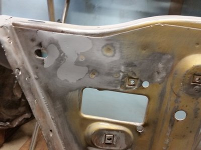

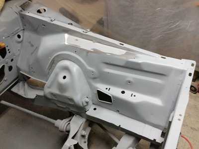

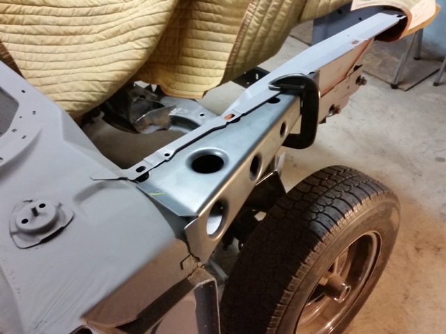

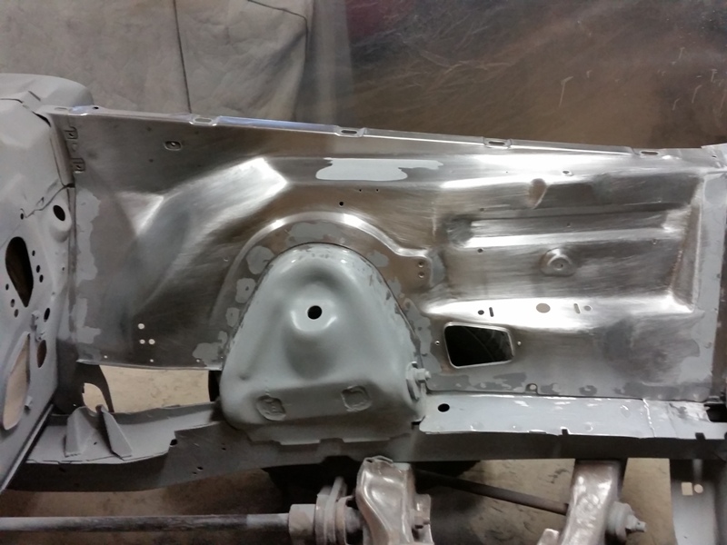

So to update from my last post, I ground down the spot-welds and applied some all-metal putty. Then get the all-metal sanded down and prep for primer. and shoot some primer. Next it's on to doing a fit-check on the US car tool inner fender braces. They don't make them for 1971 B-bodies so I ordered the ones for an E-body. I assumed the fender braces would be close as the inner fenders for a B & E body are the same.......WRONG! Here's some pics. so I'll be doing a little nip and tuck here and there. Hopefully I won't get too much grief.

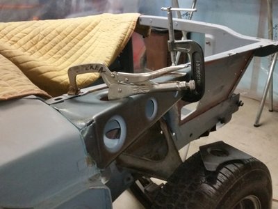

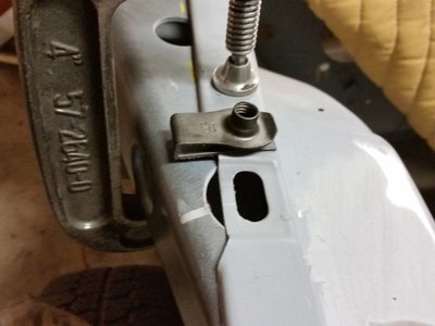

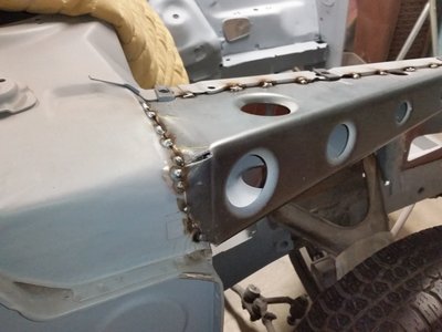

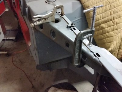

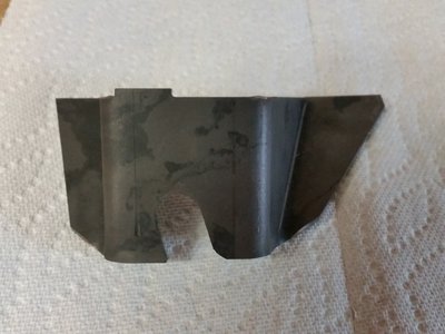

As I stated in my last post, I had a little fitment issue while doing the fit-check. With a little sister sledge hammer work it went from this.... to this........ But another issue has came up - it seems I cannot put the J nuts onto the inner fenders after tack welding the brace on... it looks like the reliefs that US car tool put into the braces are kinda small. So I need to order the proper J nuts. Anyone know where I can get them?

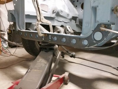

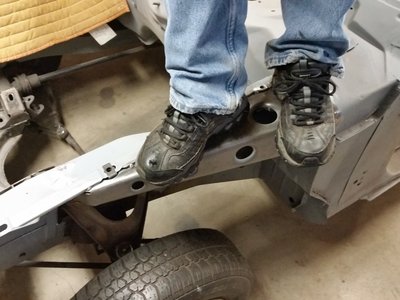

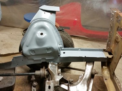

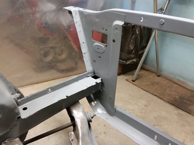

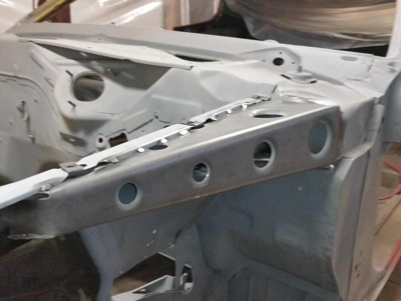

So over the Christmas holidays, I was able to finish installation of the fender braces, both sides. Here's the passenger side

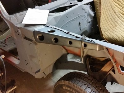

Next I moved onto doing a fit-check on the rad support brace...
and here's the drivers side. They sure are strong braces.....strong enough to hold me!

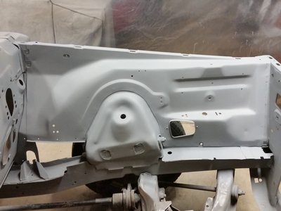

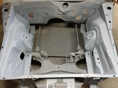

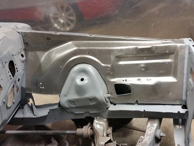

So,continuing on - the rad support brace is now welded in, so I had to back-step a bit. Seems that when welding the gussets in for the inner fender braces I wrecked some of the putty that was on the inner fenders, so I had to take it all out and re-putty.
and now the final primer coat which should finish up the engine compartment for now!!! Yay!!

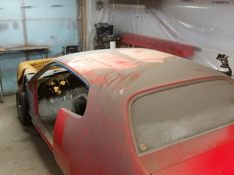

Moving on to the inside of the firewall, but before that i thought I should clean up the car and the area around it. Man I couldn't believe the amount of dust and crap on the car. Even on the trunk where I had one of the new rear quarters sitting on it, I moved the quarter off the car and this was underneath it.
