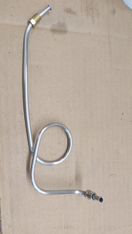

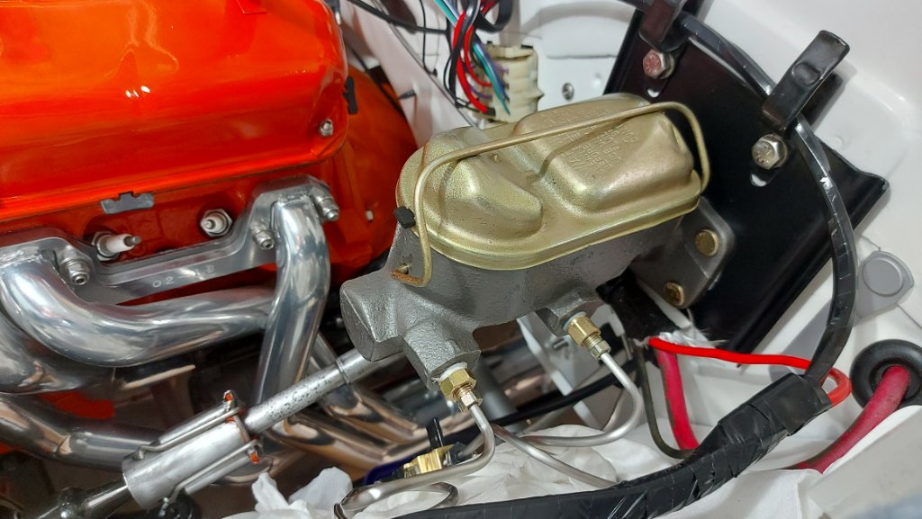

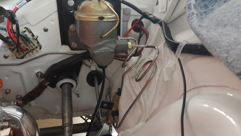

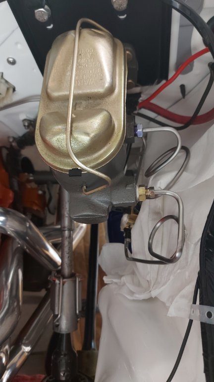

Taking advantage of the long weekend here in Canada (Victoria day) I decided to once more tackle the dreaded seeping brake fitting on the master cylinder.

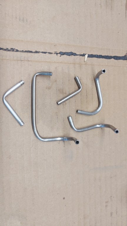

First order of business - bend up a new fuel line.
After the first few failed attempts - bending stainless isn't as easy as regular steel line.
Here's my set of rejects. :mad:
May 20th (1).jpg (45.51 KiB) Viewed 18193 times
But I finally got it bent up.
May 20th (2).jpg (42.68 KiB) Viewed 18193 times
And put back on the car.
Now to wait overnight to see if there will be any more seeping.
May 20th (3).jpg (82.37 KiB) Viewed 18193 times
May 20th (4).jpg (52.81 KiB) Viewed 18193 times
If there is I have a feeling it may be the master cylinder itself and not the fittings or line.... :shock:

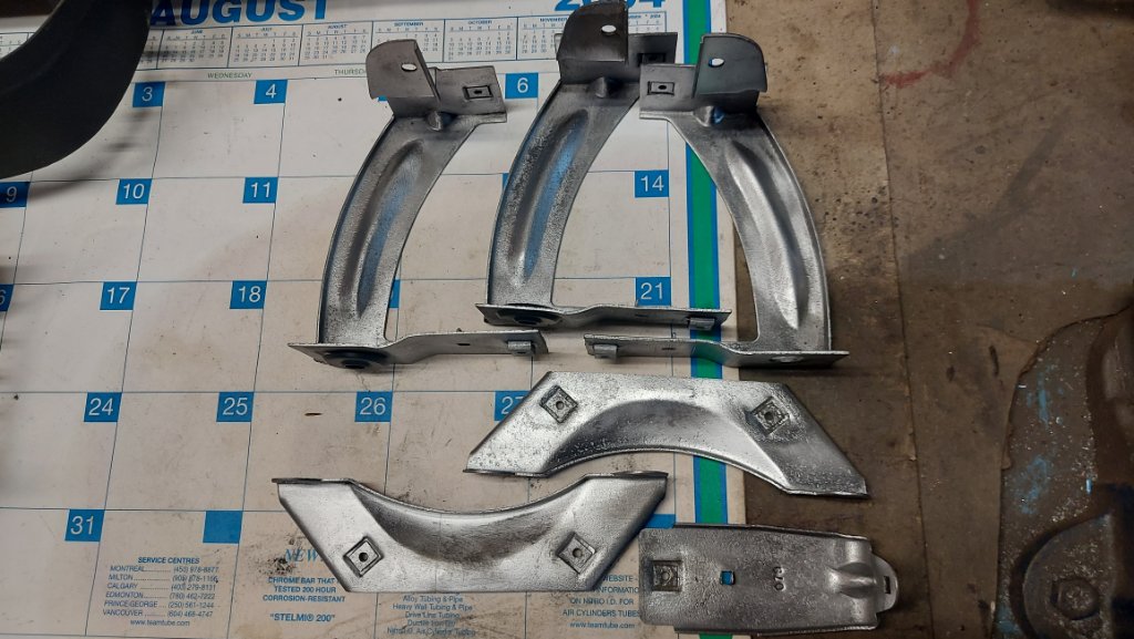

I had time to clean-up some parts yesterday.

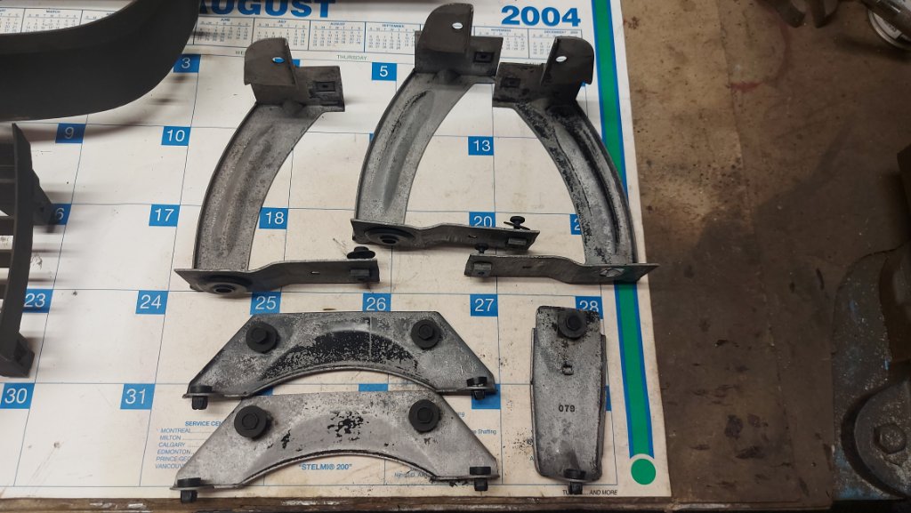

I had the grille brackets soaking in Evaporust for the last two weeks.
Here's what they look like rinsed off.
May 21st (7).jpg (112.25 KiB) Viewed 18178 times
Here's what they look like with a little cleanup with the fiber wheel.
May 21st (8).jpg (120.35 KiB) Viewed 18178 times

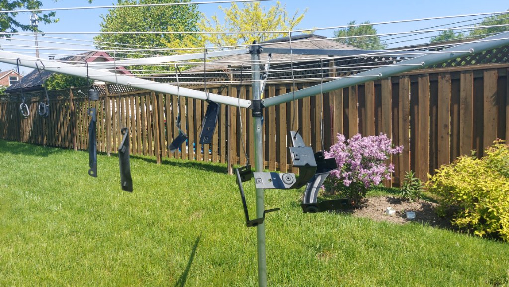

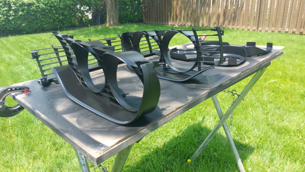

So today it was a good day to paint some parts outside....
Clothes lines are good for more than just hanging laundry to dry.... :D
May 21st (9).jpg (193.92 KiB) Viewed 18178 times
Also painted the grille.
May 21st (10).jpg (169.89 KiB) Viewed 18178 times

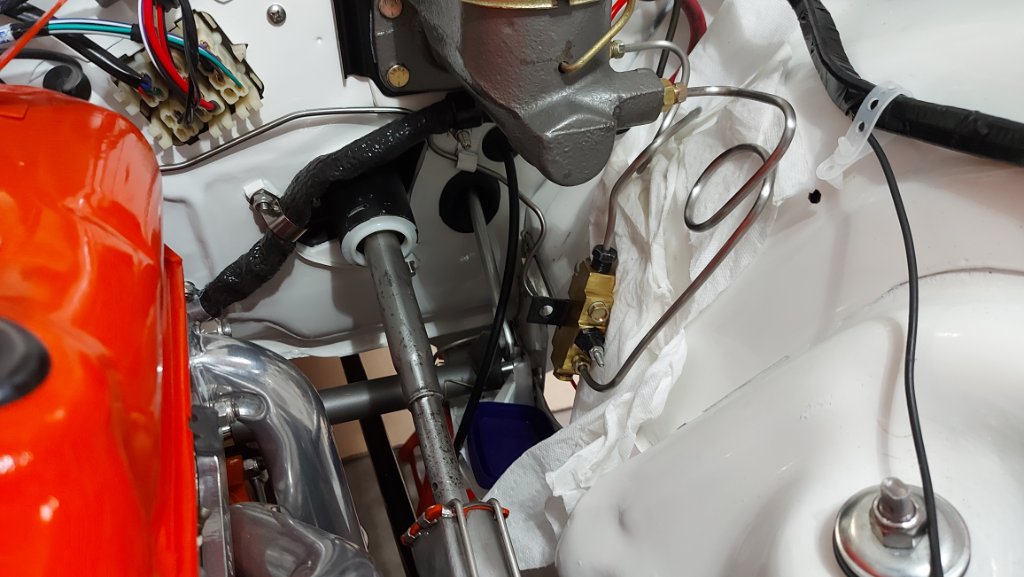

After that I went into the garage to see if the brake line was dry and it was!!! I call that a win.
But Murphy's law rears its ugly head as I thought to check the other fitting on the master and now it's seeping..... :mad: and it wasn't before this.
So, go out and buy the brass adapter and put it on.
A saving grace - I was able to re-use the brake line as there was enough straight section to remove the large fitting and put on a regular one.
Now at least they look the same....sort of.
May 21st (15).jpg (114.7 KiB) Viewed 18173 times
May 21st (14).jpg (102.3 KiB) Viewed 18173 times
Posts: 746
Post by 71Beeper » Sun Jun 02, 2024 3:17 pm
I'm happy to report that as of today there is no more seeping of brake fluid.
I'm cautiously calling that a win......Thank God.

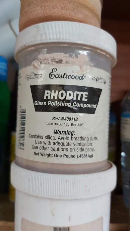

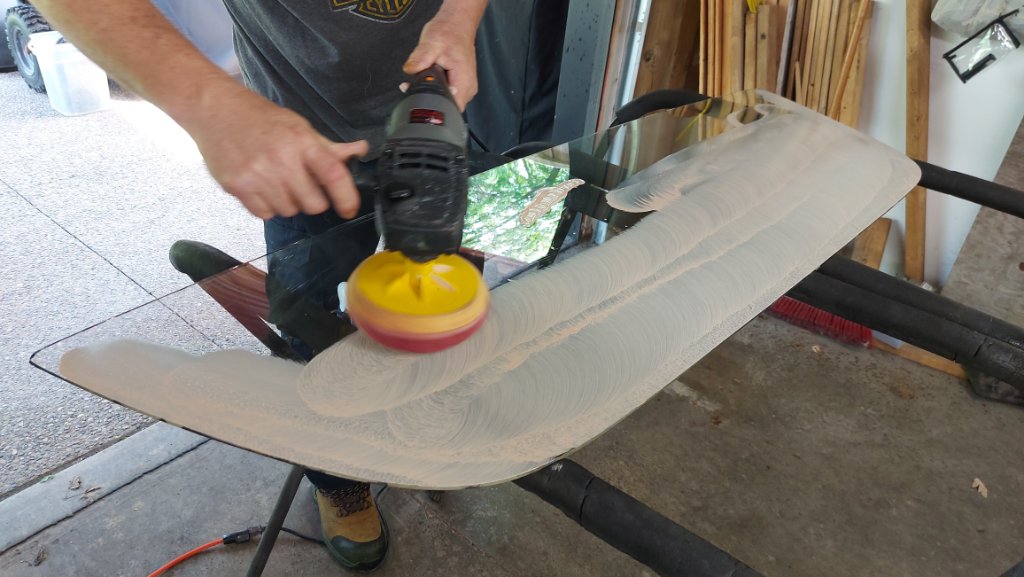

Moving on, my neighbor offered his services to try and polish the scratches out of the back glass.
So I took it over there and gave him a hand.
Using this stuff I've had around forever....
We followed the mixing directions and started polishing.
June 1st (2).jpg (84.11 KiB) Viewed 17994 times
Needless to say we both ended up wearing the slurry mix of polish.
June 1st.jpg (104.87 KiB) Viewed 17994 times
After 3 hours of polishing - did it remove the scratches? - no
Is it perfect? - no, but it is better.
The rest of the glass is clearer.

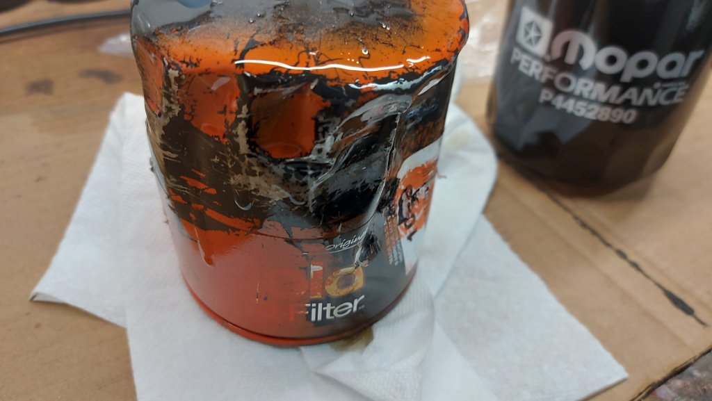

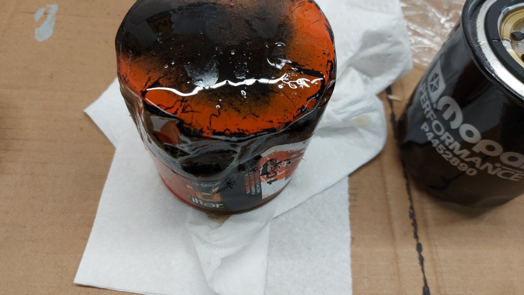

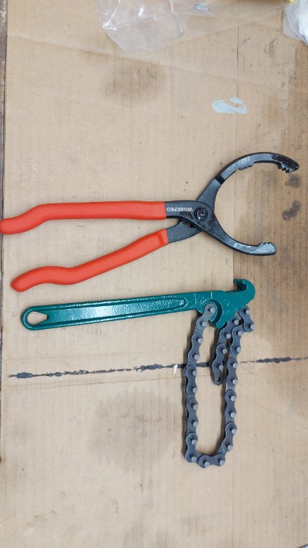

Todays job was to remove the full size oil filter and put on the shorter one to keep it away from the header.
Well after breaking my band type oil filter tool :mad: I ordered in some heavy duty ones to do the job.
June 1st (10).jpg (53.44 KiB) Viewed 17990 times
The channel lock style ended up doing the job.
But it wasn't pretty as the oil filter fought it well, but lost in the end.
June 1st (11).jpg (88.31 KiB) Viewed 17990 times
June 1st (12).jpg (78.65 KiB) Viewed 17990 times

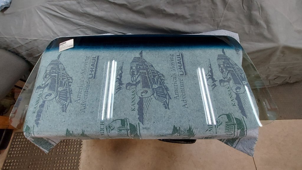

Next is to get the front windshield prepped and ready for install - I have a guy coming next week to do the job.
June 1st (13).jpg (120.41 KiB) Viewed 17990 times

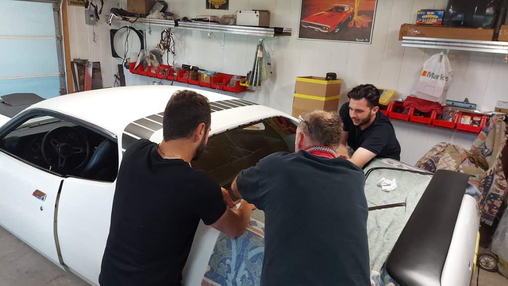

Post by 71Beeper » Thu Jun 06, 2024 8:04 pm

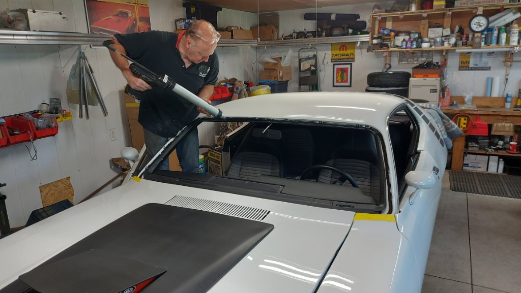

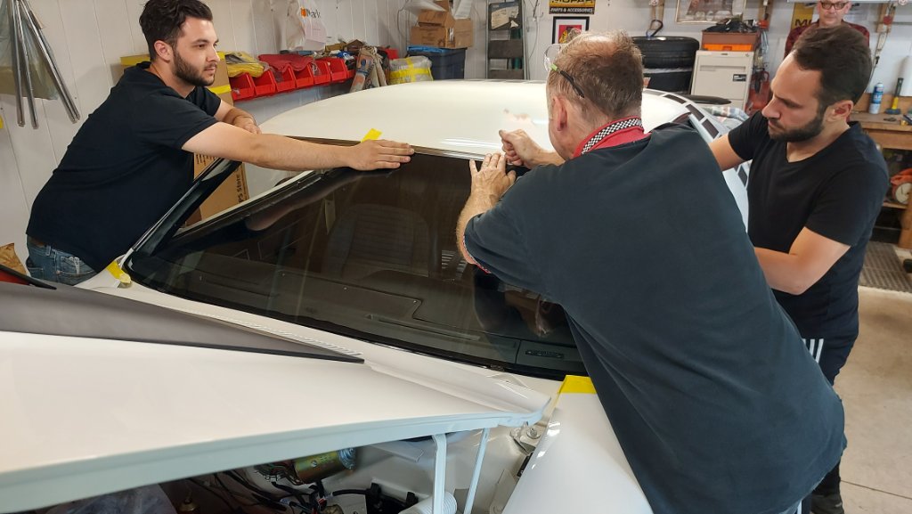

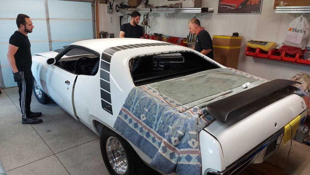

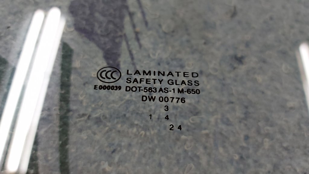

A couple of days ago I had these guys come in to install the front and back glass.
June 4th (1).jpg (102.77 KiB) Viewed 17894 times
Good guys that did a great job. :beer:
June 4th (3).jpg (111.08 KiB) Viewed 17894 times
June 4th (4).jpg (99.97 KiB) Viewed 17894 times
June 4th (5).jpg (94.37 KiB) Viewed 17894 times
June 4th (7).jpg (101.11 KiB) Viewed 17894 times

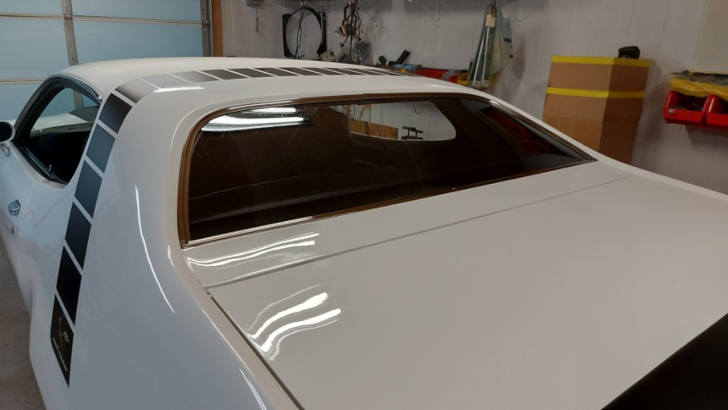

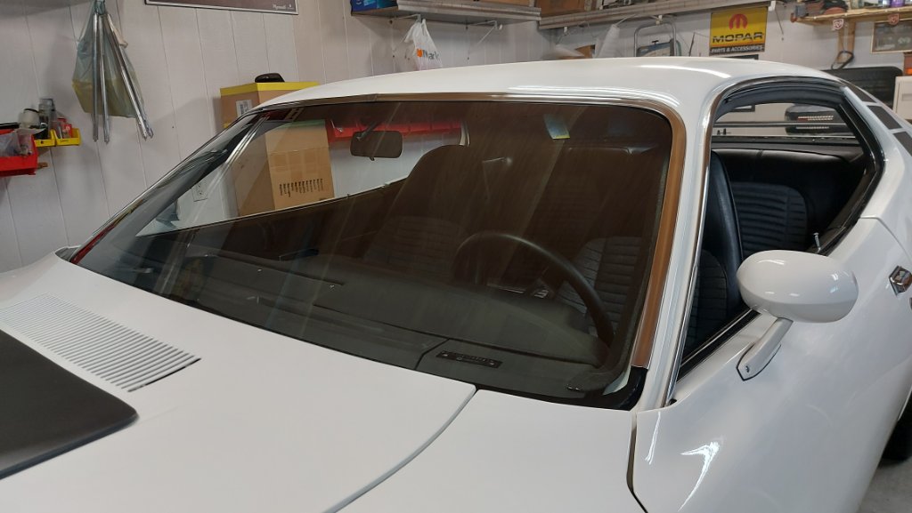

Post by 71Beeper » Thu Jun 06, 2024 8:06 pm

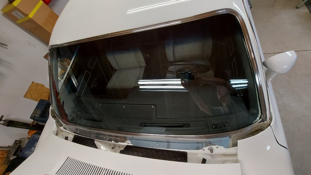

And they put the trim on as well.
Here she is finally with glass.
June 4th (11).jpg (78.34 KiB) Viewed 17894 times
June 4th (13).jpg (59.41 KiB) Viewed 17894 times
June 4th (10).jpg (106.63 KiB) Viewed 17894 times

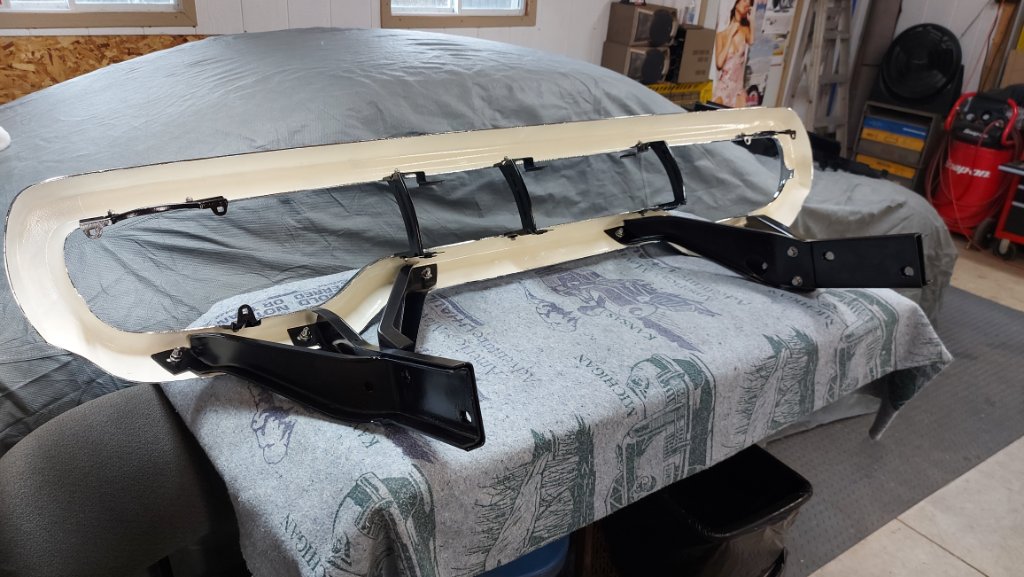

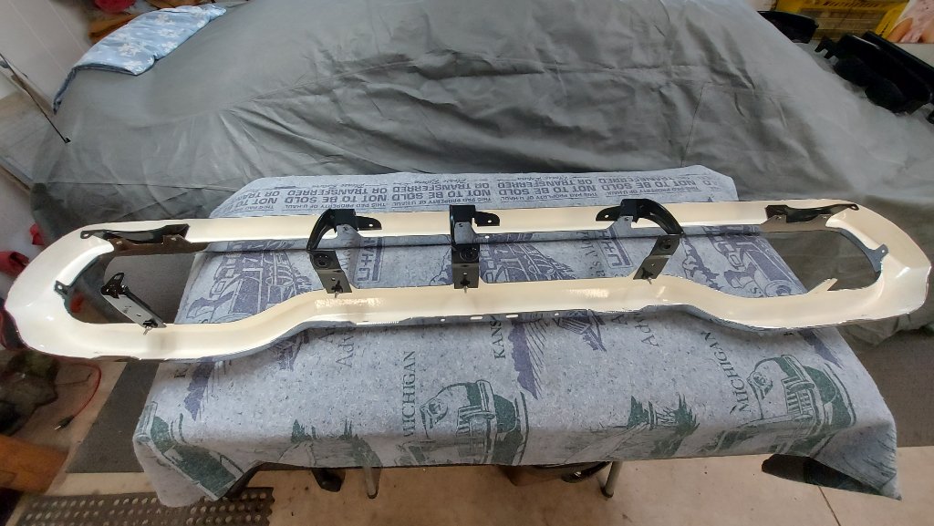

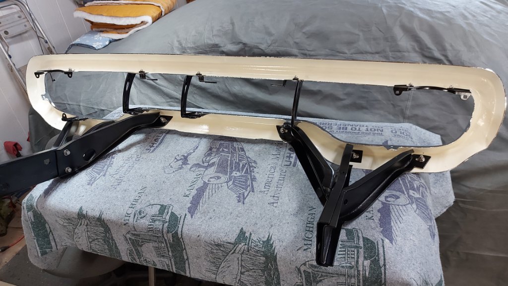

Moving on, it's time to get the front bumper assembly together.

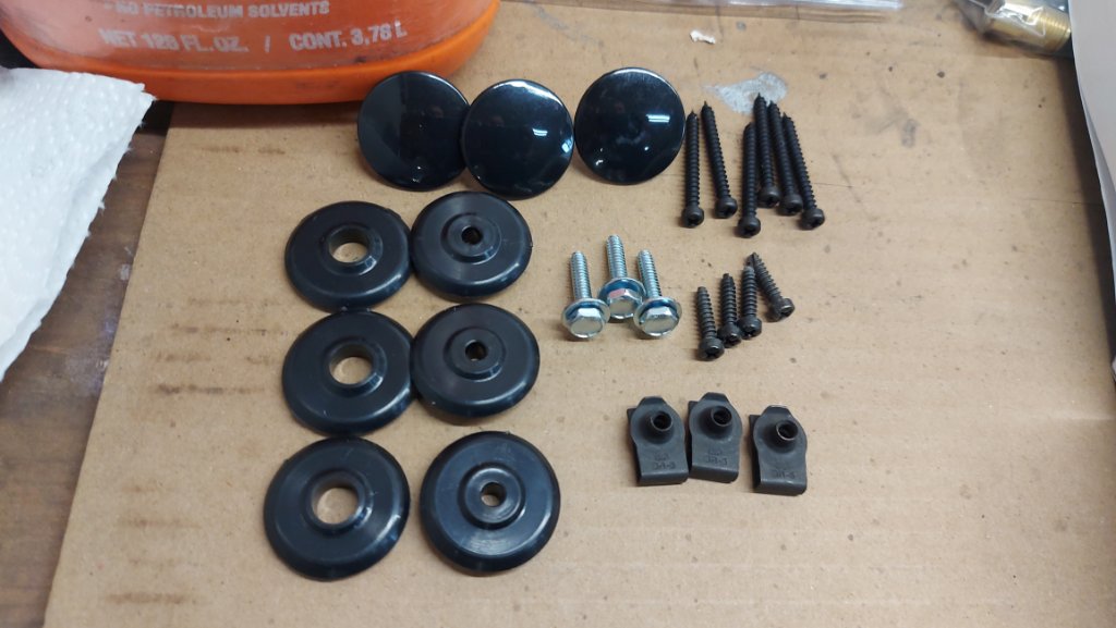

I have my grille mounting kit ready.
June 8th (1).jpg (88.53 KiB) Viewed 17813 times

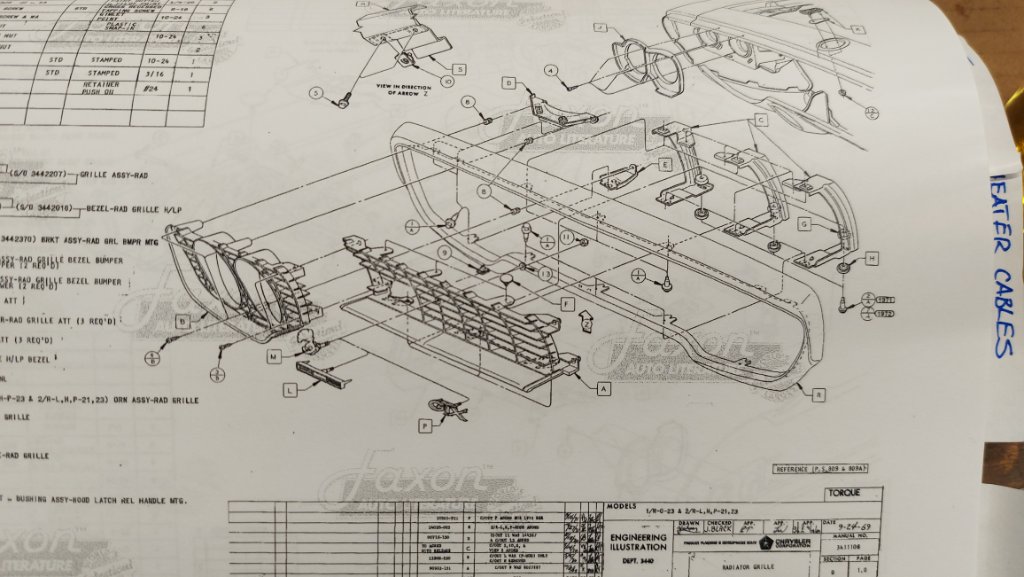

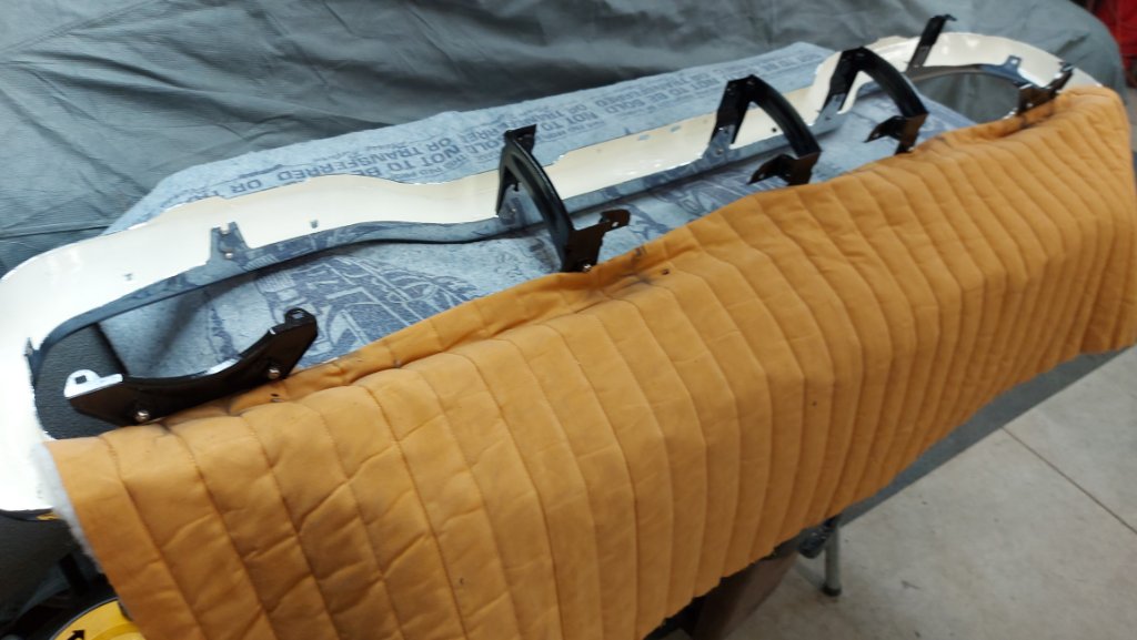

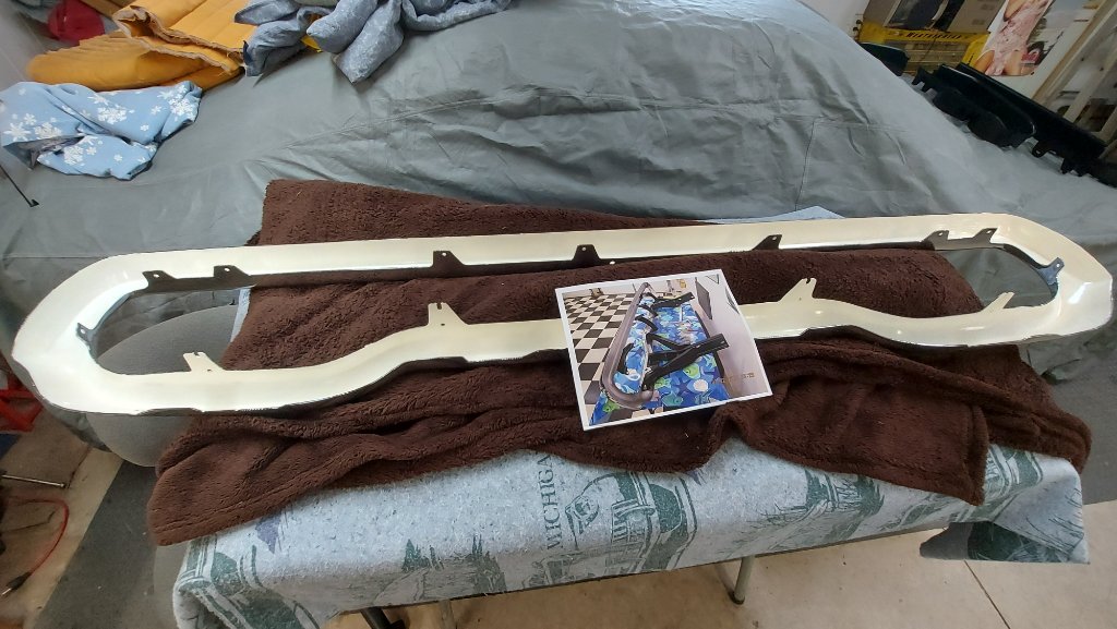

Next, get the bumper on the table and get some reference info ready.
June 8th (2).jpg (113.02 KiB) Viewed 17813 times
June 8th (3).jpg (130 KiB) Viewed 17813 times
June 8th (4).jpg (129.2 KiB) Viewed 17813 times

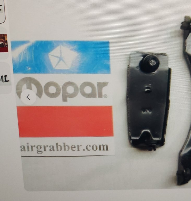

After taking an inventory of the grille support brackets, I find out that I'm one short.
I need one of these.
June 8th (5).jpg (57.85 KiB) Viewed 17813 times
If any of you guys have a spare one, please let me know.
Posts: 746
Post by 71Beeper » Sun Jun 09, 2024 1:44 pm
But I won't let that stop me.

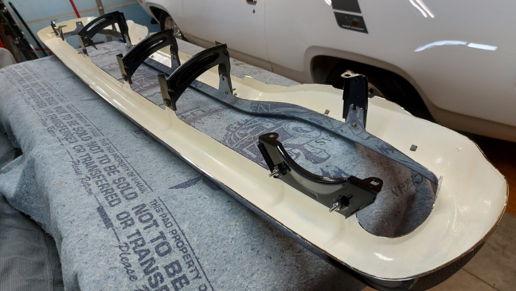

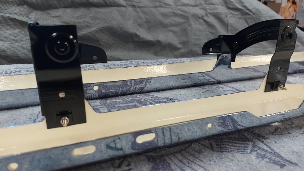

Lets get the existing brackets on the bumper.
June 8th (7).jpg (121.79 KiB) Viewed 17813 times
June 8th (8).jpg (125.54 KiB) Viewed 17813 times
June 8th (9).jpg (113.52 KiB) Viewed 17813 times
June 8th (13).jpg (70.96 KiB) Viewed 17813 times
June 8th (14).jpg (97.21 KiB) Viewed 17813 times

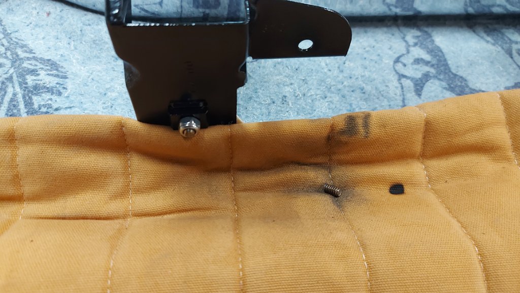

Post by 71Beeper » Sun Jun 09, 2024 1:46 pm

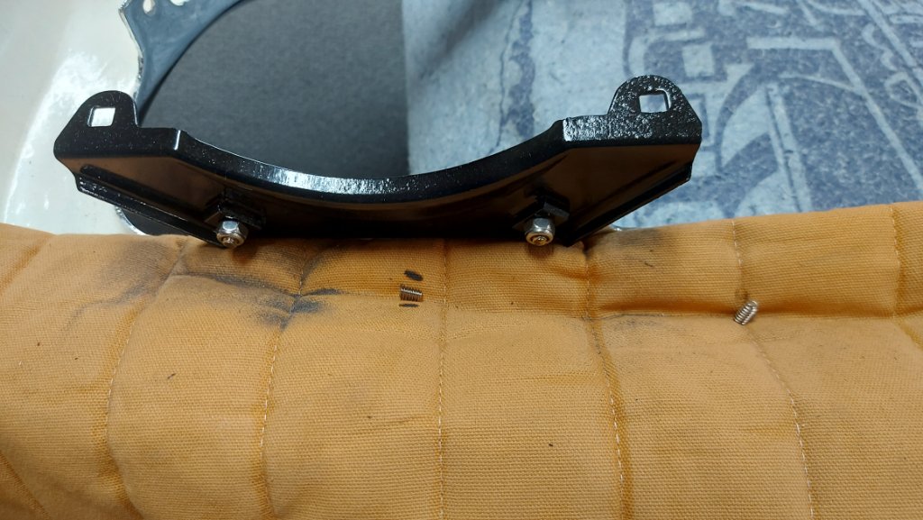

Since the stainless fasteners I used were a little too long, I used my trusty Dremel with a mini death wheel on it to shorten the fastener.
June 8th (16).jpg (85.87 KiB) Viewed 17813 times
June 8th (17).jpg (117.47 KiB) Viewed 17813 times
June 8th (18).jpg (116.24 KiB) Viewed 17813 times

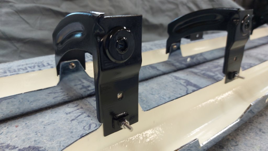

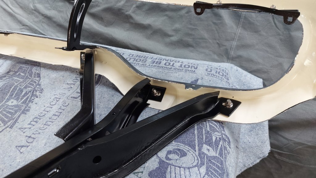

Post by 71Beeper » Sun Jun 09, 2024 1:48 pm

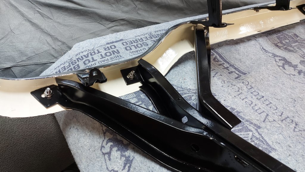

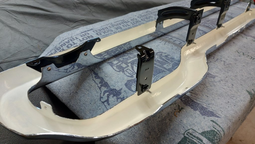

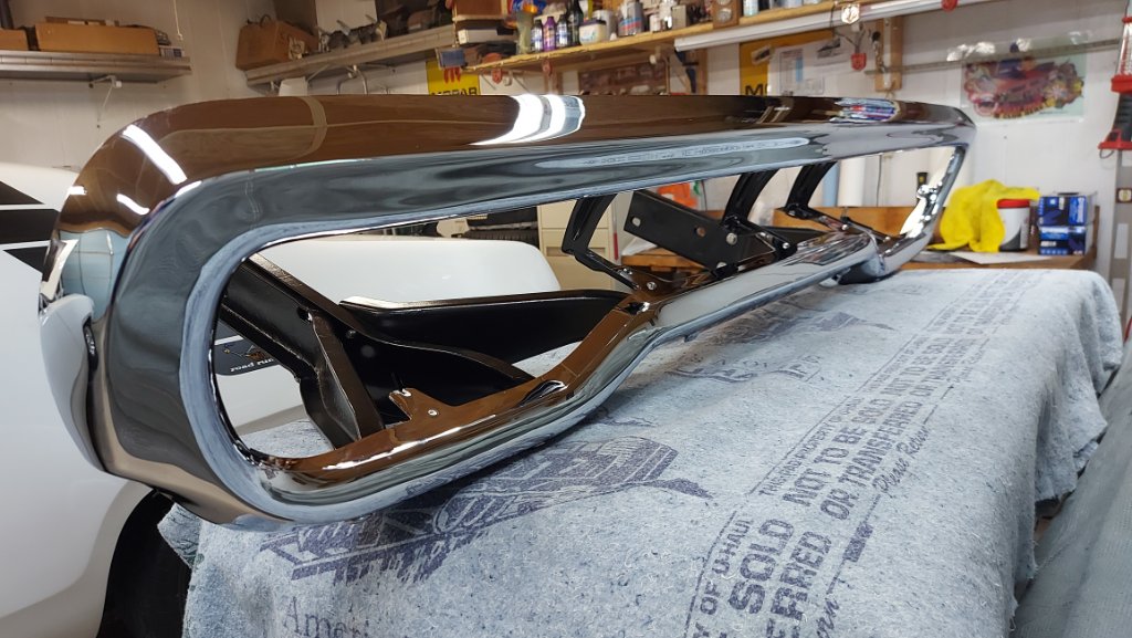

Next are the bumper brackets.
June 8th (20).jpg (120.53 KiB) Viewed 17813 times
June 8th (23).jpg (128.78 KiB) Viewed 17813 times
June 8th (21).jpg (147.69 KiB) Viewed 17813 times
June 8th (24).jpg (122.49 KiB) Viewed 17813 times
June 8th (26).jpg (135.26 KiB) Viewed 17813 times
Hopefully I'll be able to find the grille mounting bracket I need and get it put on before the whole assembly goes on the car.

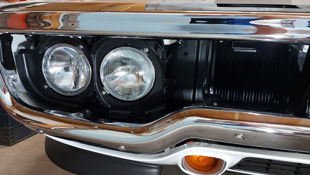

Post by 71Beeper » Sat Jun 22, 2024 7:18 pm

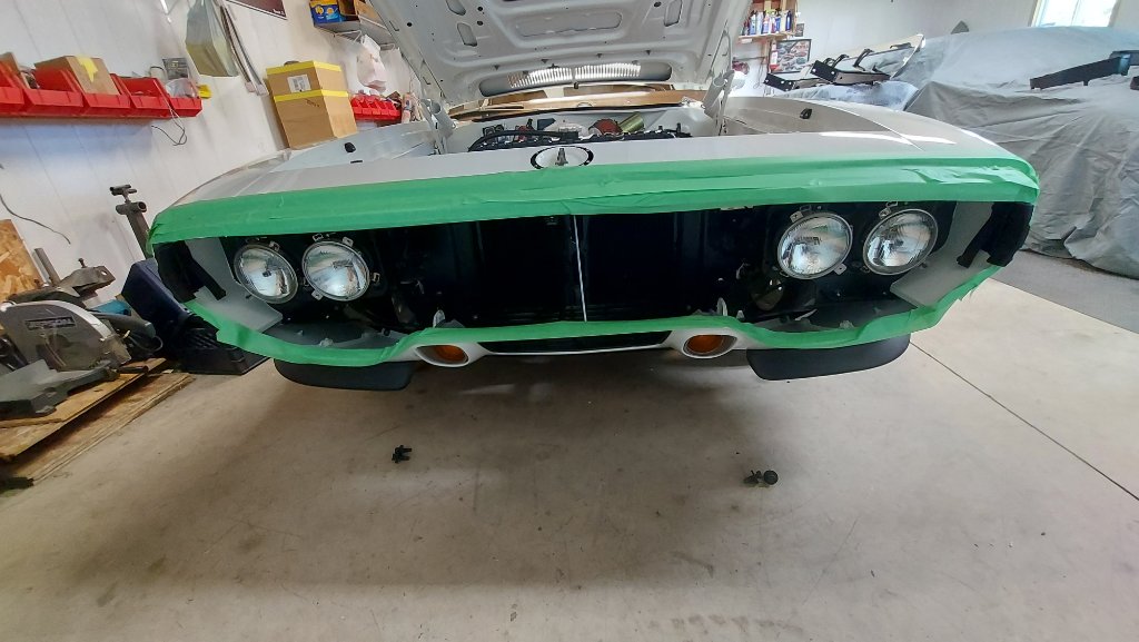

After being able to find the missing grille bracket piece locally, I cleaned it up and painted it and installed it on the bumper.
Now, lets prep the car to accept the bumer.
A bit of green tape so I don't scratch the paint.... :D
June 16th (1).jpg (103.65 KiB) Viewed 17549 times
Next, get it mounted and aligned.
June 22nd (5).jpg (115.98 KiB) Viewed 17549 times
Next, the headlight shields...
June 22nd (7).jpg (117.66 KiB) Viewed 17549 times
June 22nd (6).jpg (110.89 KiB) Viewed 17549 times

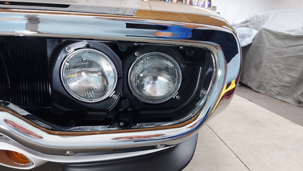

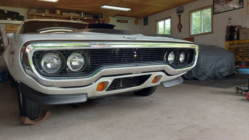

Lastly the grille pieces and Voila!!!
June 22nd (9).jpg (113.71 KiB) Viewed 17549 times
Posts: 746

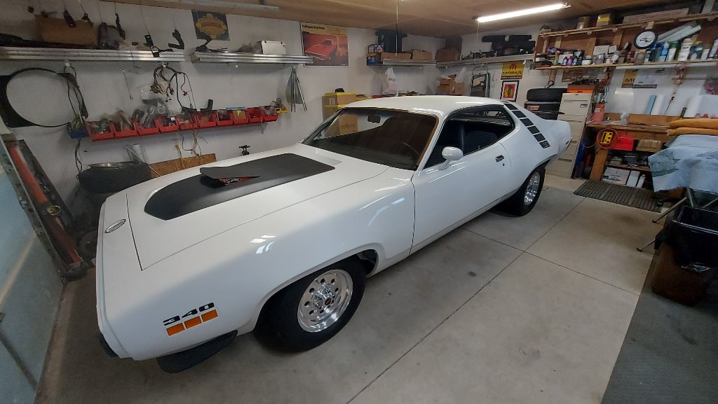

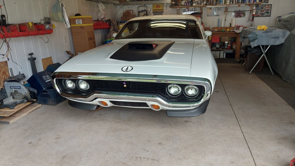

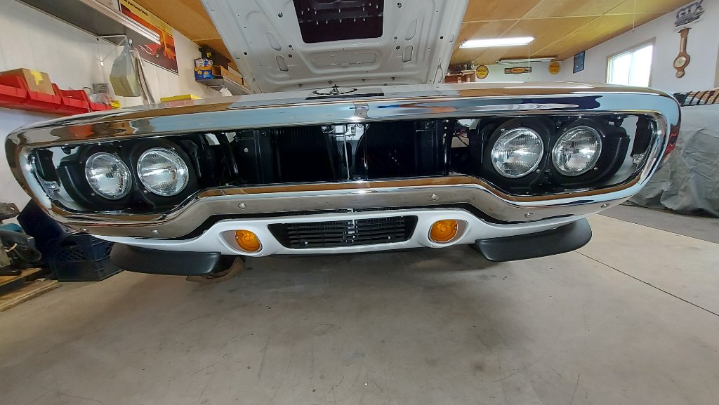

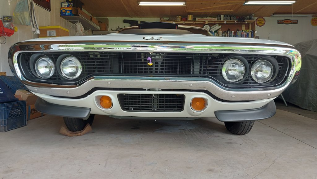

Post by 71Beeper » Sat Jun 22, 2024 7:22 pm
She finally has a face!!!
June 22nd (10).jpg (115.88 KiB) Viewed 17549 times
June 22nd (11).jpg (110.21 KiB) Viewed 17549 times
June 22nd (13).jpg (110.12 KiB) Viewed 17549 times
June 22nd (14).jpg (89.99 KiB) Viewed 17549 times
And with that being said I have now finished with the car!
Yes, I have a couple of little things to still put on the car, like the shoulder belts, but that will wait till its in winter storage.
