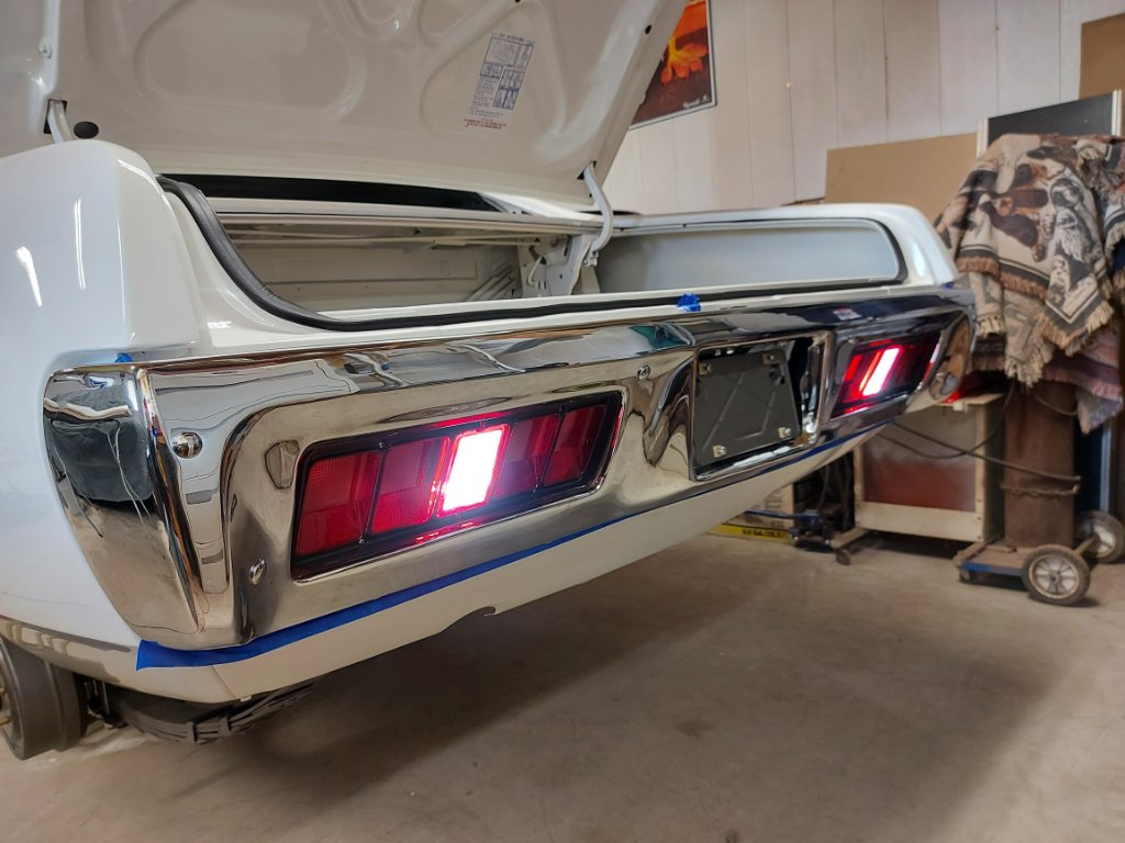

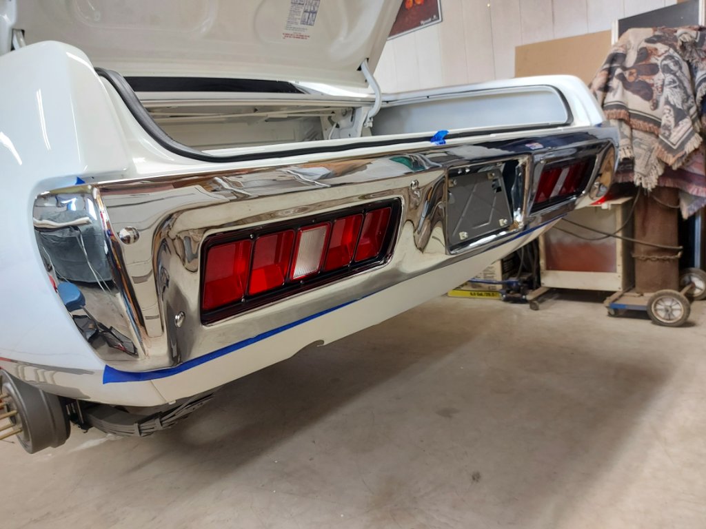

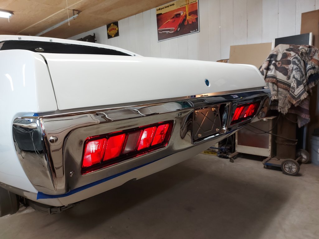

I did some pre installation taping...
May 2nd (3).jpg (90.56 KiB) Viewed 39650 times
Then with a little help from my two assistants.....
I was able to get the bumper on with no scratches anywhere!
May 2nd (5).jpg (115.13 KiB) Viewed 39650 times

And yes......as you can see the license plate light lighting up the underside of the edge of the trunk lid, I'm missing the small plate that goes there.
May 2nd (7).jpg (55.81 KiB) Viewed 39628 times
I had it when I took the car apart but do you think I can find it??? nope.... :mad:

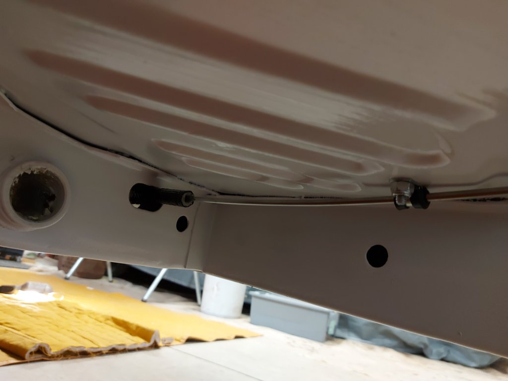

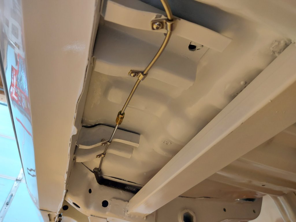

Finally got a chance to finish the front to back brake line.
Since my stainless lines are only 10 footers I have to use a coupling to join them.
No issues with doing that as I've done it this way in the past.

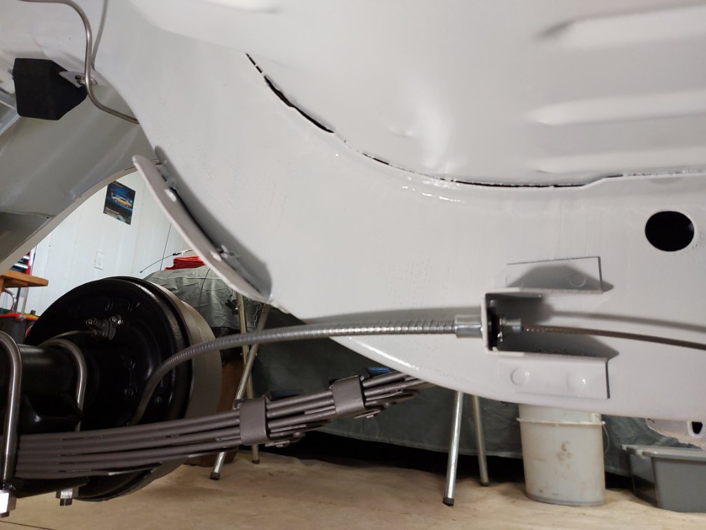

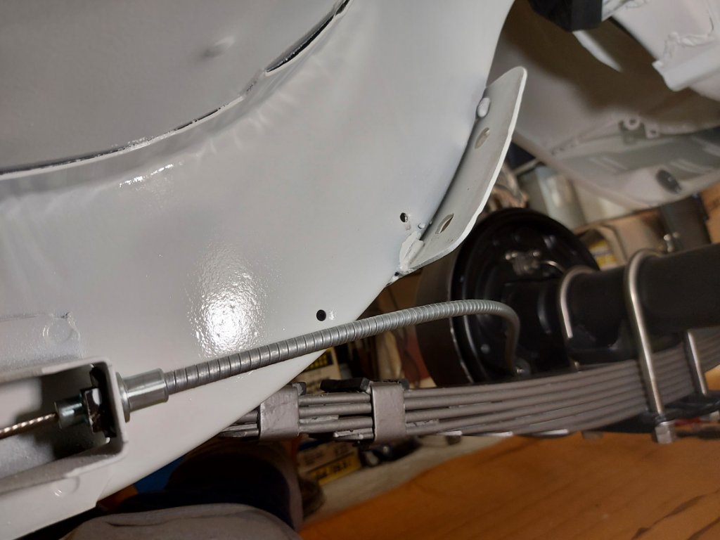

Also got a chance to install the rear portion of the parking brake cables.
I bought the stainless kit from Dante's and the kit shows up in a INLINE TUBE box, go figure.

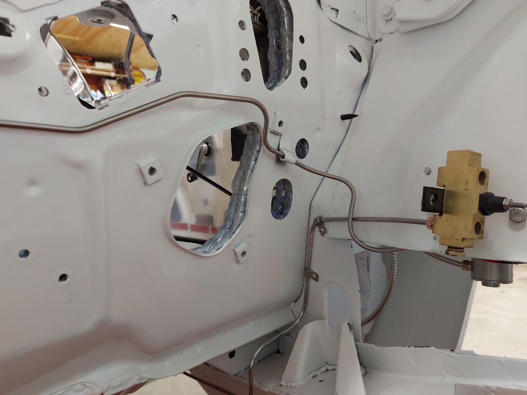

Posts: 746
Post by 71Beeper » Tue May 25, 2021 7:59 pm

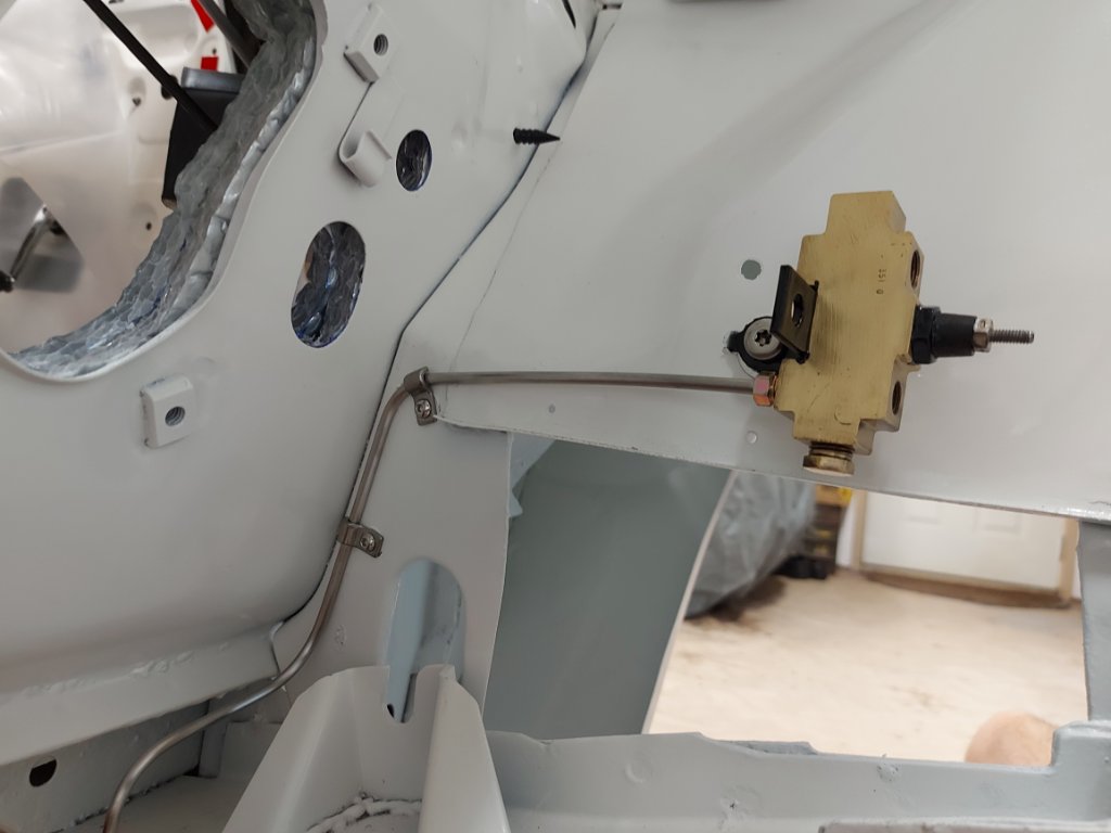

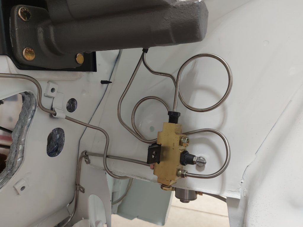

Got into mounting up the line-loc on the car.
I put it on the other side of the proportioning valve in the wheel well.
May 25 (4).jpg (55.69 KiB) Viewed 39496 times
I was able to tweak the passenger side brake line & have it fit nicely... :D

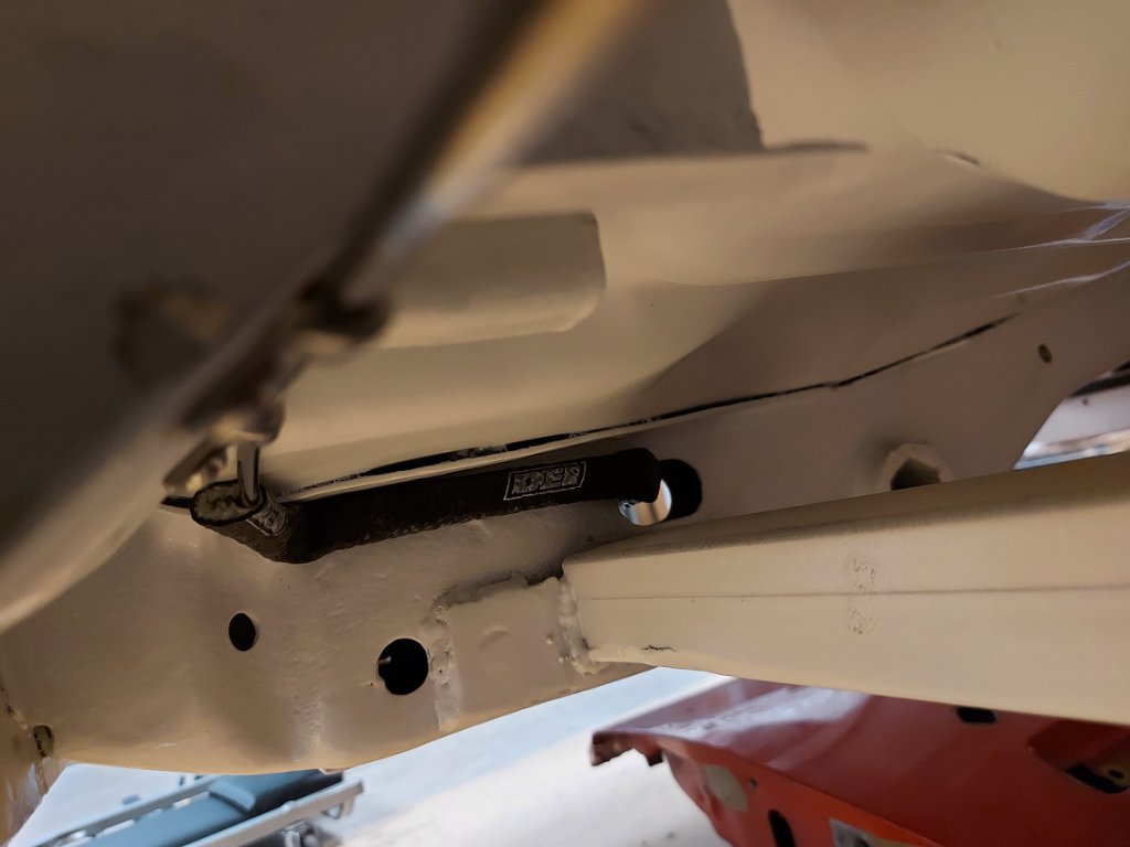

May 25 (5).jpg (72.67 KiB) Viewed 39496 times
I did have to make a new line for the drivers side as it is so short.
May 25 (11).jpg (58.76 KiB) Viewed 39496 times

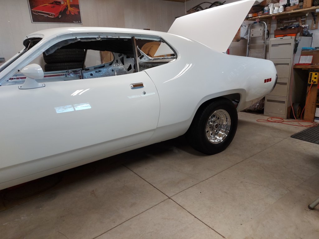

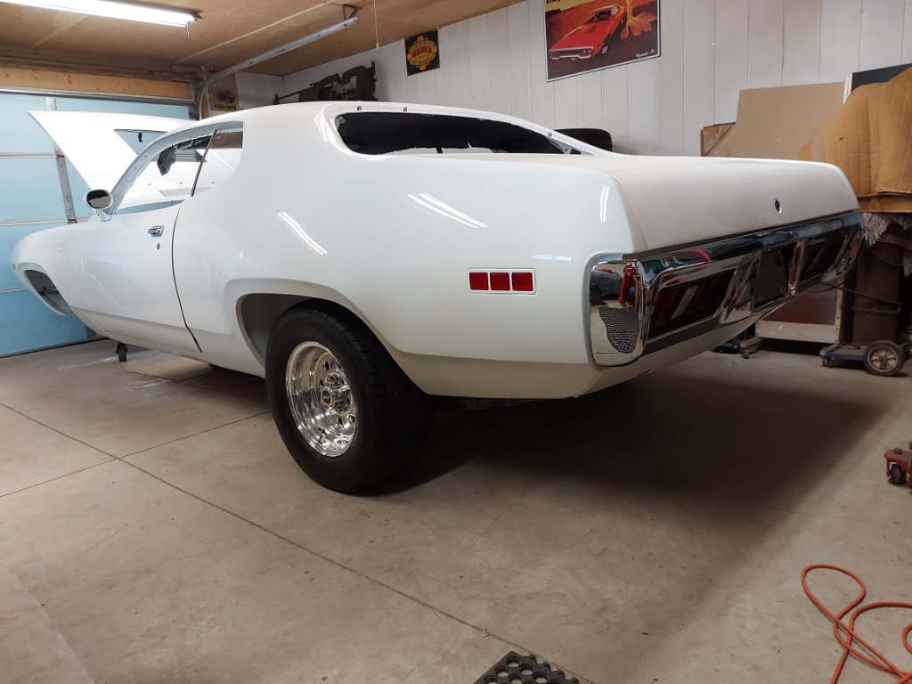

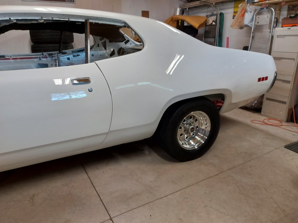

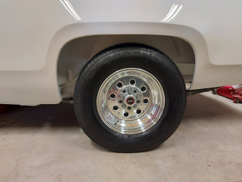

I was finally able to finish up the work on the rear end.
Got the shocks on and the parking brake cables hooked up.
Filled it full of fluid (along with sure-grip additive).
Polished up the Welds and put them on.
The car now sits on its rear tires.

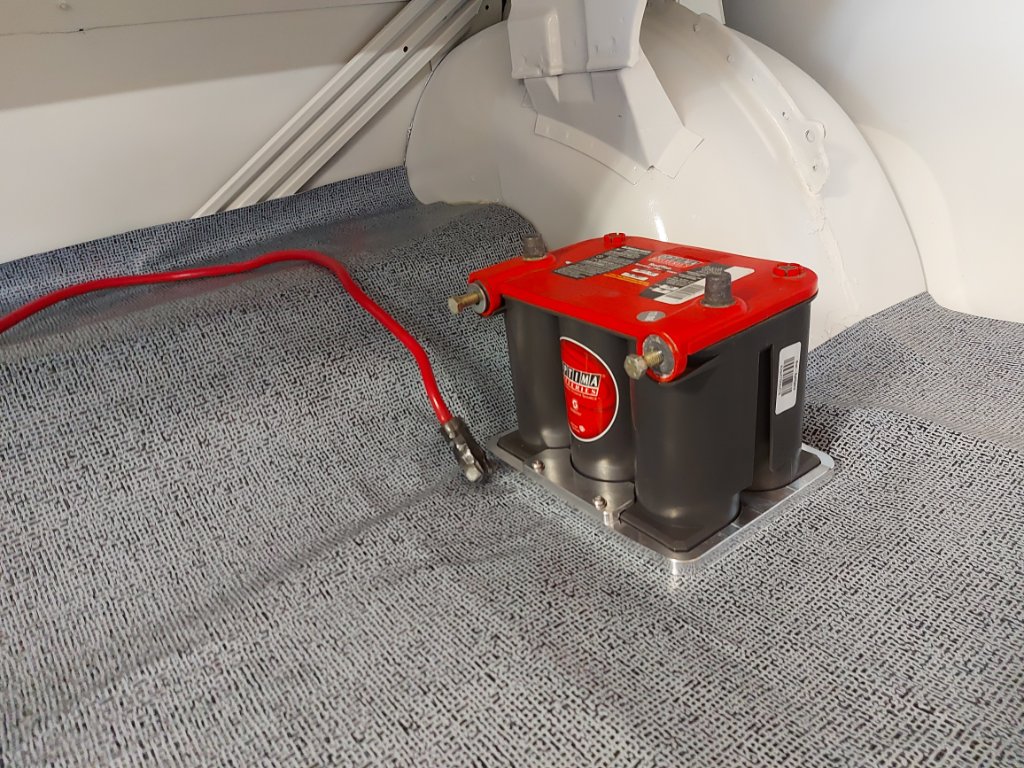

I finally got a chance to install the Optima battery tray in the trunk. I bought the car with a trunk mounted battery, so I stayed with the same concept.
June 13 (1).jpg (205.83 KiB) Viewed 39211 times

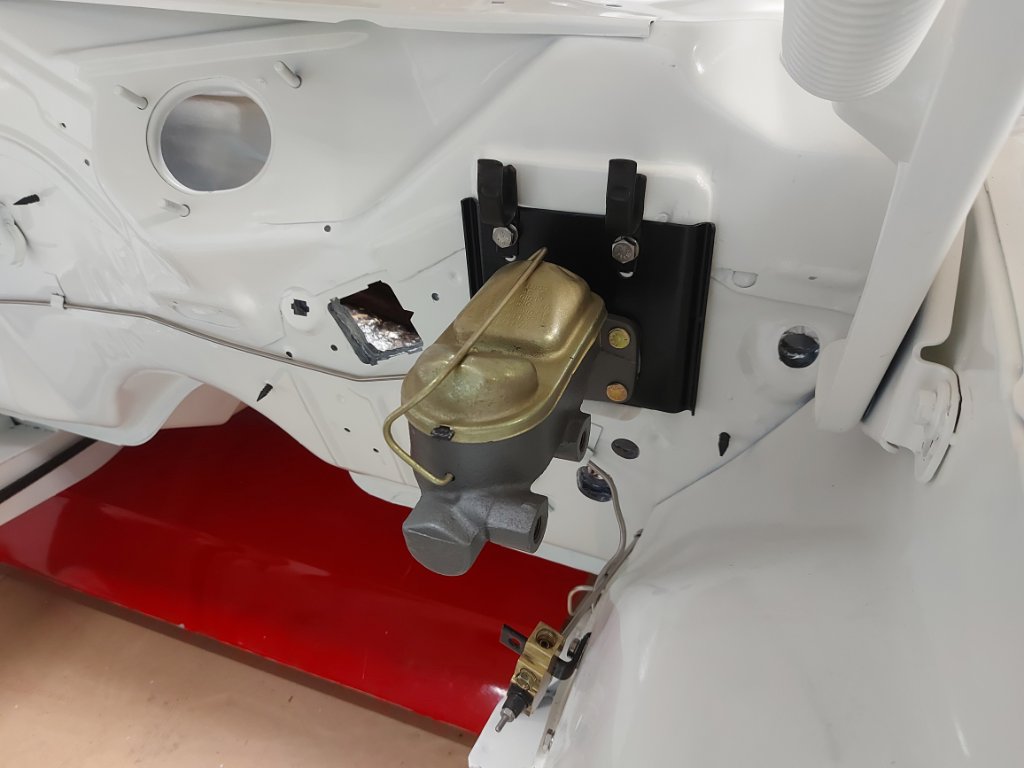

Also installed the master cylinder and the lines going to the proportioning valve.
June 19 (3).JPEG (69.66 KiB) Viewed 39211 times
June 19 (4).JPEG (70.82 KiB) Viewed 39211 times

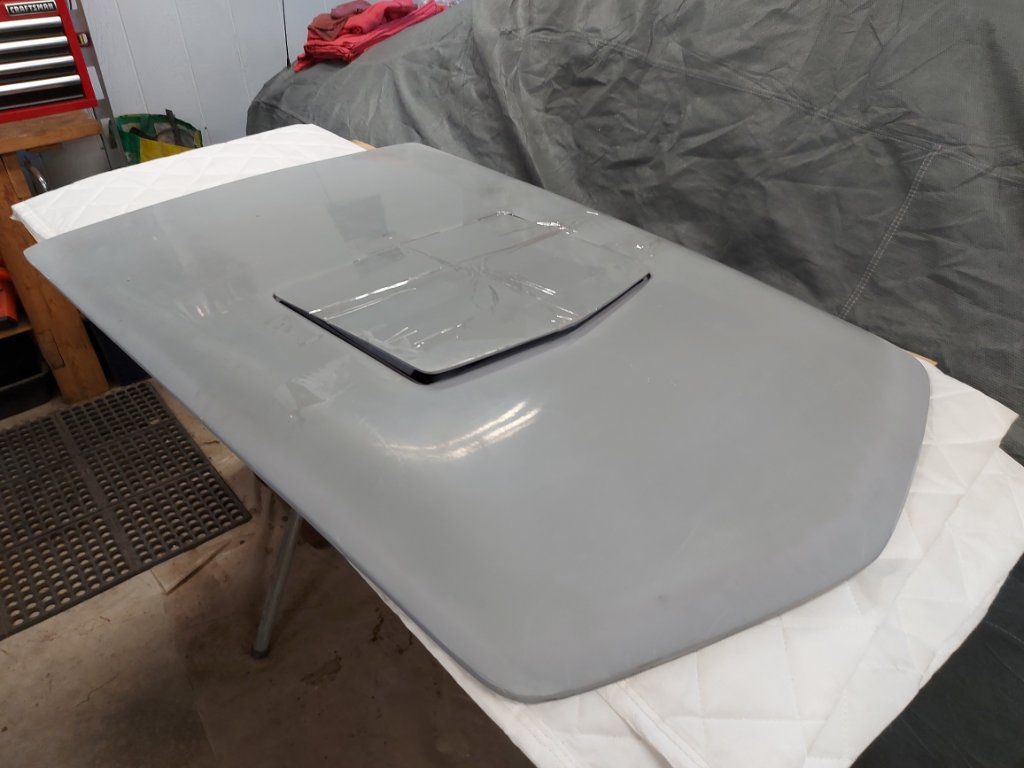

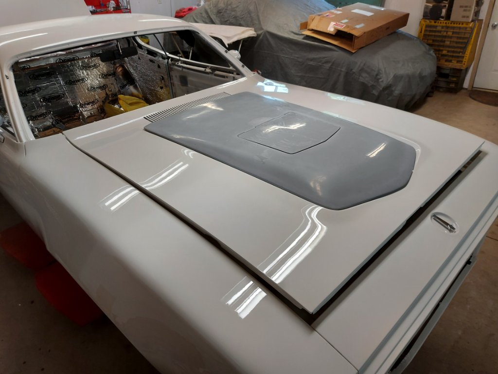

Now it's time to start prepping the Air Grabber setup.
June 19 (7).JPEG (80.89 KiB) Viewed 39211 times
June 19 (10).JPEG (98.84 KiB) Viewed 39211 times

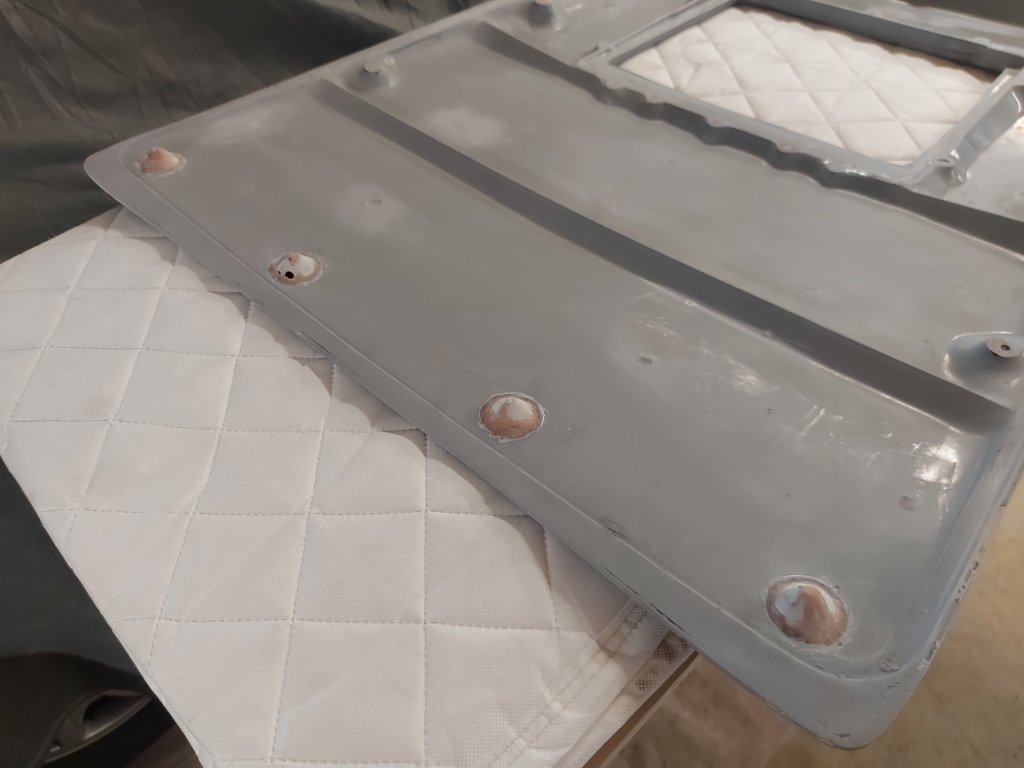

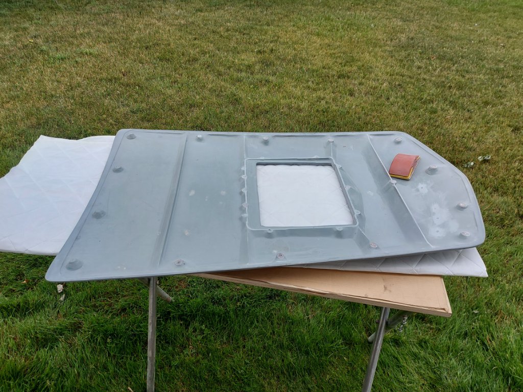

Started cleaning up the underside of the Air Grabber setup.
Not the cleanest under there - I sanded all of the mounting bosses so the tops are flat for when the threaded fasteners go on them.
Other little bits of gooped fiberglass to remove as well... :shock:
I do have some sanding to do on the 4 tapered bosses at the back.
June 26.jpg (206.25 KiB) Viewed 39108 times

Mmmm-mmmm. Shiny new parts going on! Is that the Stinger Air Grabber set up?
Posts: 746
Post by 71Beeper » Mon Jul 05, 2021 8:41 pm
Yes Scott, it is the Stinger set-up....... :mad:

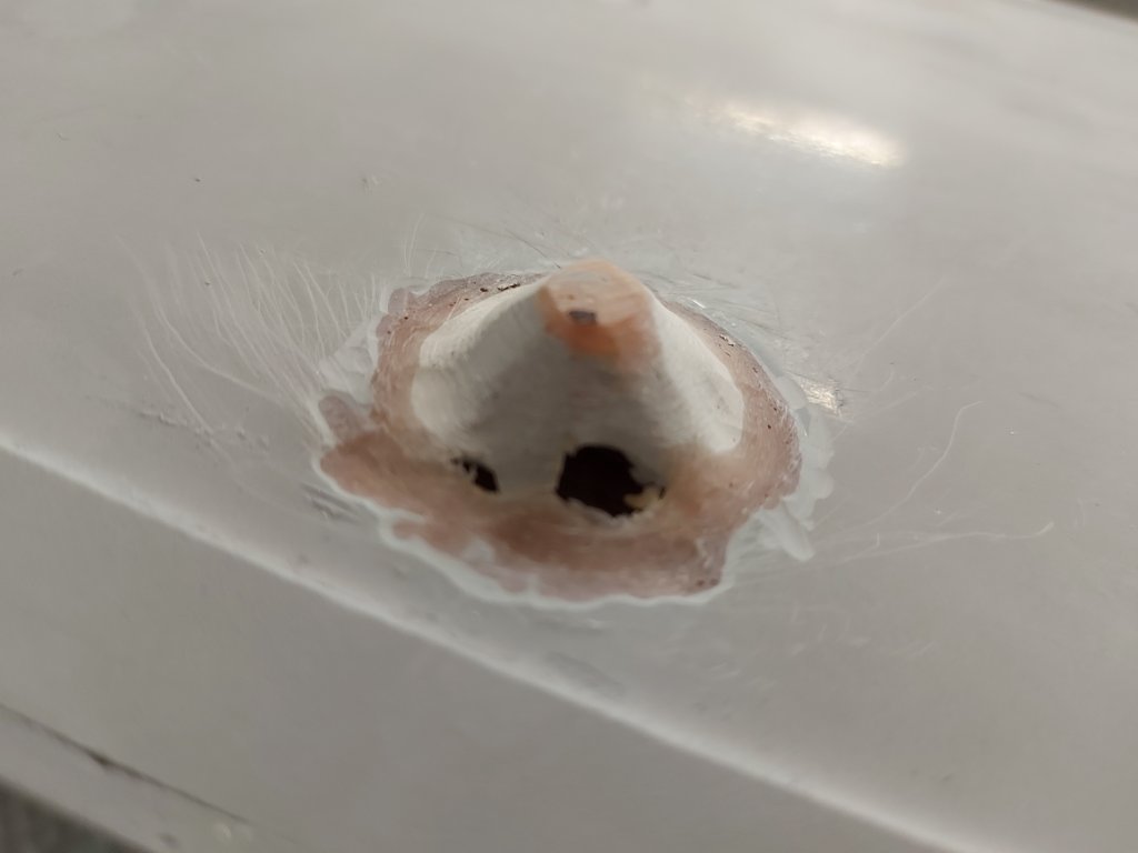

I ran into a snag.
The Stinger set-up does need some work...it is not just out of the box ready. I had to sand some of the imperfections on the underside.
The rear 4 cones on the underside also needed some clean-up.
July 4th (1).jpg (66.77 KiB) Viewed 38973 times
So as I was cleaning them up this happened... :shock:
July 4th (2).jpg (38.07 KiB) Viewed 38973 times
I wasn't too happy on how thin the cones actually are - I was hoping they would have been solid.
Anyway, I thought I was screwed, so I started to figure out a way to make something work.
So this is what I thought up.....I went to Lowes and bought these.
July 4th (4).jpg (42.52 KiB) Viewed 38973 times
#10-24 fender washer, #10-24 x 1 1/2" long stainless machine screw & #10-24 furniture base flange.
The idea is to have a stud coming thru so the bell-nut can attach to it.....but how to attach it?
Here's how....
July 4th (8).jpg (104.88 KiB) Viewed 38973 times
Good ol JB weld for fiberglass.
