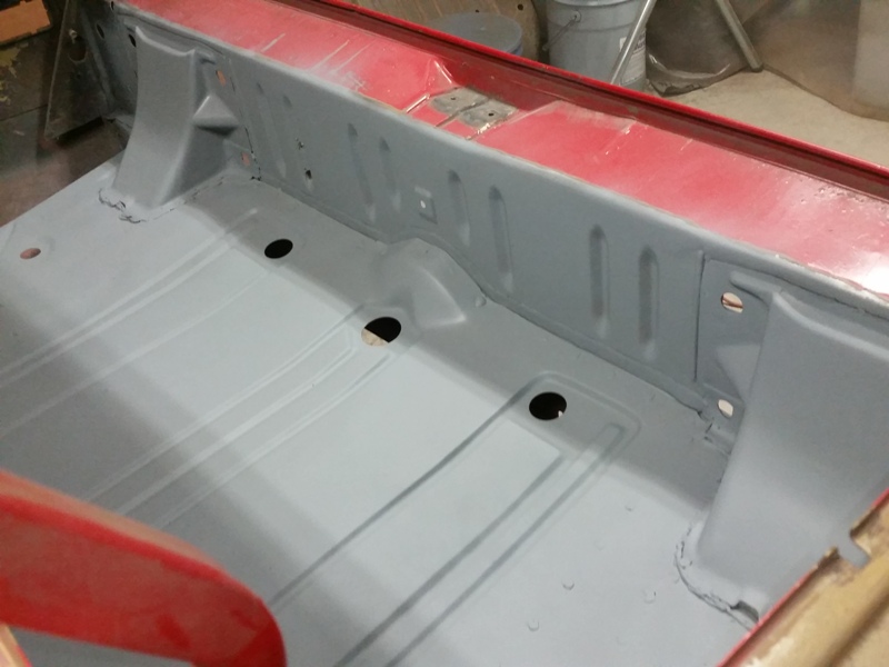

Post by 71Beeper » Wed Sep 20, 2017 8:23 pm

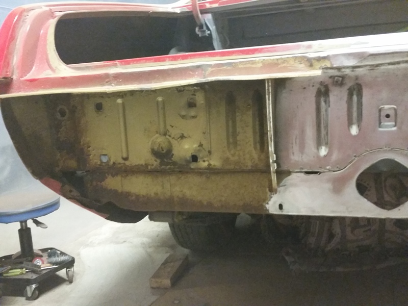

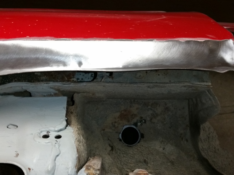

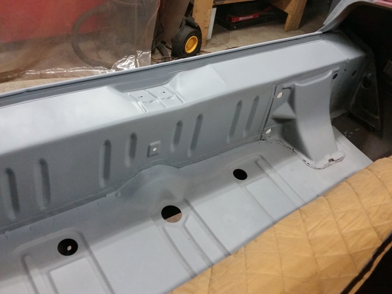

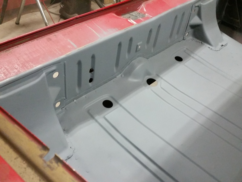

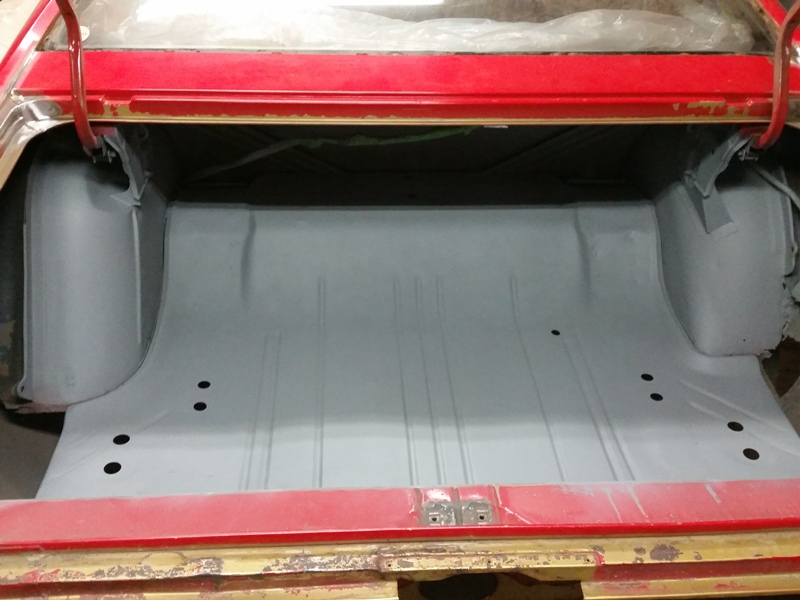

Soooo - moving on. Did some prepping and put down some primer on the new trunk pan.

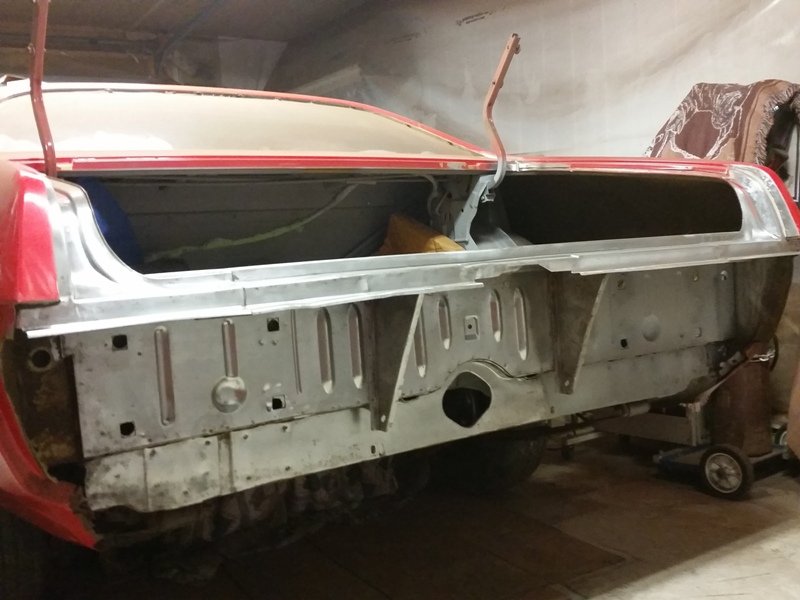

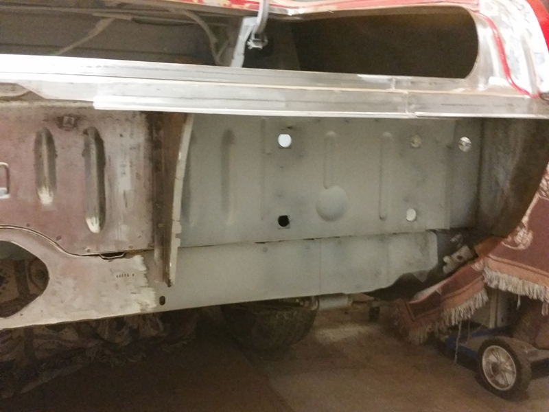

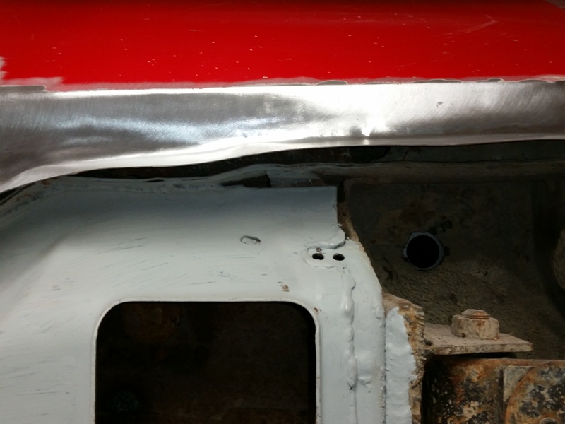

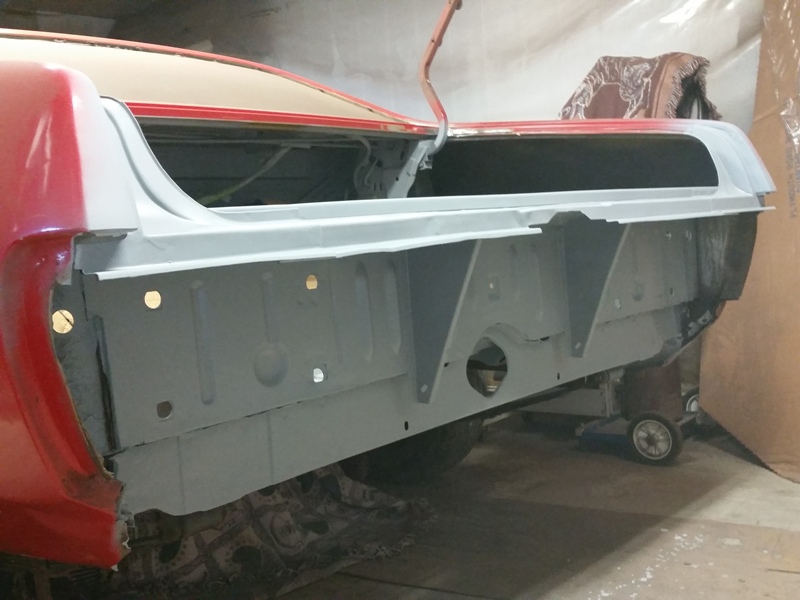

So now it's time to tackle the rear panel. Here's the drivers side not touched while the center area where the gas tank neck sticks thru was cleaned up.
Here's the passenger side with a light coat of primer on it.
Posts: 732
Post by 71Beeper » Wed Sep 20, 2017 8:29 pm

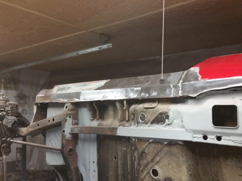

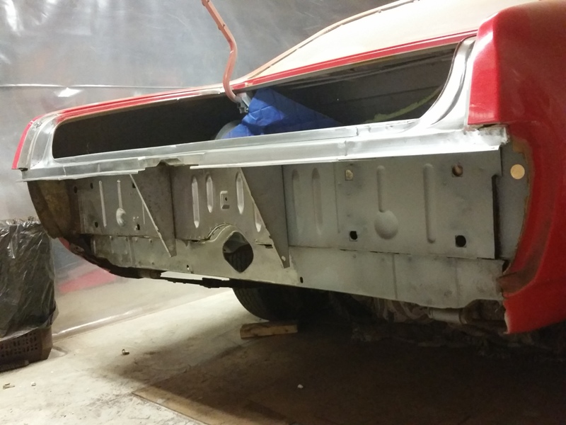

Here's some of the top where the trunk latch goes.
Here's some more of the cleaned up area's.
Even more pics.
Now it's time for some primer......

Post by 71Beeper » Sun Oct 01, 2017 7:46 pm

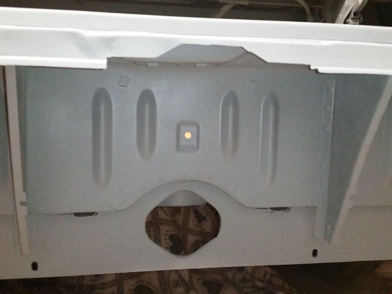

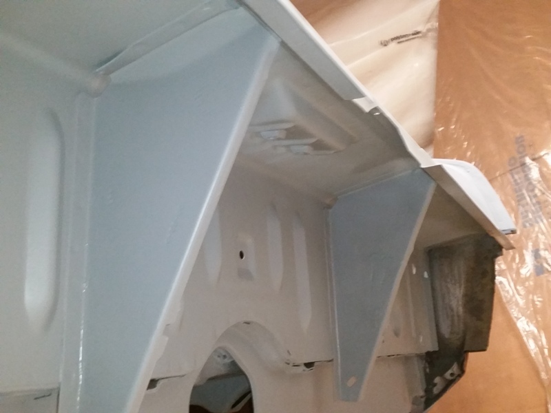

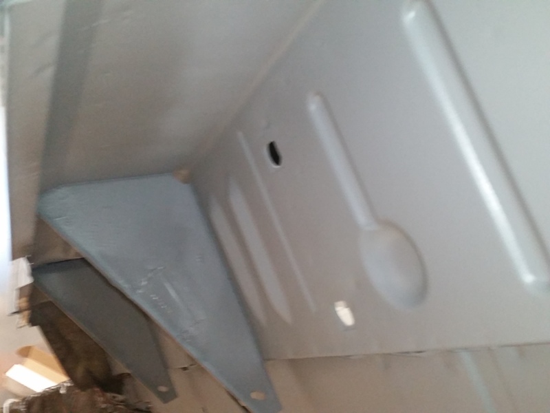

So I finally got some primer on the whole back panel.
I made sure I got primer on the underside too.
And I finished up the top panel.
Some more pics.
So the next thing to do is get her on her side to clean up and finish the underside.

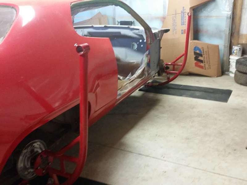

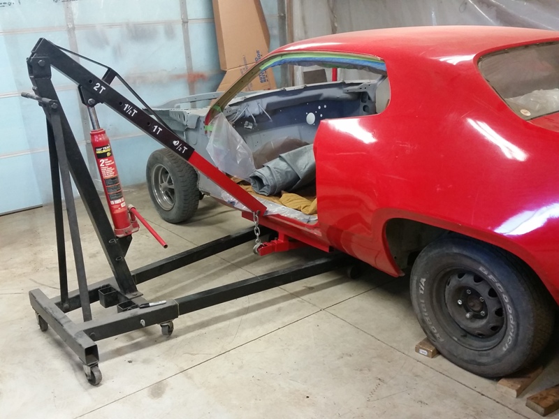

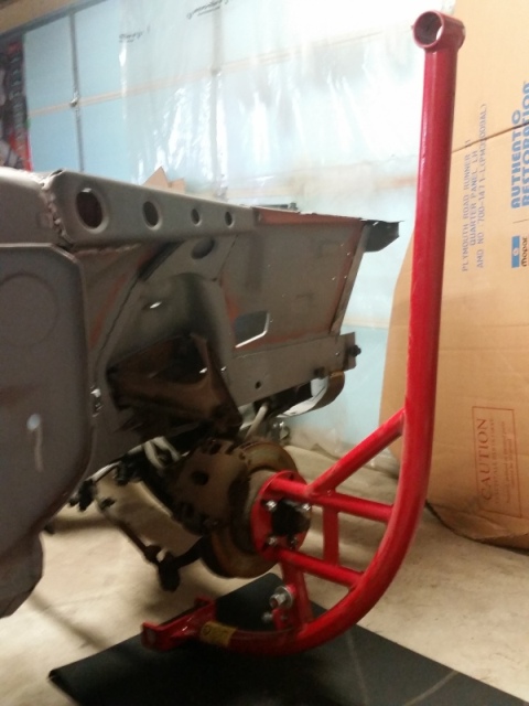

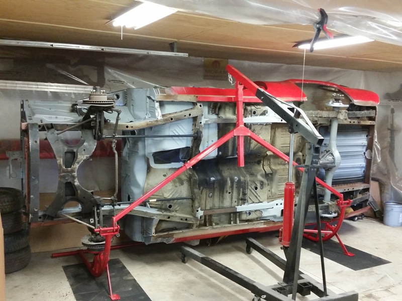

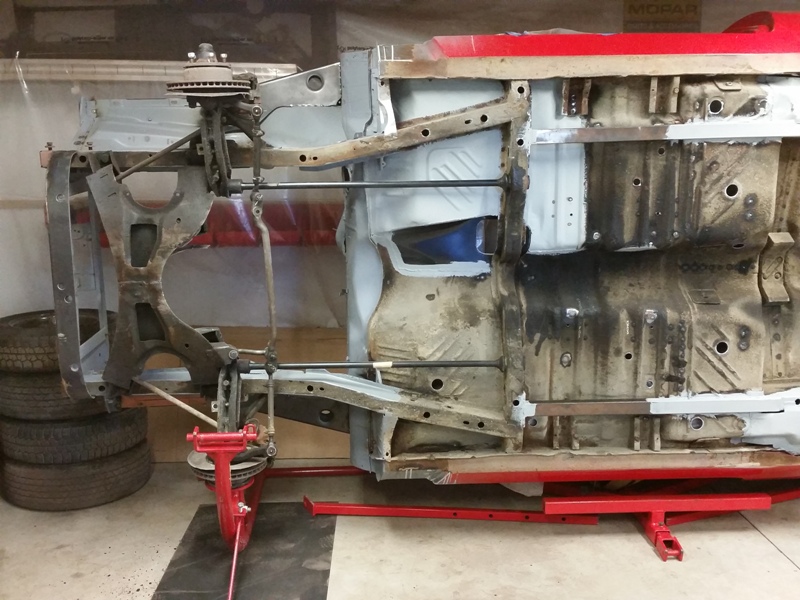

So I finally was able to set-up the rotisserie and mount it to the car.

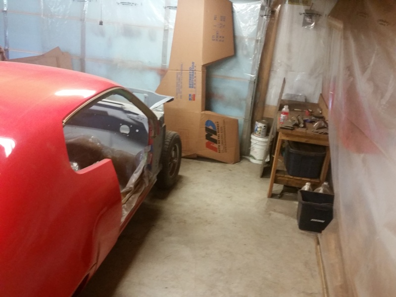

First, to make sure there is enough room away from the wall.

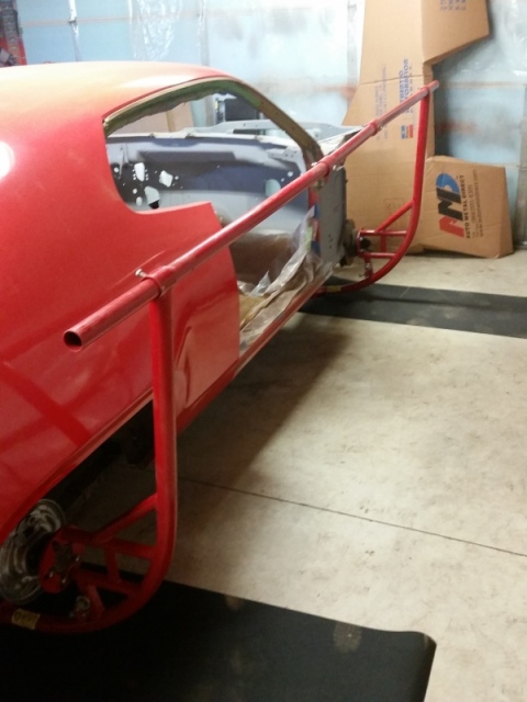

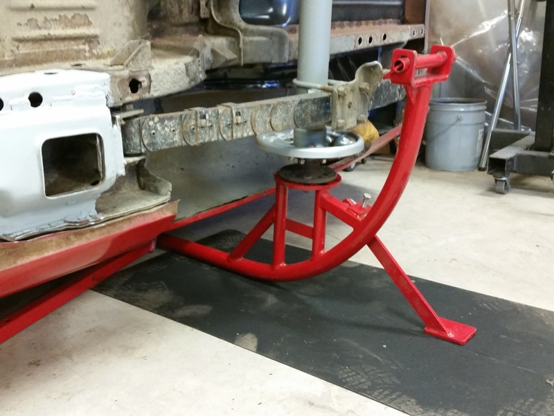

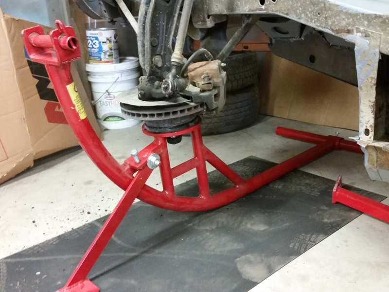

So, this specific rotisserie mounts to the wheel hubs. Here's the front wheel mount.
and here's the rear mount.
Then there's a tie bar that holds them together.

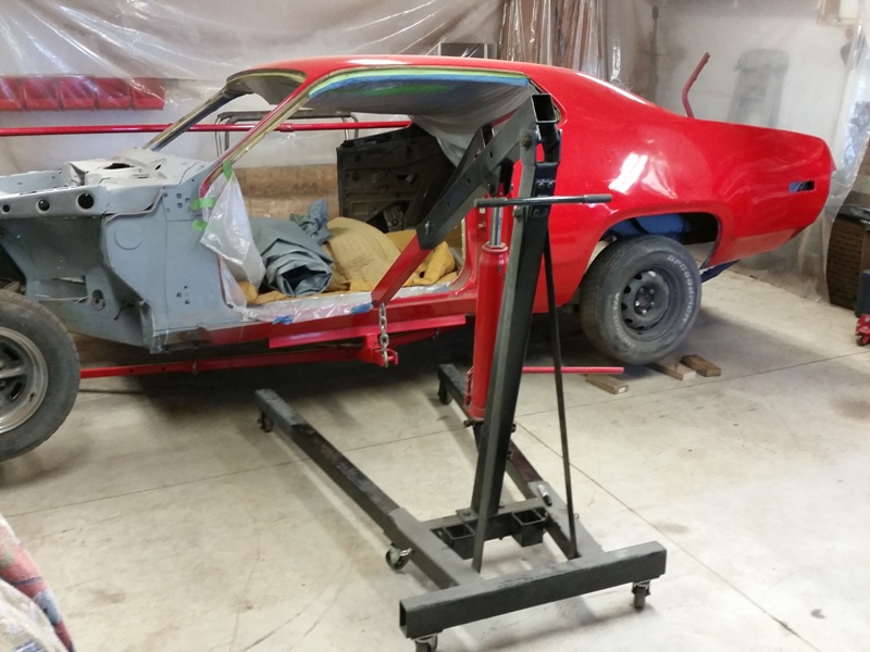

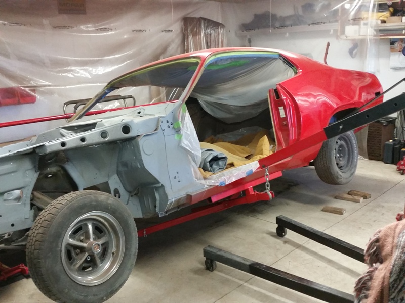

Then from the other side there is a draw bar attachment that attaches to the 2 mounts that you will see in later pictures. Going to the other side of the car, i hook the draw bar attachment to the engine hoist.
Posts: 732
Post by 71Beeper » Mon Oct 09, 2017 2:45 pm
So making sure all connections are tight, I now start to lift.
Next is to pull the rims from the drivers side to keep the weight off the lifted side.
Then just keep lifting (you can now start to see the draw bar attachment)

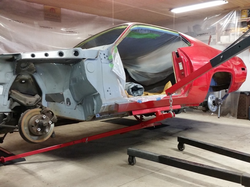

I had to make sure there was enough ceiling clearance - which is why I chose this type of rotisserie over the conventional kind as I only have an 8 ft. ceiling in my garage.
Then i just kept lifting till she was right on her side.
Posts: 732
Post by 71Beeper » Mon Oct 09, 2017 2:50 pm
The final step is to secure the steady brackets - here's the front one.
and here's the rear one.

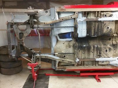

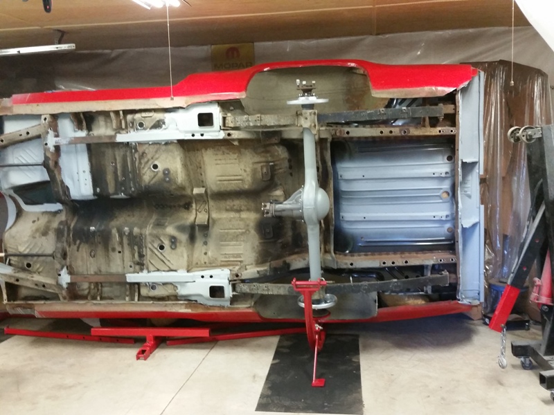

Then I removed the draw bar attachment and placed it under the car.
Now the underside work can commence! :beer:

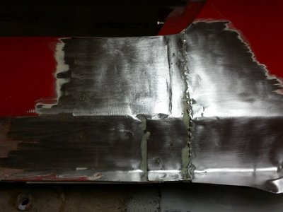

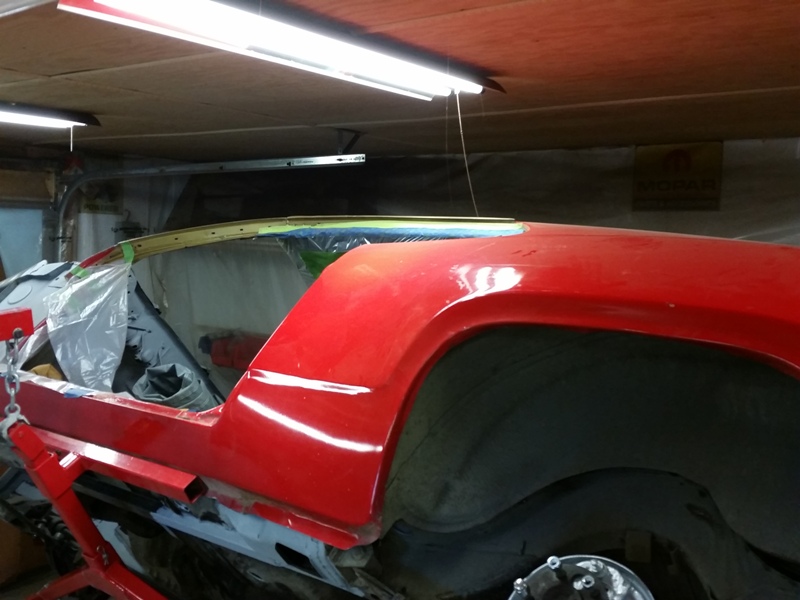

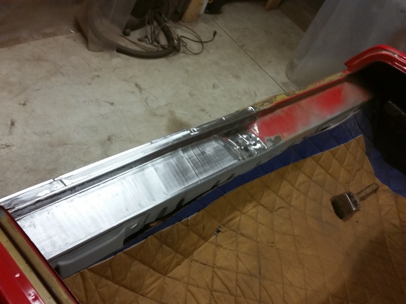

So now that the car is on her side, its time to start from the top....er...I mean the drivers side.

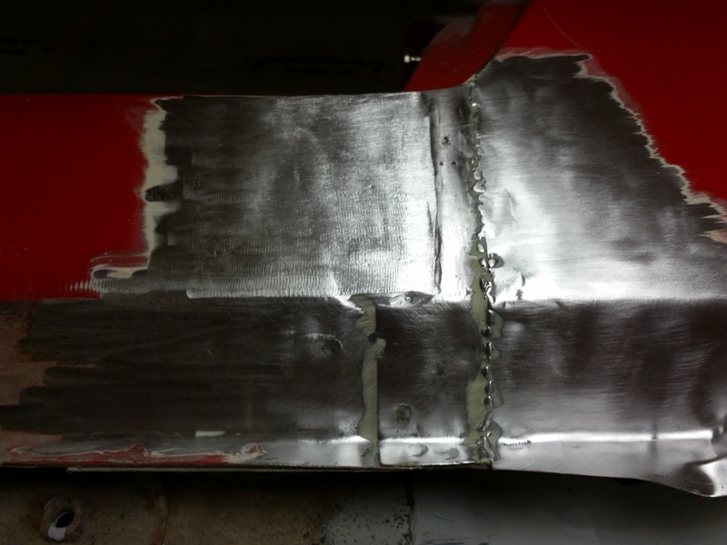

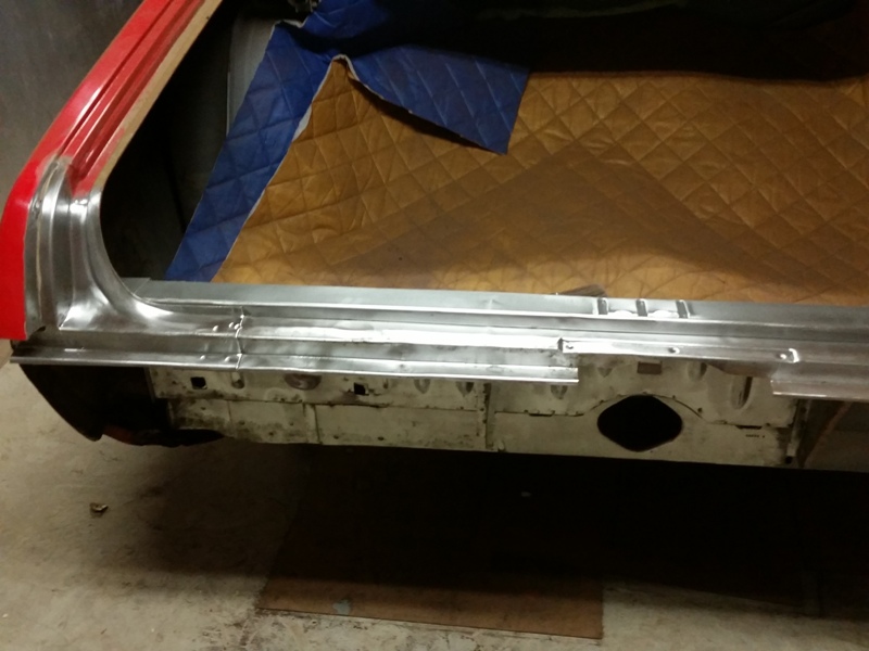

I started by digging into the body work that was done on the rocker sill where it meets the rear quarter.
This is what one of the previous owners did when they put another lower panel on.
Here's the lower lip going towards the rear tire.

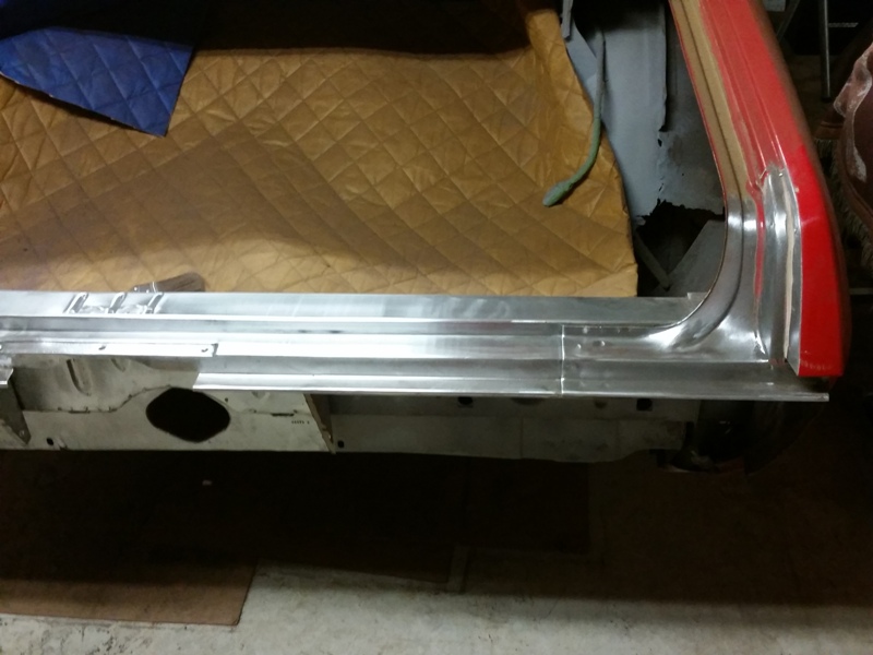

Then I stripped down the rest of the rocker sill.....well almost all of it. :D

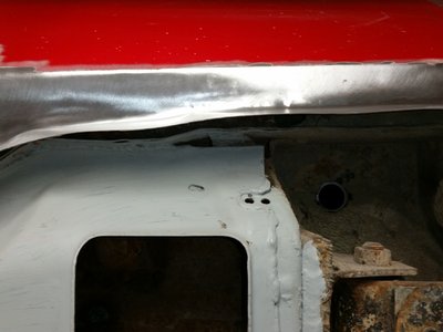

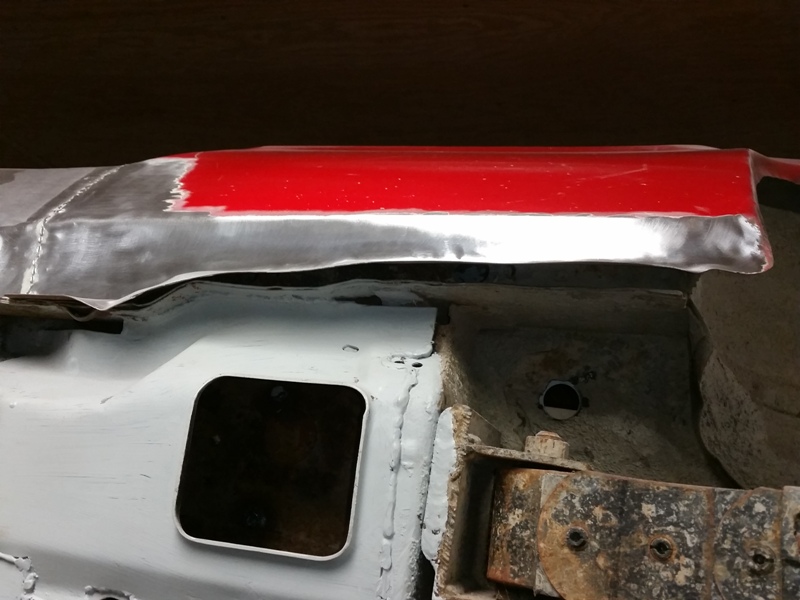

I do have a question for the guys that have changed the quarters on thier cars...do I just close up this gap and plug weld it?
