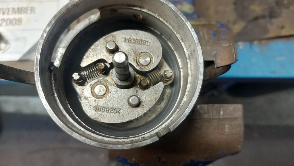

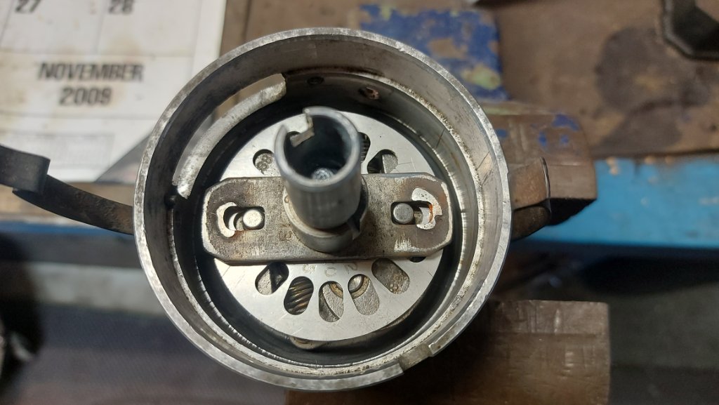

First is to recurve the distributor.

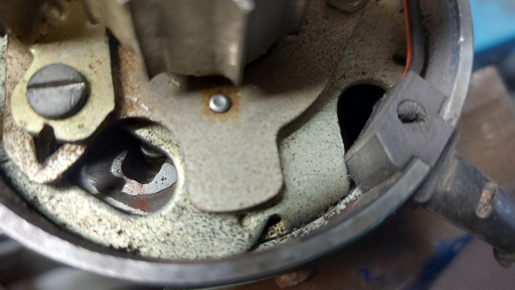

Years ago I had welded up the slots to lower the mechanical advance amount but wasn't sure by how much.
You can see the welds here.
When I had the engine on the dyno, it was checked and there is 20* mechanical advance. But since my engine has the KB107 pistons in it and they are hypereutectic - I've read that total timing shouldn't exceed 34* when running this type of piston so I had to back off my initial to 13* which gave me a safe total timing of 33*

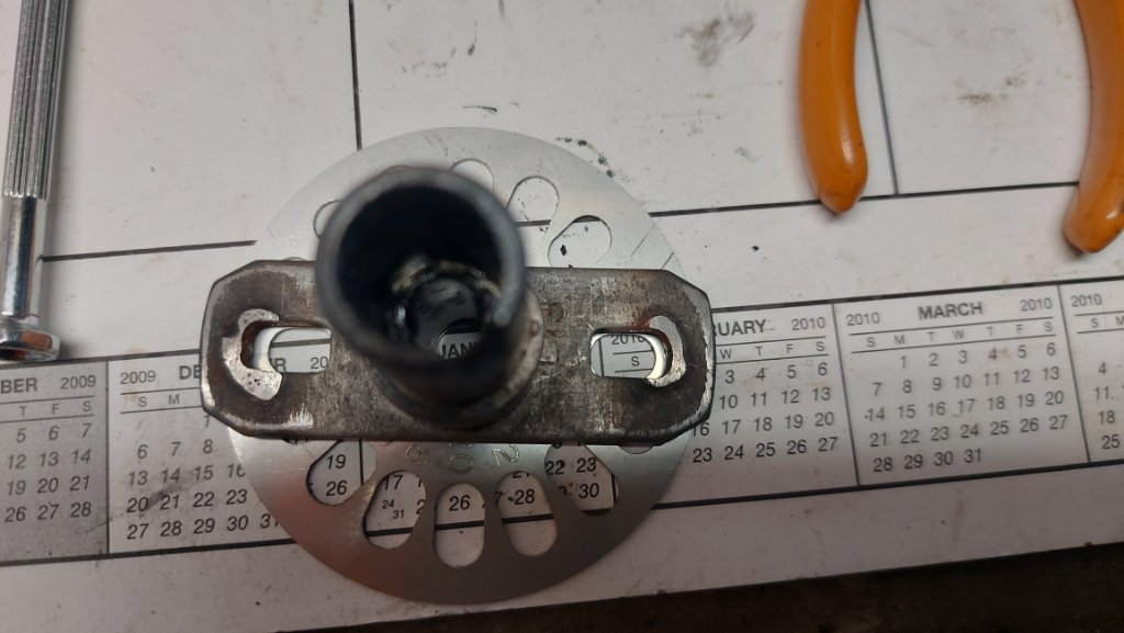

I want to tighten that up.

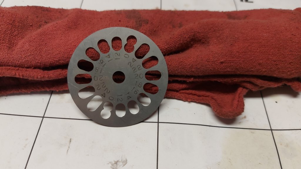

A buddy of mine had made this advance plate.
I think he copied the one that FBO offers (or offered at the time).

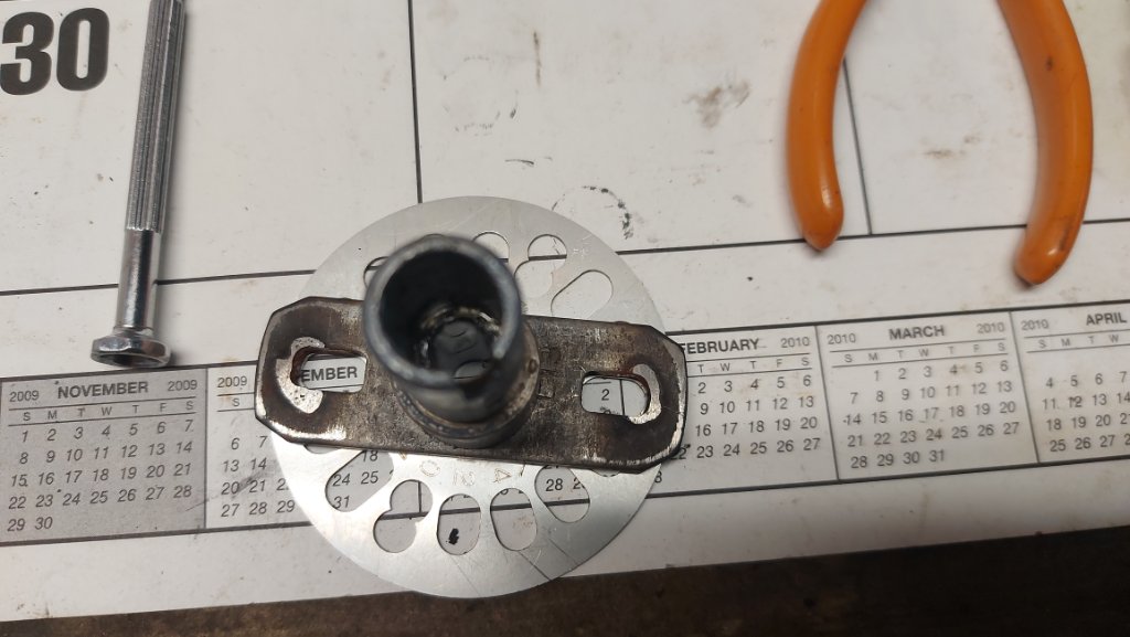

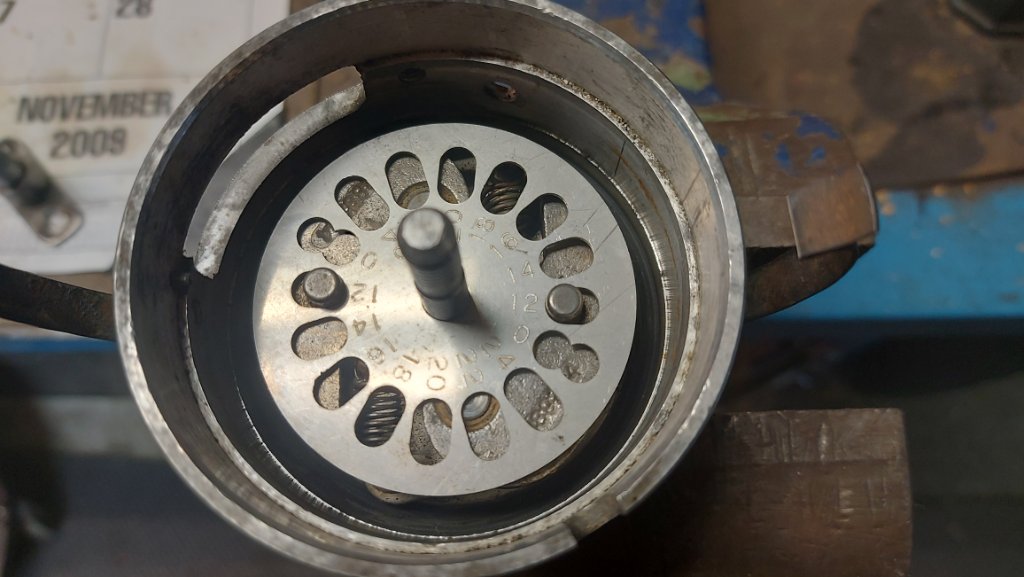

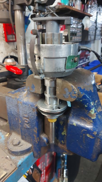

So I pulled the distributor apart to installed the limiter plate. But first I wanted to compare my welded up plate with the 20* slot on the round plate to see how close in comparison are the slots.
Yup, pretty much right on the money.
This shot is comparing the 12* slot which is what I'll be using to the welded up one.
Re: Startin to work on the Clone Runner PART 2
Post by 71Beeper » Sat Dec 06, 2025 8:57 pm
So with only 12* total mechanical advance I can have the initial set to 20* and the total will come in at 32*.

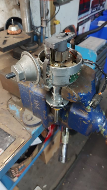

Time to reassemble.
I cleanup and repainted the vacuum advance pod - I gotta wait for the paint to dry to finish it up.

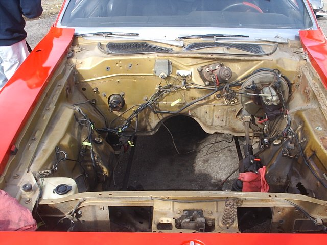

It is a EW1 car now, but that's not its original color.
The original color is GY8 Goldleaf metallic.
You can see the original color in the engine bay.

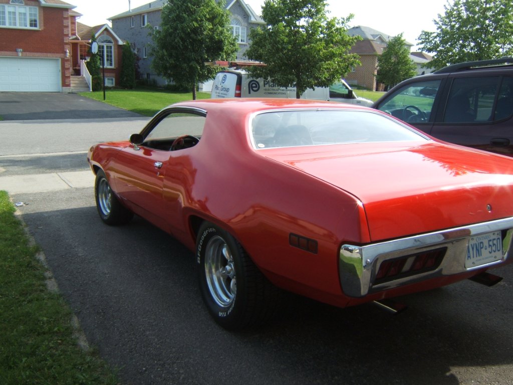

When I bought it back in 2009 it looked like this.
Post by 71Beeper » Sat Dec 20, 2025 8:10 pm
It sure looks good in those pictures but it was hiding many sins.
