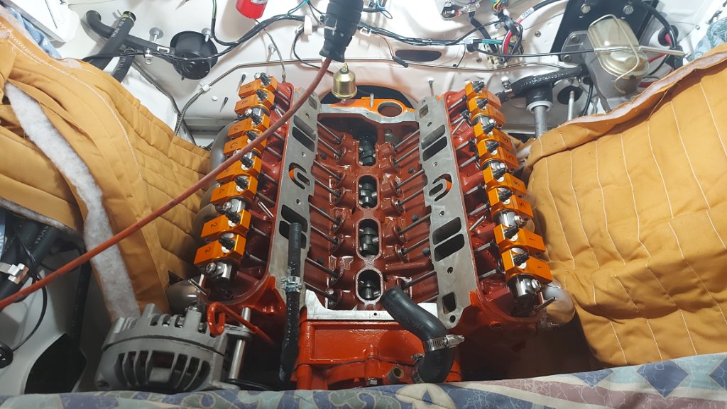

Post by 71Beeper » Sun Jun 08, 2025 2:17 pm
So I finally got a chance to get back in the garage to finish putting the car back together.
May 2nd & 3rd (1).jpg (117.64 KiB) Viewed 2116 times
Now to button up the engine and get it running.

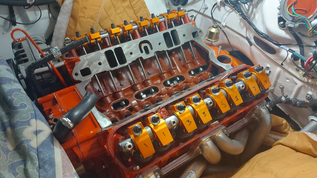

First, put the heads on along with the rocker shafts and rockers.
April 29th (1).jpg (139.08 KiB) Viewed 2116 times
April 29th (2).jpg (143.35 KiB) Viewed 2116 times

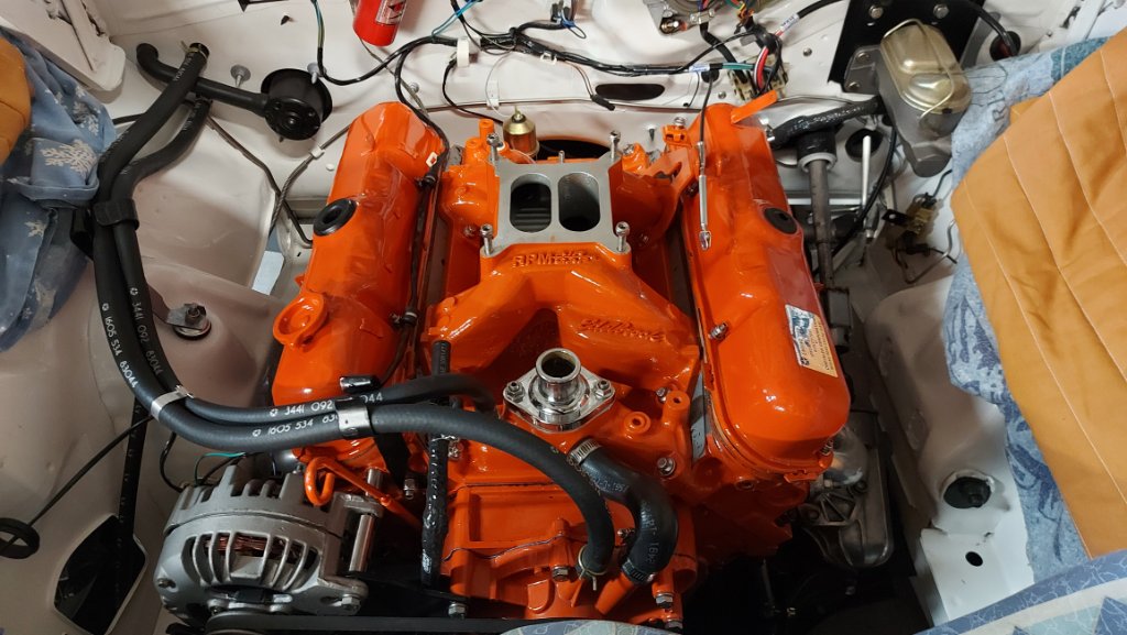

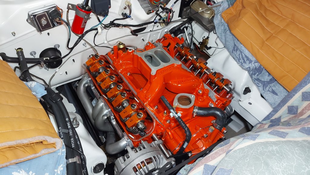

Then all the other little bits and pieces and get her fired up.
So far so good - I did take it for a shakedown run & everything is good.
Now to finally get some miles on it and (fingers crossed) no more bad things happen to her and I can finally enjoy it!

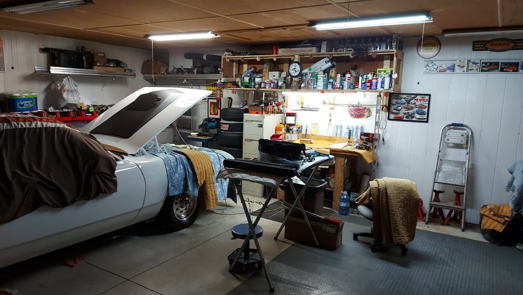

Post by 71Beeper » Sun Jun 08, 2025 2:19 pm
Took her out to a local cruze night. Parked next to my buddy who owns the 69 Dart ragtop.
It was a good night - no issues to report.
