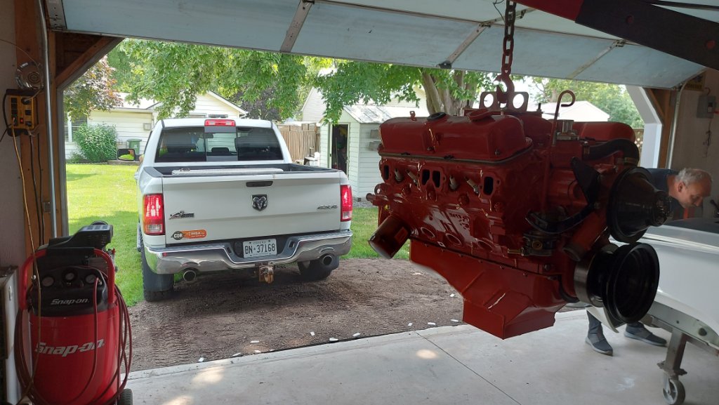

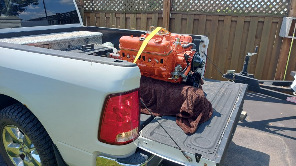

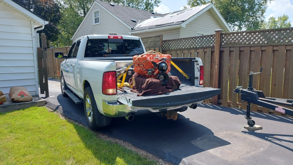

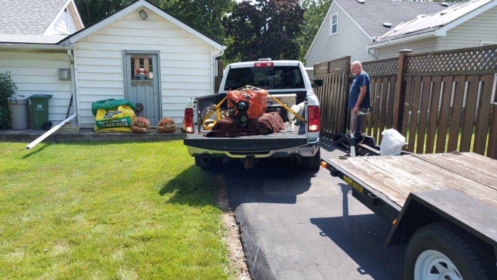

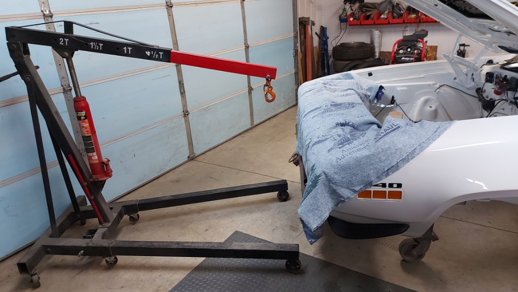

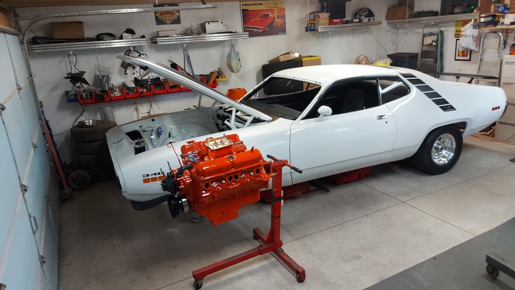

Took another big step today.
With the help of my neighbor who has a truck, we were able to get the engine loaded onto the back of it....
July 23rd (1).jpg (158.69 KiB) Viewed 363798 times
To take it....
July 23rd (2).jpg (130.13 KiB) Viewed 363798 times
To the other garage where the car is.
July 23rd (3).jpg (153.74 KiB) Viewed 363798 times
July 23rd (5).jpg (127.29 KiB) Viewed 363798 times
At least now it's in the same building as the car.
July 23rd (7).jpg (105.41 KiB) Viewed 363798 times
Many Thanks to my neighbor Dan with help from Mike and Tony. :beer:

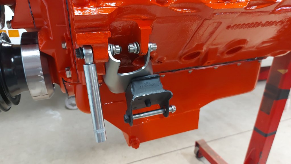

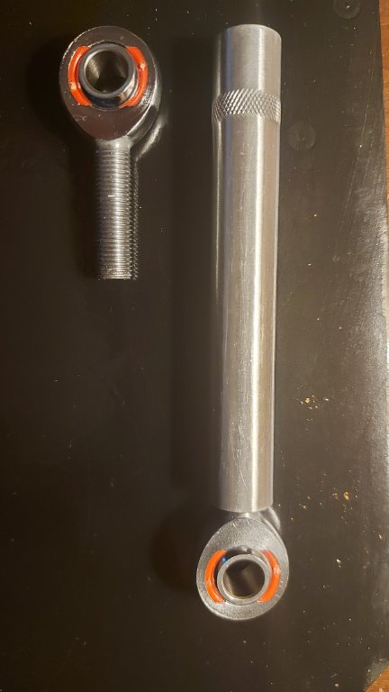

While waiting for ARP fasteners to come in, I ordered parts to make a torque strap.
Aug 4th.jpg (38.66 KiB) Viewed 363733 times
I ordered one of the heim ends with the wrong direction of threads, so I'm waiting got the proper one to come in.
Here's the fit-check.
Aug 4th (3).jpg (80.24 KiB) Viewed 363733 times

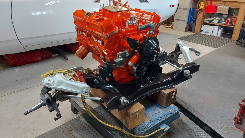

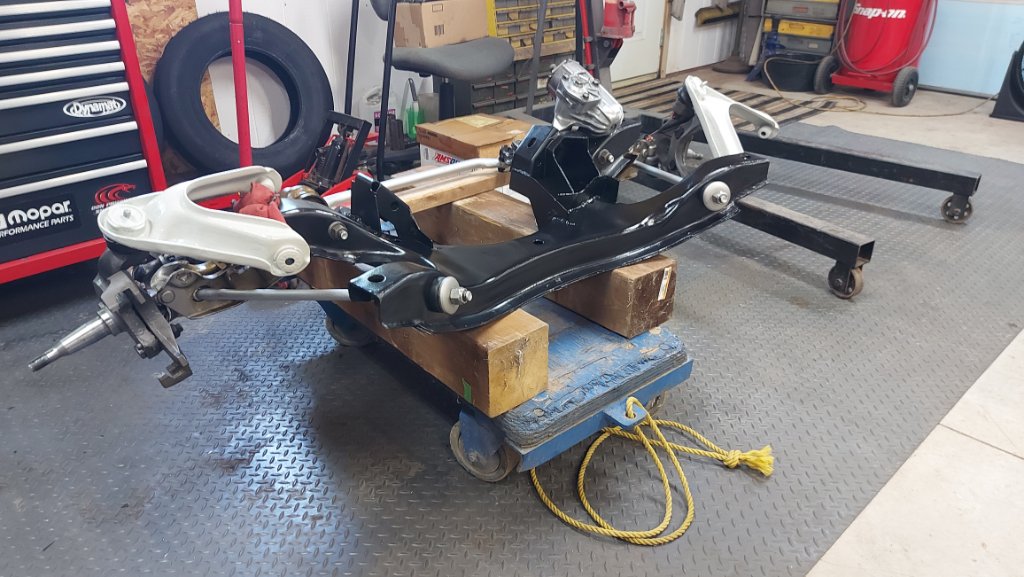

Then getting the K-member prepared.
Aug 4th (4).jpg (135.03 KiB) Viewed 363733 times

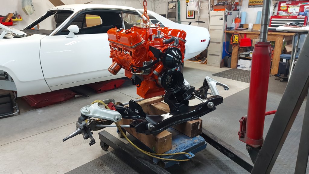

Now have the engine hover over it.
Aug 4th (7).jpg (125.17 KiB) Viewed 363733 times
Finally place it down and tighten all the fasteners.
Aug 4th (1).jpg (130.23 KiB) Viewed 363733 times
Next step - install flywheel and clutch and starter and headers.

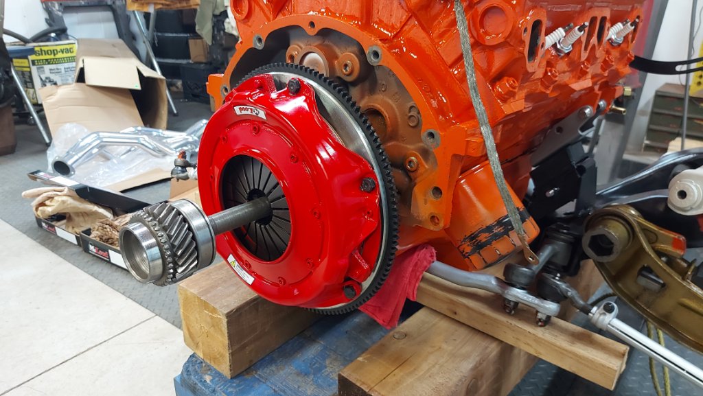

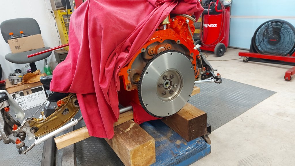

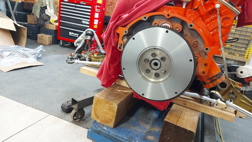

Yesterday, I had the flywheel mounted to the back of the crank.
August 26th (1).jpg (128.04 KiB) Viewed 363578 times
August 26th (2).jpg (143.54 KiB) Viewed 363578 times

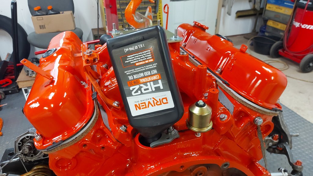

I also put the break-in oil in and primed it.
August 26th (3).jpg (131.53 KiB) Viewed 363578 times

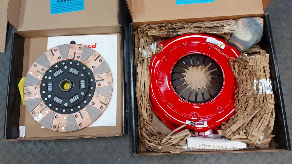

Then I got the new clutch out and ready to install.
August 26th (6).jpg (118.87 KiB) Viewed 363578 times
August 26th (7).jpg (138.44 KiB) Viewed 363578 times

Next step is to get the clutch disk and pressure plate installed.
August 26th (11).jpg (134.4 KiB) Viewed 363578 times

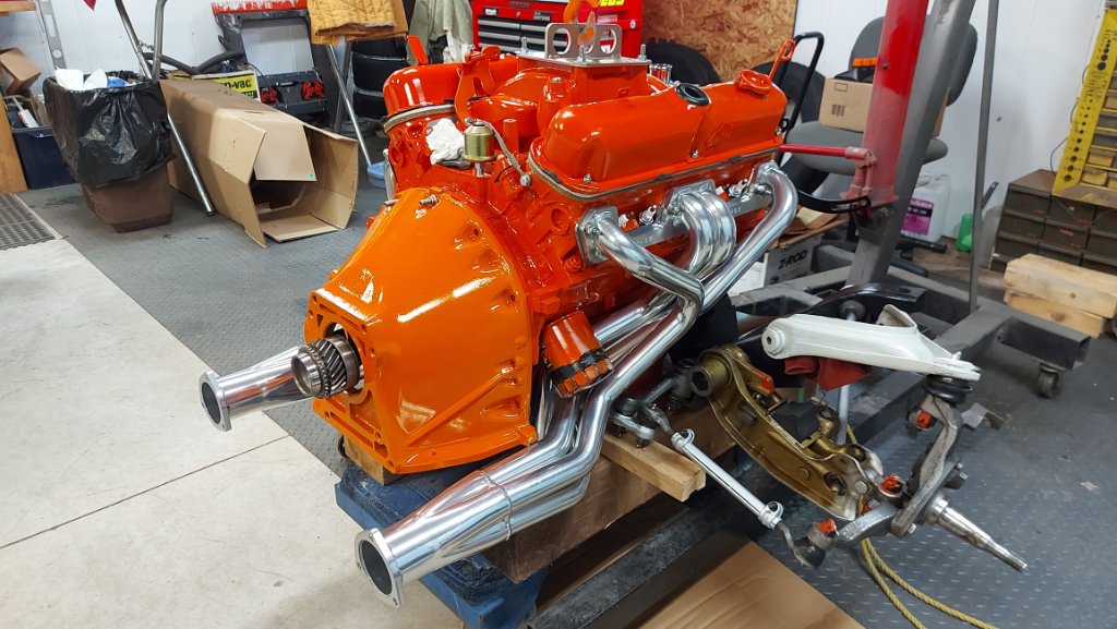

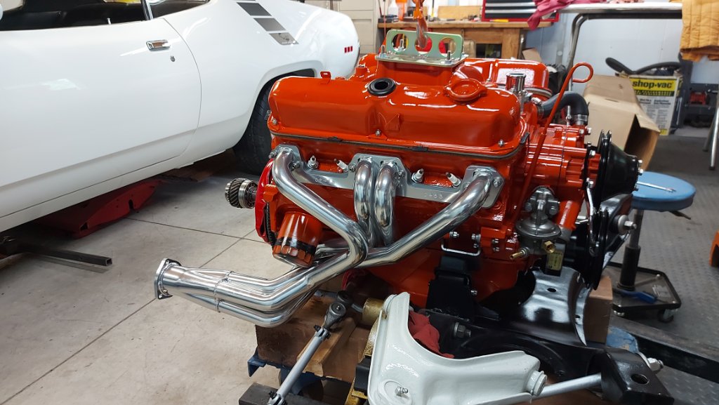

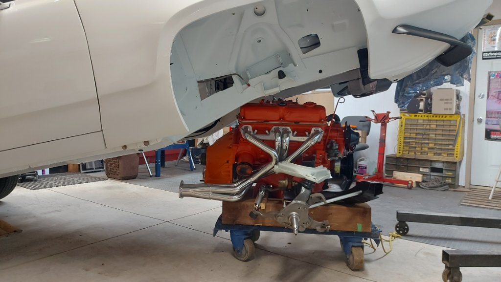

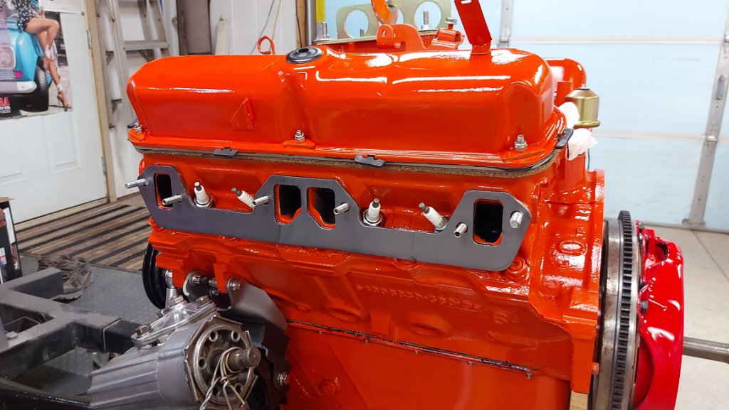

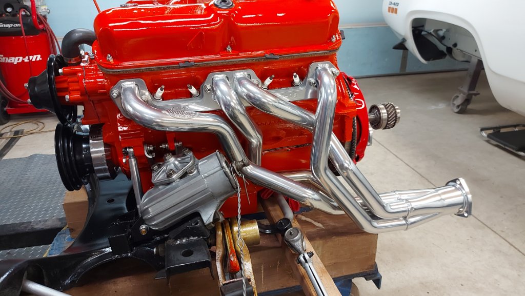

Next, its time to attach the Dougs headers. First install the Rem Flex header gaskets.
August 26th (12).jpg (117.45 KiB) Viewed 363578 times
Then, put on the bling.
August 26th (13).jpg (119.51 KiB) Viewed 363578 times
August 26th (14).jpg (130.16 KiB) Viewed 363578 times

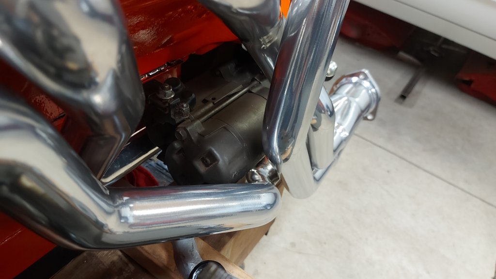

Stupid me didn't realize that the passenger side header would not go on with the oil filter installed, so it had to come off & this AFTER I primed the oil and filled the oil filter.... :mad:
Oh well, it wasn't too bad a mess to clean up.

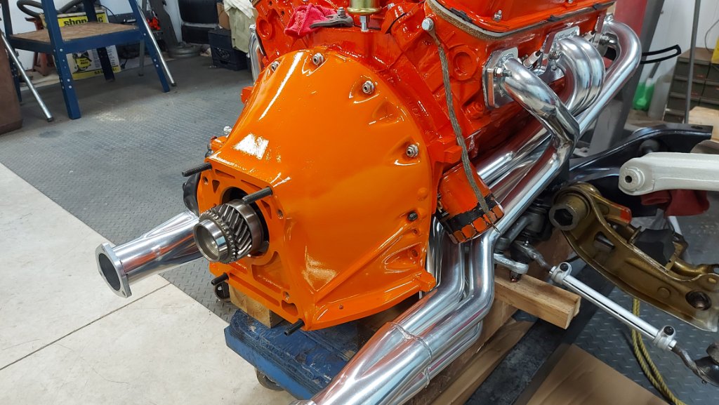

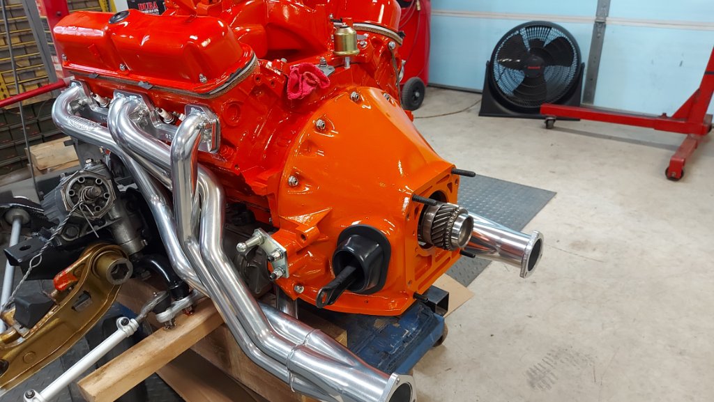

Lastly was to do a fit-check on the bell housing.
August 26th (16).jpg (141.45 KiB) Viewed 363578 times

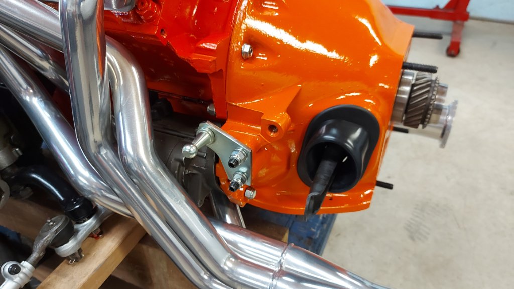

After getting all of the required fasteners for the bellhousing I was able to finally install it for good.
Sept 18th, 2023 (3).jpg (132.05 KiB) Viewed 363501 times
Sept 18th, 2023 (4).jpg (138.65 KiB) Viewed 363501 times
I had to install studs to where the 4 speed is mounted to the bellhousing as the threads were buggered up in the aluminum bellhousing, so I had to wait for fully threaded bolts to come from McMaster Carr.
Sept 18th, 2023 (2).jpg (101.48 KiB) Viewed 363501 times
Sept 18th, 2023 (3).jpg (132.07 KiB) Viewed 363501 times
and to finish off the install, make sure the starter is in.
Sept 18th, 2023 (1).jpg (74.81 KiB) Viewed 363501 times

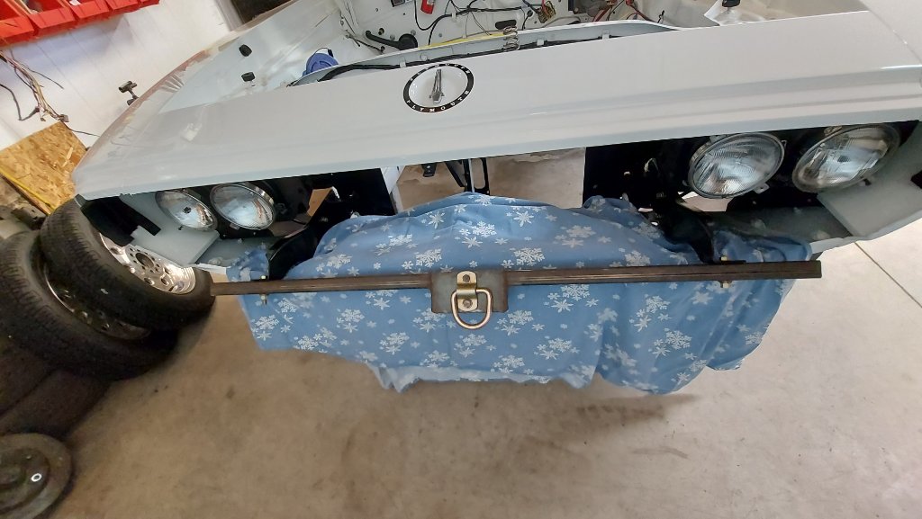

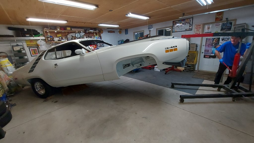

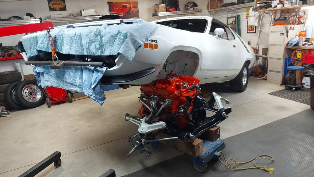

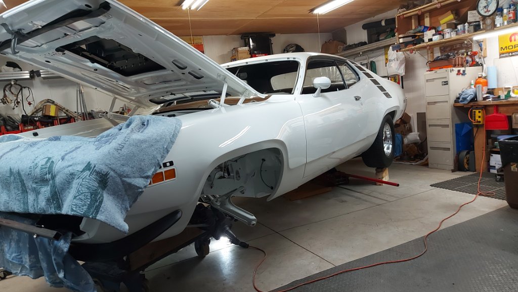

So tonight with the help of my assistant (Many Thanks Hugh) One big hurdle was cleared.
It started off by installing the lifting bar on the front of the car.
Sept 18th, 2023 (7).jpg (99.97 KiB) Viewed 363501 times
Next, getting the hoist in place.
Sept 18th, 2023 (9).jpg (106.61 KiB) Viewed 363501 times
Next step is lifting the body.
Sept 18th, 2023 (14).jpg (103.17 KiB) Viewed 363501 times
Then do a fit-check to see if we have to go any higher.
Sept 18th, 2023 (16).jpg (131.63 KiB) Viewed 363501 times
Then, maneuver the k-member to line up the mounting bolts.
Sept 18th, 2023 (24).jpg (91.58 KiB) Viewed 363501 times

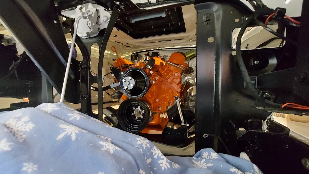

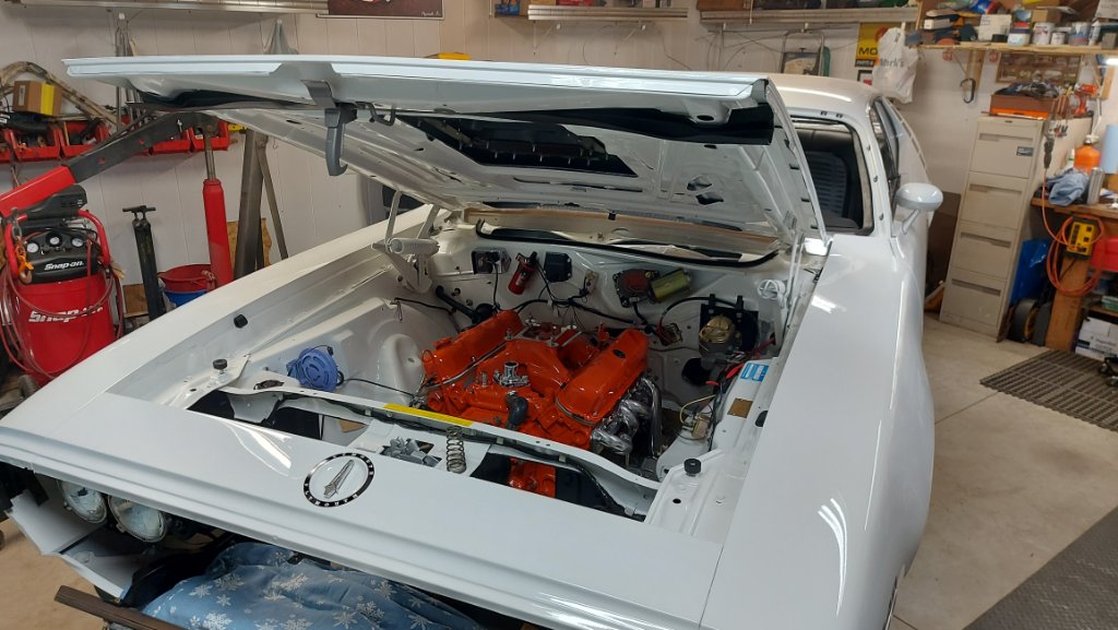

Post by 71Beeper » Mon Sep 18, 2023 11:38 pm

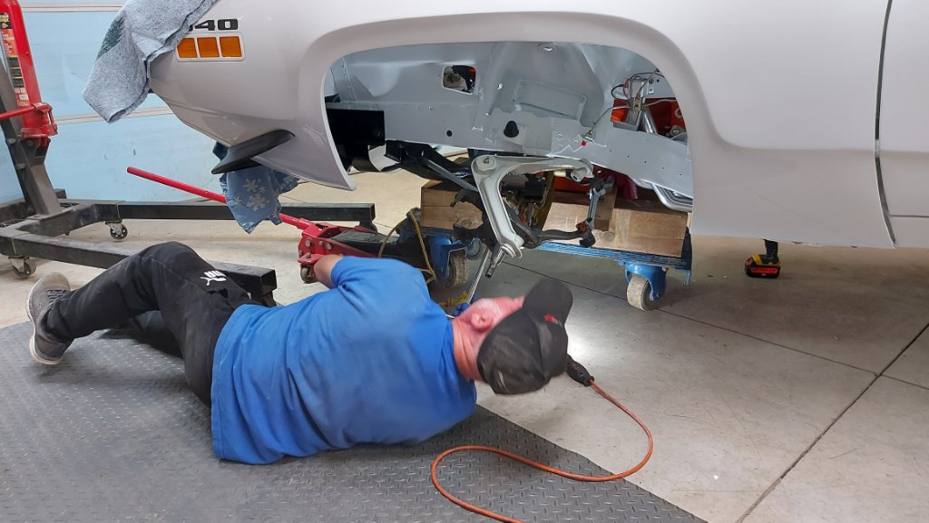

Then came the realization that the back end of the car will have to go up as the header collector was touching the underside of the floor pan.
Sept 18th, 2023 (31).jpg (121.98 KiB) Viewed 363500 times

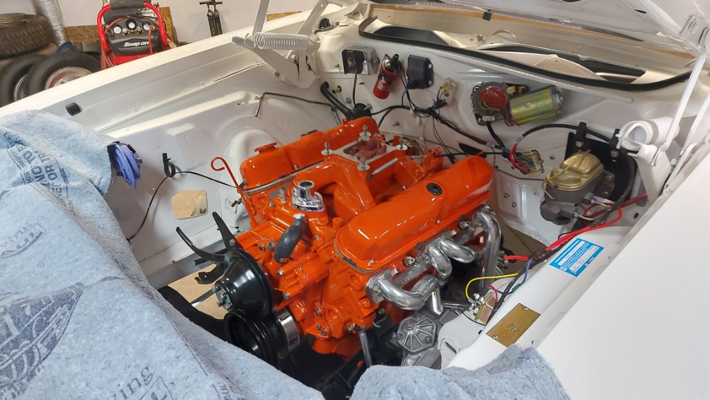

So now that the body was more level it was time to install the k-member bolts.
Sept 18th, 2023 (32).jpg (99.82 KiB) Viewed 363500 times
And she finally has an engine in it!!! :beer:
Sept 18th, 2023 (33).jpg (127.5 KiB) Viewed 363500 times
Sept 18th, 2023 (35).jpg (119.35 KiB) Viewed 363500 times
Sept 18th, 2023 (37).jpg (123.22 KiB) Viewed 363500 times
What a relief that was.... :wink:

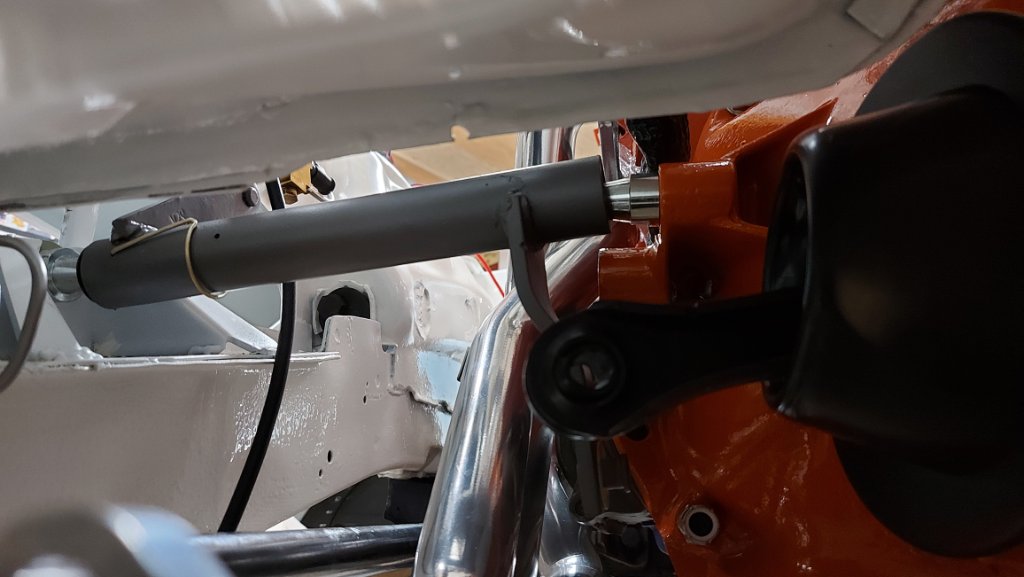

Not alot done after the engine and K-member install.

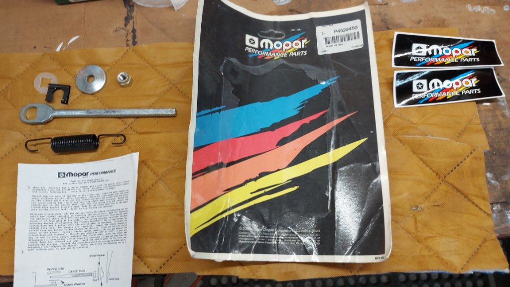

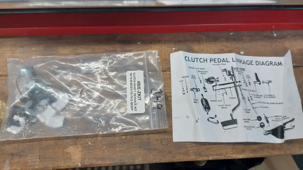

I did install the torsion bars and today I did install the Z-bar for the clutch.
I bought this kit some time ago.
Sept 24th, 2023 (1).jpg (78.7 KiB) Viewed 363437 times
Sept 24th, 2023 (2).jpg (98.73 KiB) Viewed 363437 times
But then remembered that I had this kit too.
Sept 24th, 2023 (3).jpg (123.64 KiB) Viewed 363437 times
So using the Mopar Performance kit, the Z-bar went in nicely.
Sept 24th, 2023 (4).jpg (94.53 KiB) Viewed 363437 times
Sept 24th, 2023 (5).jpg (70.27 KiB) Viewed 363437 times
For the sharp eyed guys out there - yes the bar is slightly crooked as I have the back of the engine supported by a jack stand which is slightly higher than it should be.
Once the 4 speed is in, the bar should look more even.

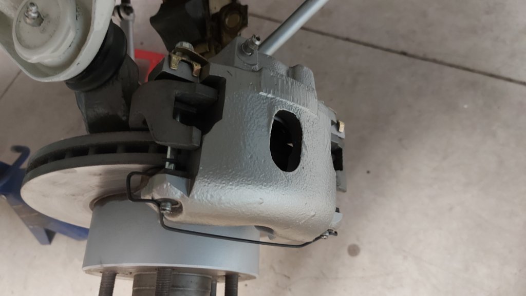

Post by 71Beeper » Sat Oct 14, 2023 7:27 pm

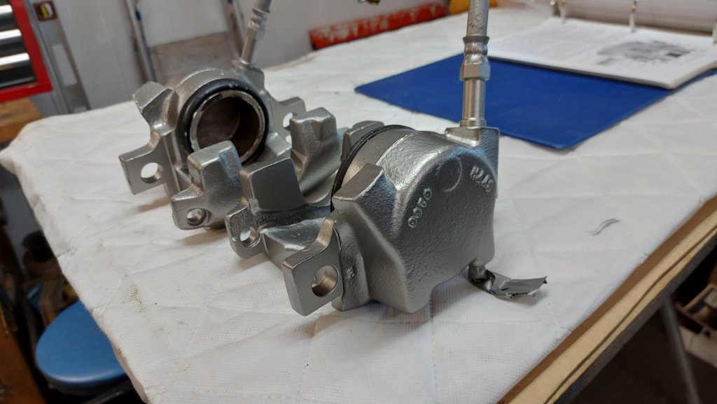

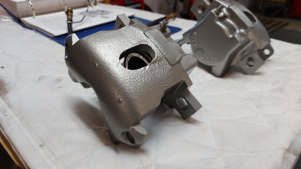

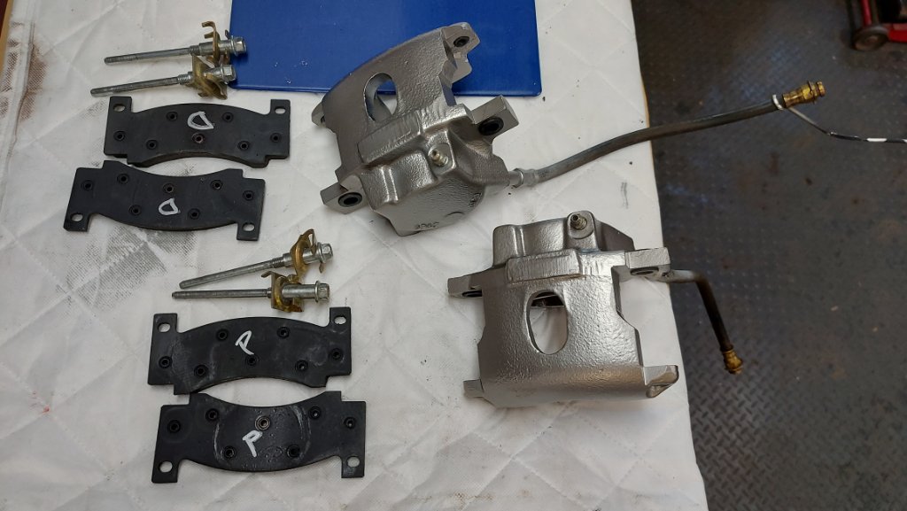

In the meantime I got to work to get the front brakes on the car.

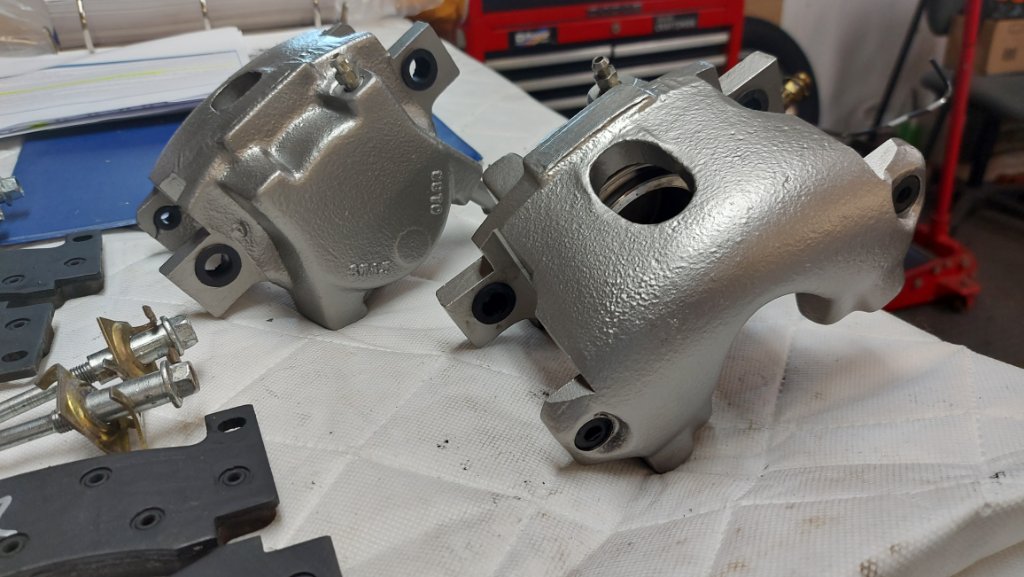

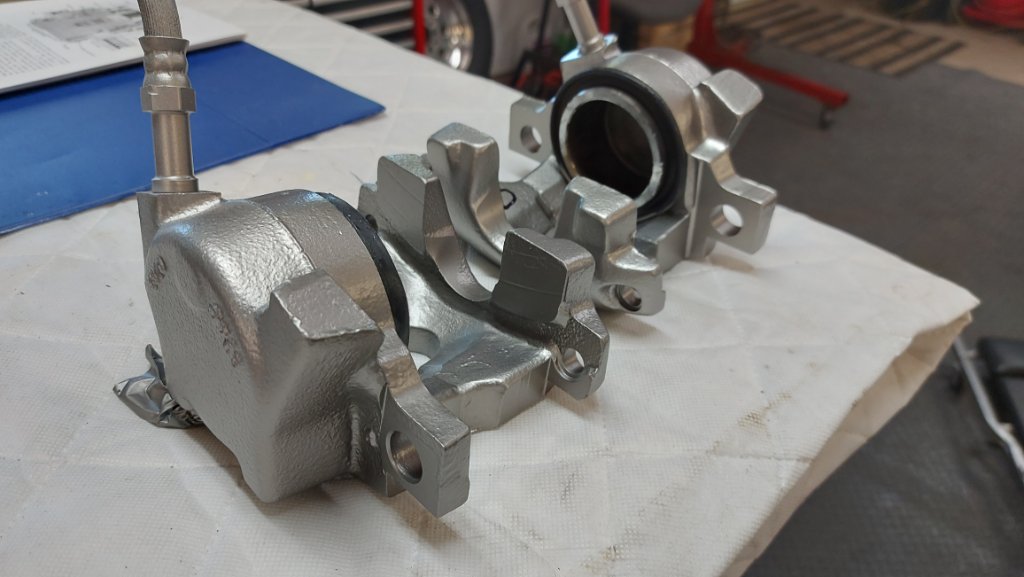

First is to cleanup and paint the calipers.
I sprayed them with some VHT caliper paint.
Oct 1st (1).jpg (80.52 KiB) Viewed 357042 times
Oct 1st (2).jpg (80.15 KiB) Viewed 357042 times
Oct 1st (5).jpg (78.03 KiB) Viewed 357042 times
Oct 1st (7).jpg (103.54 KiB) Viewed 357042 times
Oct 1st (6).jpg (91 KiB) Viewed 357042 times

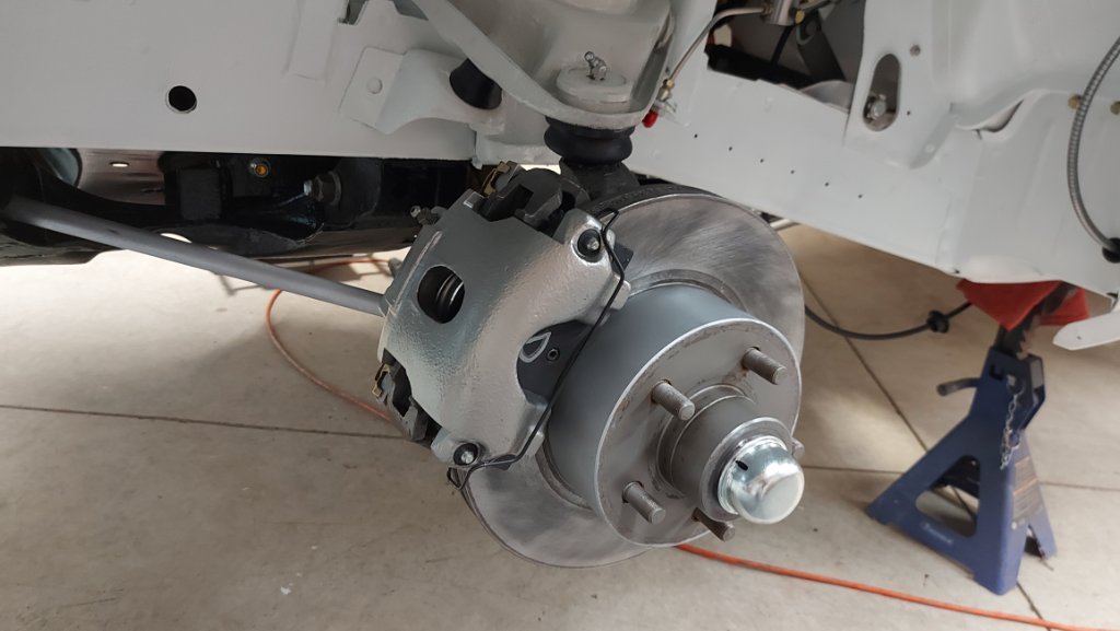

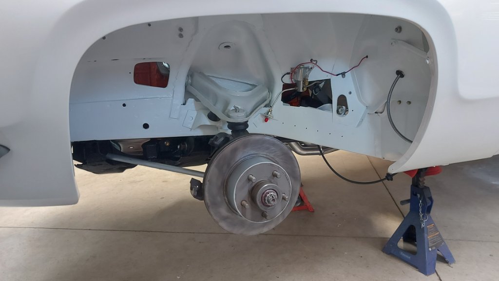

Posts: 741
Post by 71Beeper » Sat Oct 14, 2023 7:30 pm

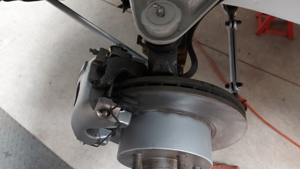

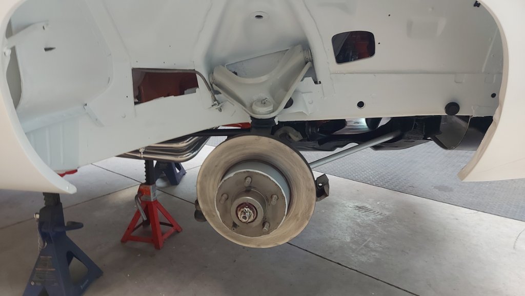

Next is to clean-up the rotors and get them mounted.
Oct 1st (8).jpg (61.47 KiB) Viewed 357042 times
Oct 1st (9).jpg (66.38 KiB) Viewed 357042 times
Then install the calipers and pads.
Oct 1st (10).jpg (72.96 KiB) Viewed 357042 times
Oct 1st (12).jpg (66.54 KiB) Viewed 357042 times
Oct 1st (15).jpg (59.3 KiB) Viewed 357042 times

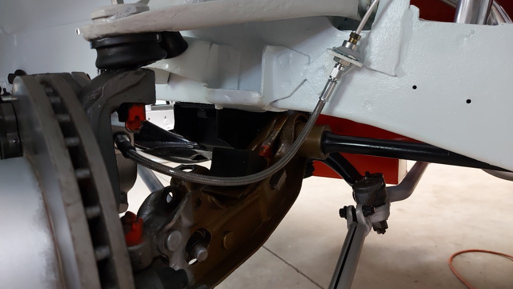

Post by 71Beeper » Sat Oct 14, 2023 7:33 pm

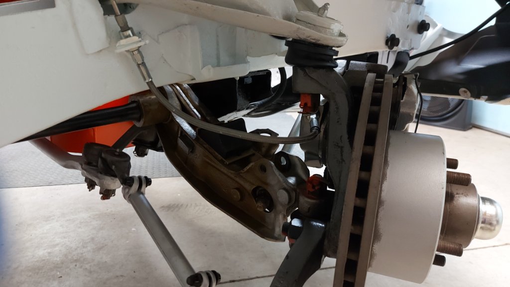

Next is to install the front flex lines.
I bought the kit from fine lines. The rear one is already installed.
Now for the front ones.
Oct 10th (1).jpg (74.83 KiB) Viewed 357041 times
Oct 10th (2).jpg (82.94 KiB) Viewed 357041 times

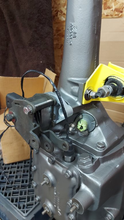

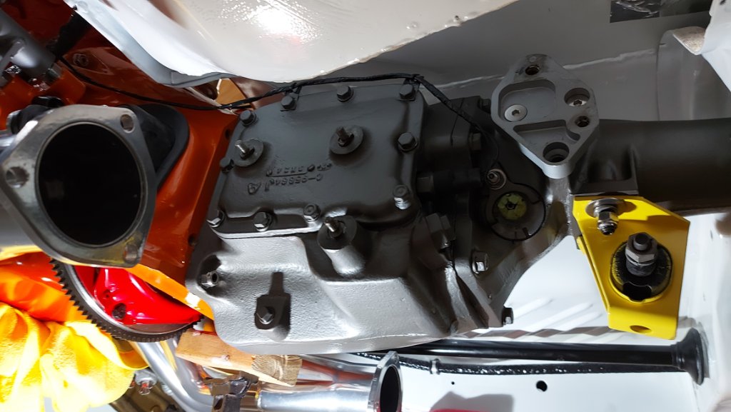

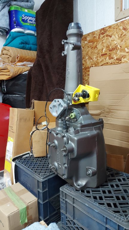

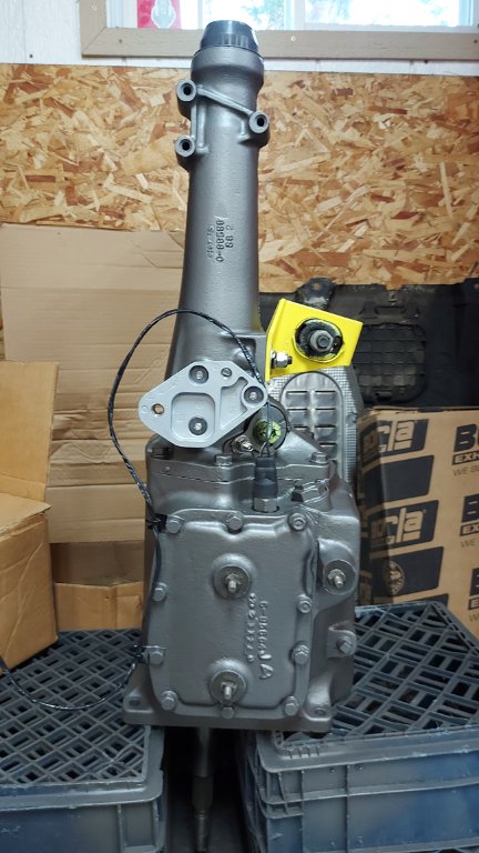

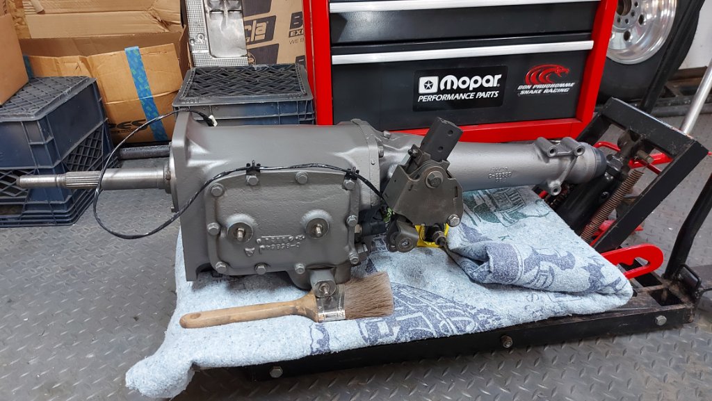

Now the really big job - getting the 4 speed ready to install.
First - mount the shifter adaptor.
Oct 14th (1).jpg (75.74 KiB) Viewed 357041 times
Oct 14th (2).jpg (81.09 KiB) Viewed 357041 times
Now the shifter box.
Oct 14th (3).jpg (67.09 KiB) Viewed 357041 times

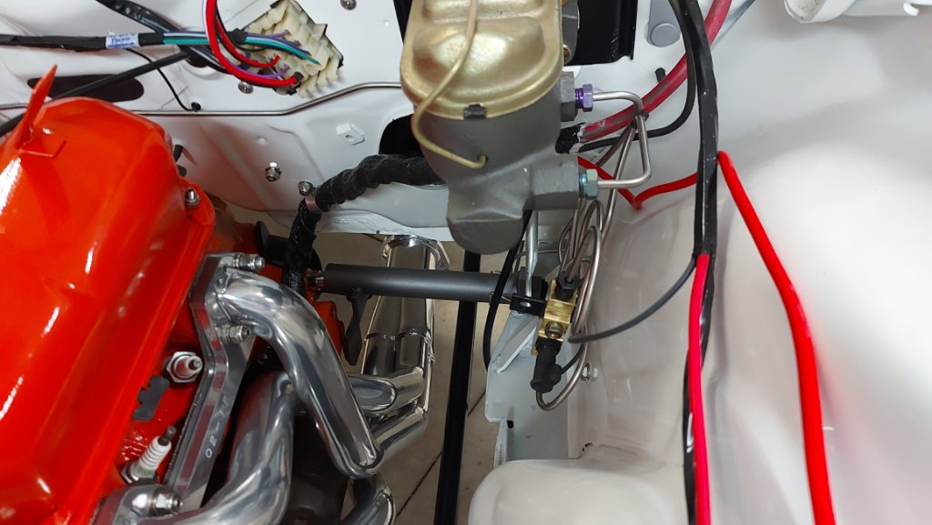

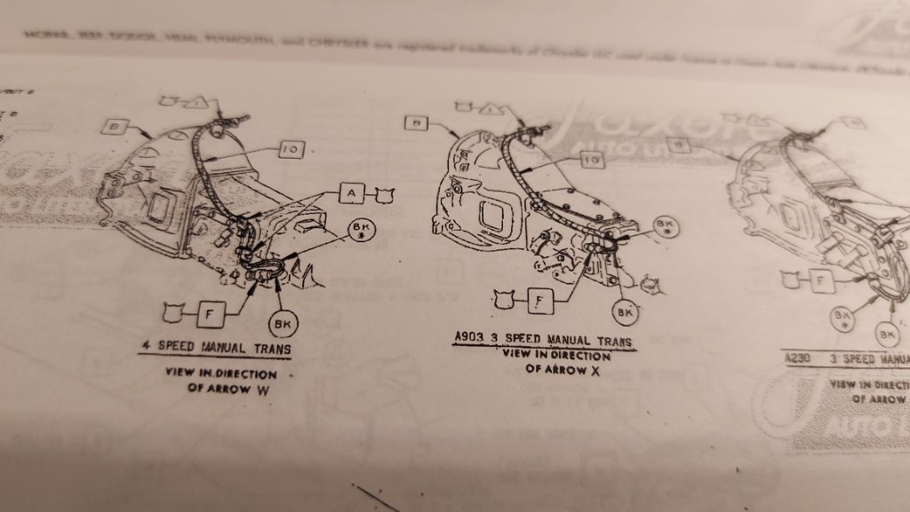

I wasn't sure how the reverse light wiring was to be routed - I assumed it went around the shifter box as shown in the last photo.
So I had a look in this book for a reference photo.
Oct 14th (4).jpg (38.66 KiB) Viewed 357041 times
Sure enough, there it is.
Oct 14th (5).jpg (73.95 KiB) Viewed 357041 times

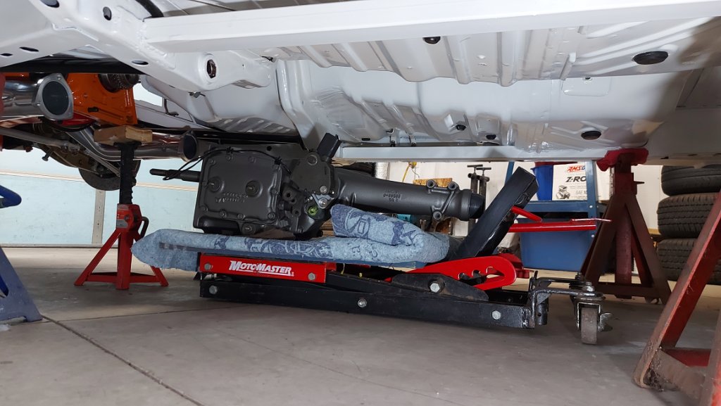

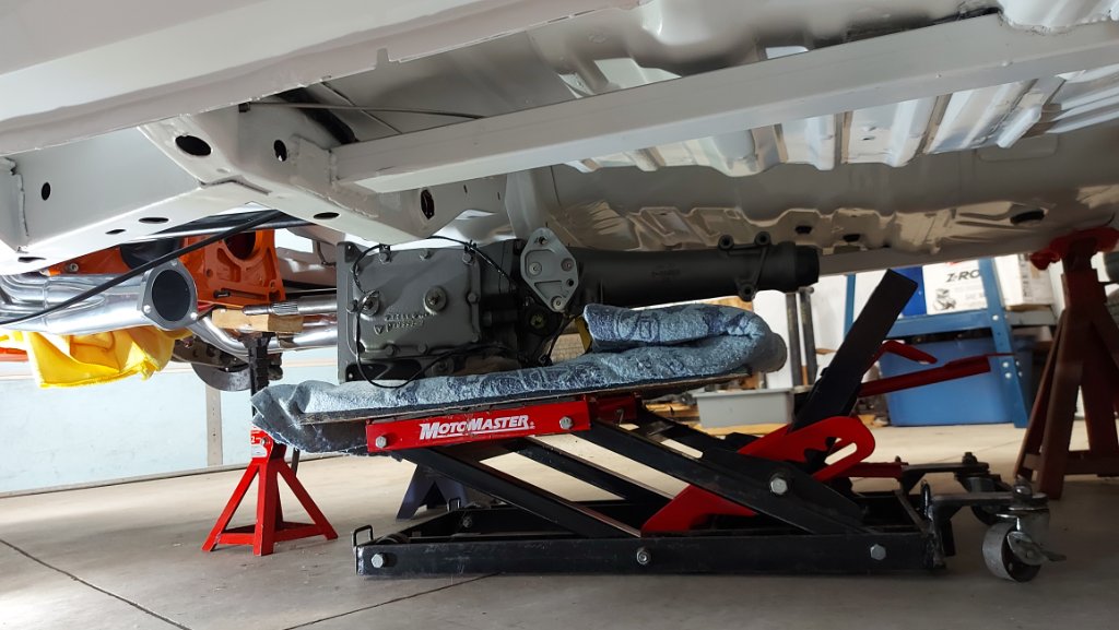

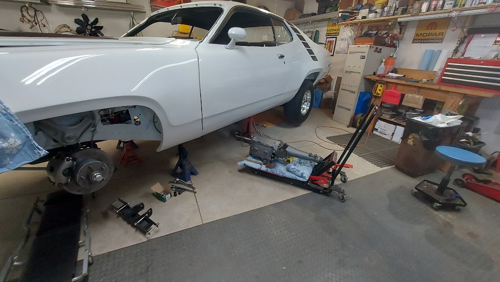

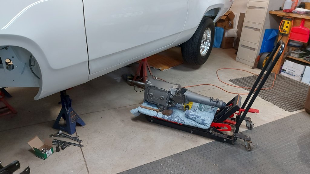

Next, lets get the gearbox on the jack.
Oct 14th (6).jpg (137.23 KiB) Viewed 357041 times
And now lets get it under the car.
Oct 14th (8).jpg (112.86 KiB) Viewed 357041 times
Oct 14th (9).jpg (96.25 KiB) Viewed 357041 times

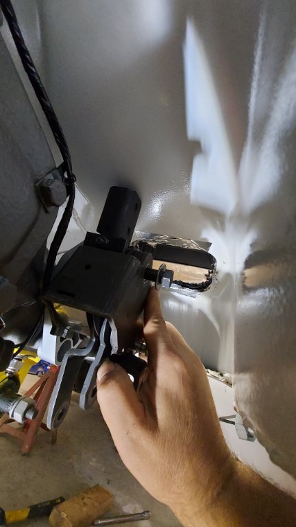

Get the gearbox rolled into position. I decided to remove the shifter box at this point as it would be easier to install once the transmission was in place.
Oct 14th (11).jpg (103.22 KiB) Viewed 357040 times
Now bring up the height.
Oct 14th (12).jpg (106.72 KiB) Viewed 357040 times
Slide her in and do up the fasteners and she's in!
Mind you she did fight me the whole time..... :rant:
Oct 14th (15).jpg (100.28 KiB) Viewed 357040 times

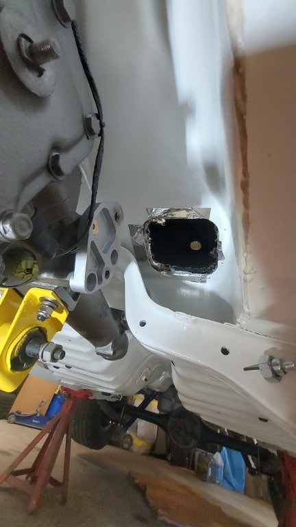

So I go to put the shifter box back in place and uh-oh....Houston we have a problem... :shock:
Oct 14th (13).jpg (50.08 KiB) Viewed 357040 times
Oct 14th (14).jpg (52.08 KiB) Viewed 357040 times
