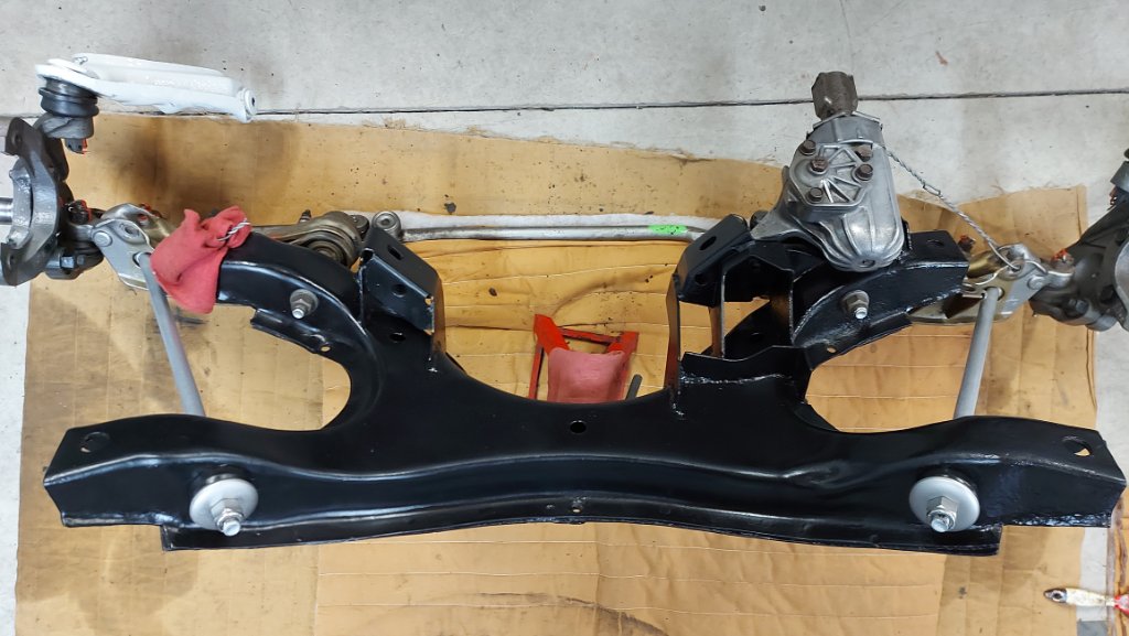

Post by 71Beeper » Sun Mar 05, 2023 12:43 pm

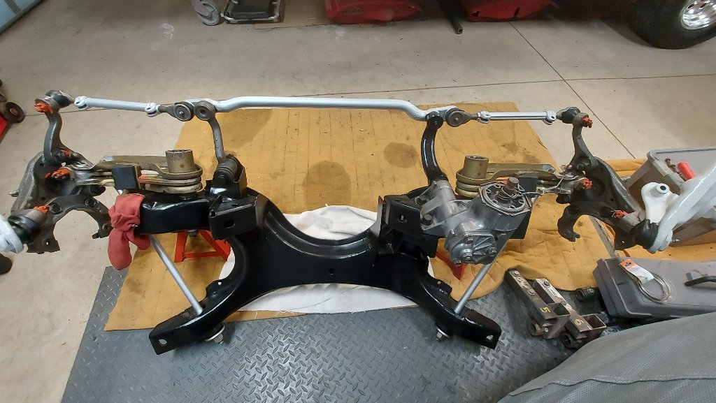

Got in the shop this morning - the paint is almost dry.
Still tacky in a few places.
Here's what semi-gloss black looks like.

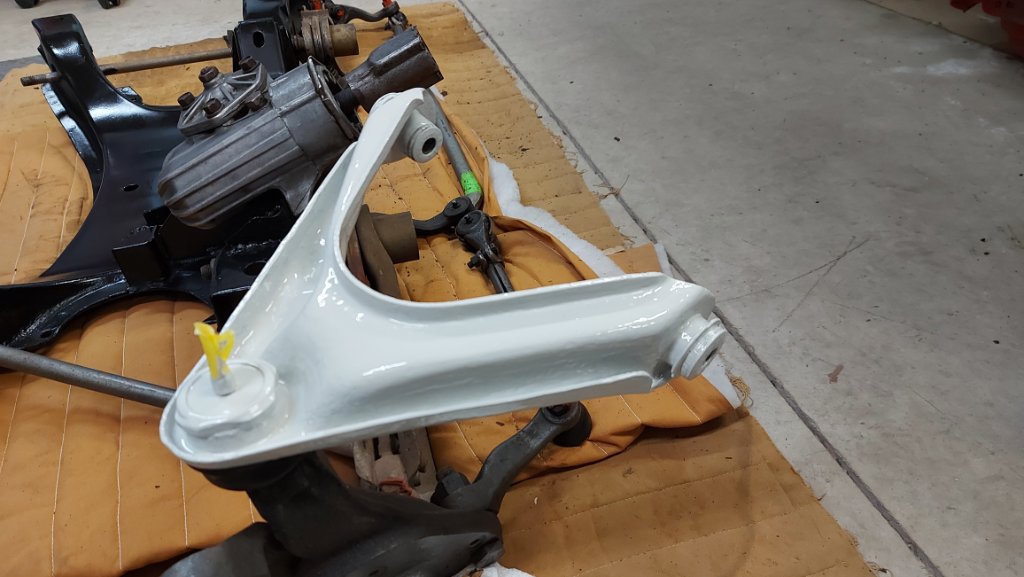

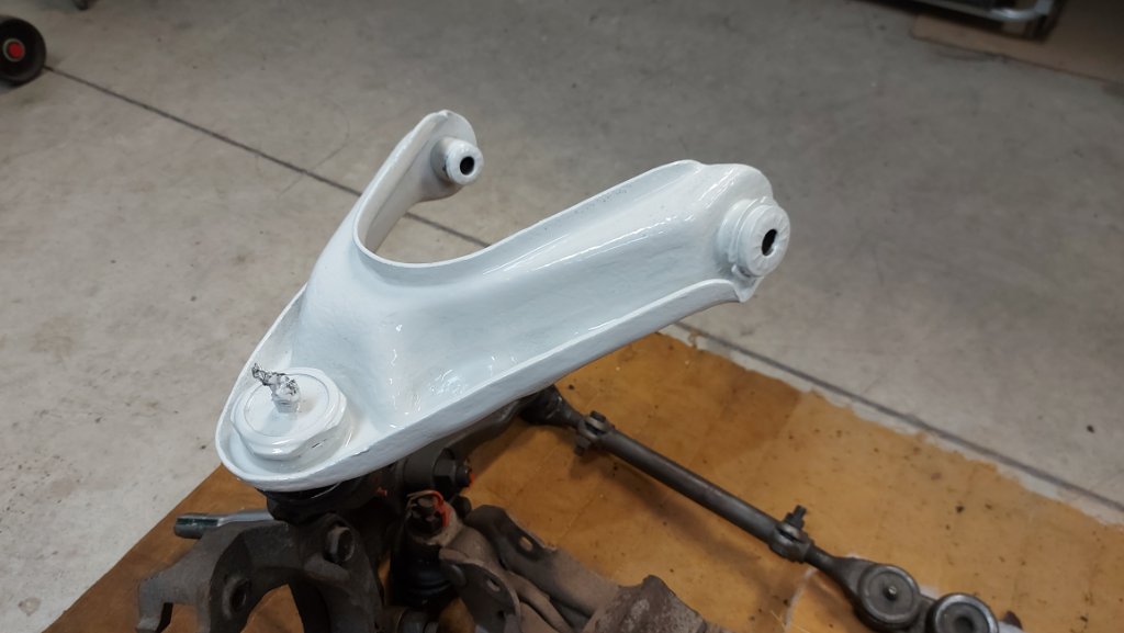

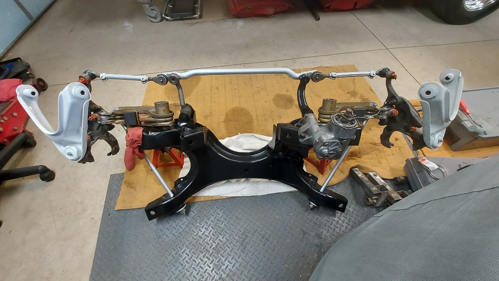

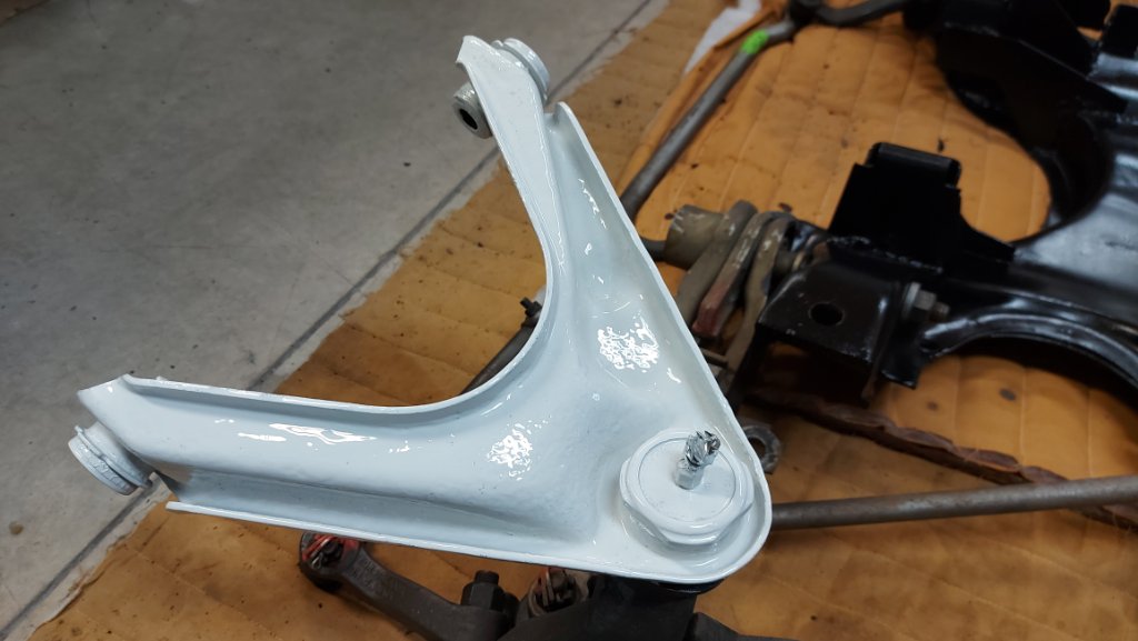

Next step is do paint the control arms. The current aluminum color that's on them need some freshening up.
I scuffed them down and applied a light grey paint to them.

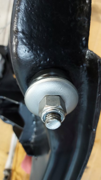

Post by 71Beeper » Sun Mar 26, 2023 3:09 pm

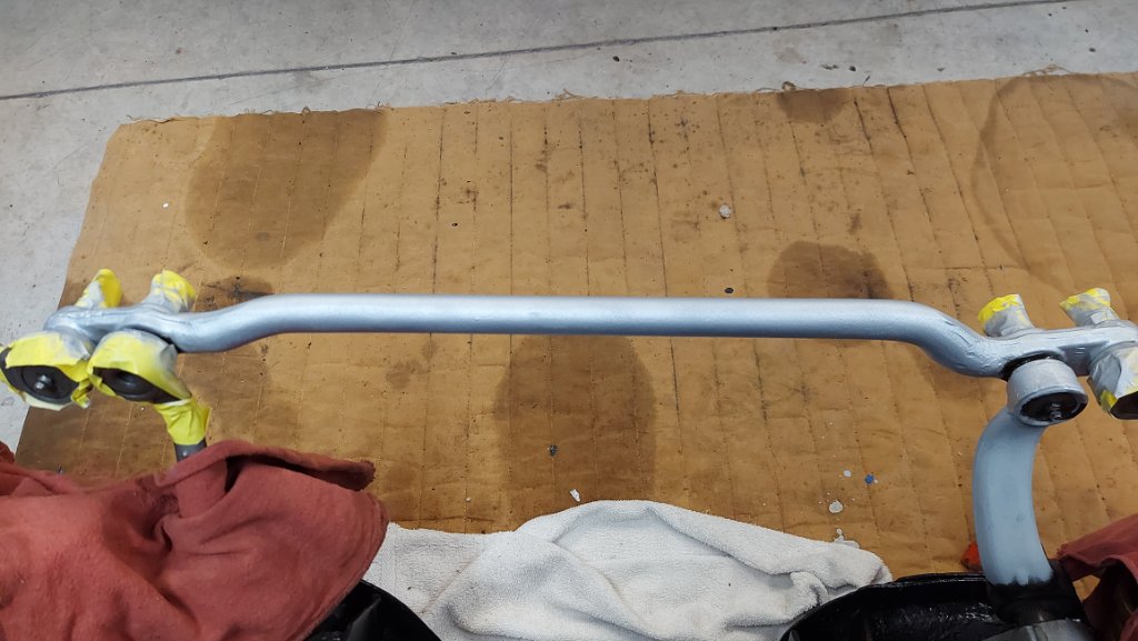

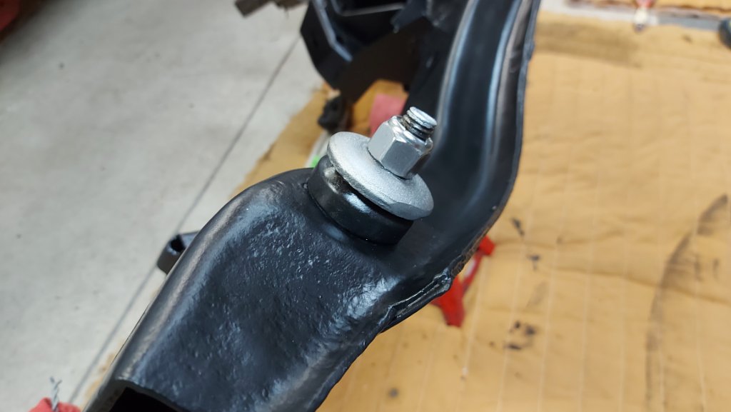

Moving along, the strut rods are next.
Scuff em down and paint them with a nice steel color VHT caliper paint.
Also put new stainless hardware on the ends.
March 26th (1).jpg (107.66 KiB) Viewed 249797 times
March 26th (2).jpg (61.05 KiB) Viewed 249797 times
March 26th (4).jpg (43 KiB) Viewed 249797 times

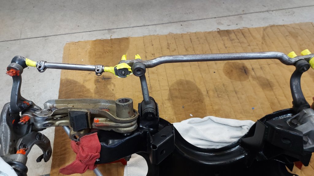

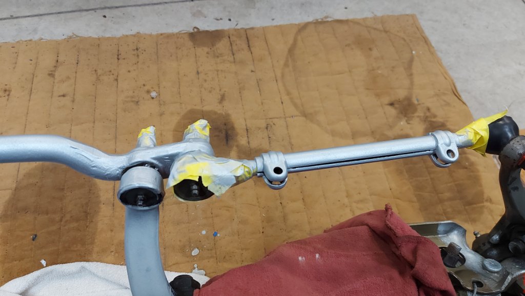

Post by 71Beeper » Sun Mar 26, 2023 3:13 pm

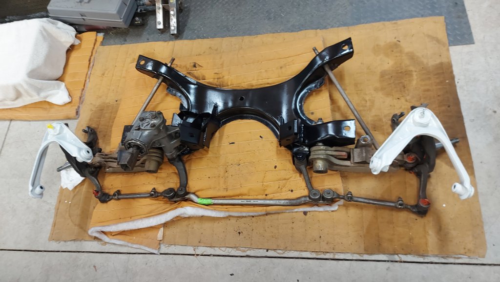

Now its on to prepping the steering components.
Scuff them down with my fiber wheel.
Wash them up with lacquer thinner & do some masking too.
March 26th (11).jpg (103.05 KiB) Viewed 249797 times
March 26th (12).jpg (114.16 KiB) Viewed 249797 times
March 26th (13).jpg (119.67 KiB) Viewed 249797 times
March 26th (14).jpg (116.72 KiB) Viewed 249797 times
March 26th (15).jpg (101.59 KiB) Viewed 249797 times

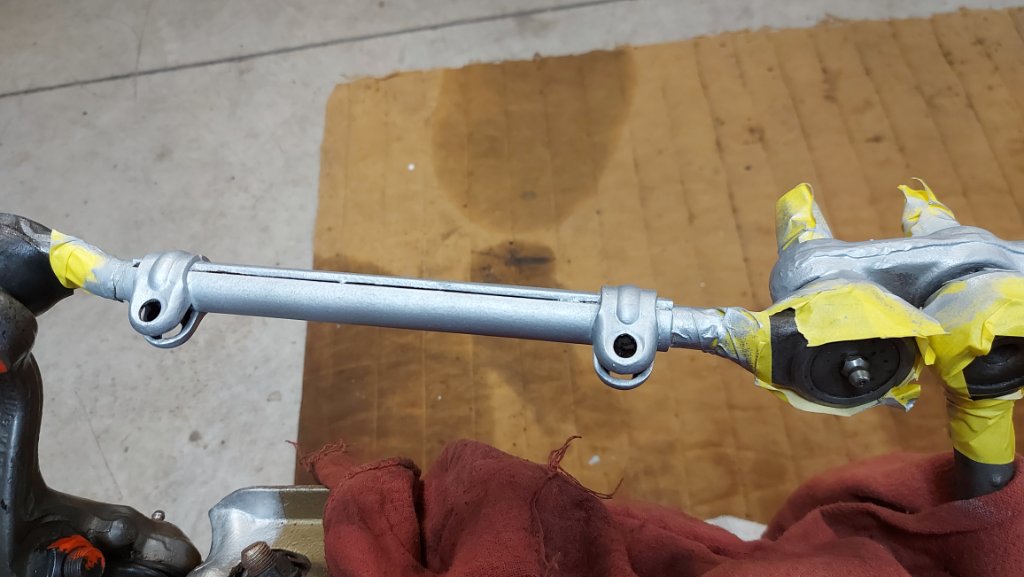

I'll do 2 coats of primer followed by the same VHT caliper steel colored caliper paint.

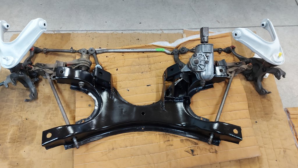

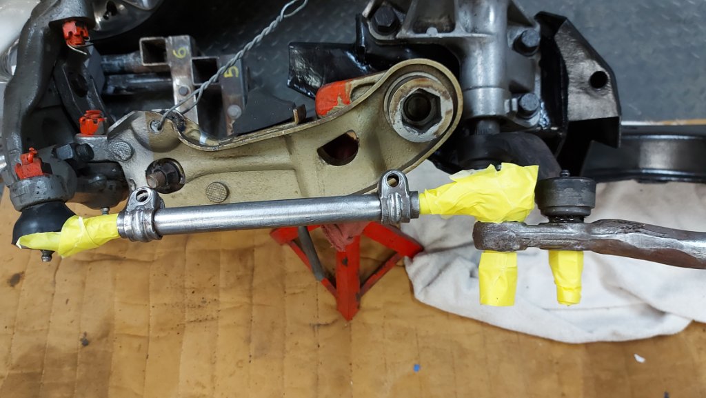

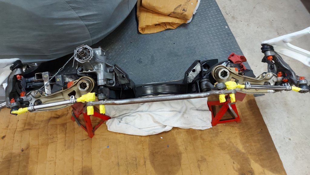

Post by 71Beeper » Mon Apr 10, 2023 8:04 pm
Two coats of primer later......followed by 2 coats of VHT caliper paint.
April 6th (1).jpg (89.11 KiB) Viewed 249713 times
April 6th (2).jpg (98.74 KiB) Viewed 249713 times
April 6th (3).jpg (80.23 KiB) Viewed 249713 times
April 10th (1).jpg (125 KiB) Viewed 249713 times
April 10th (2).jpg (121.86 KiB) Viewed 249713 times

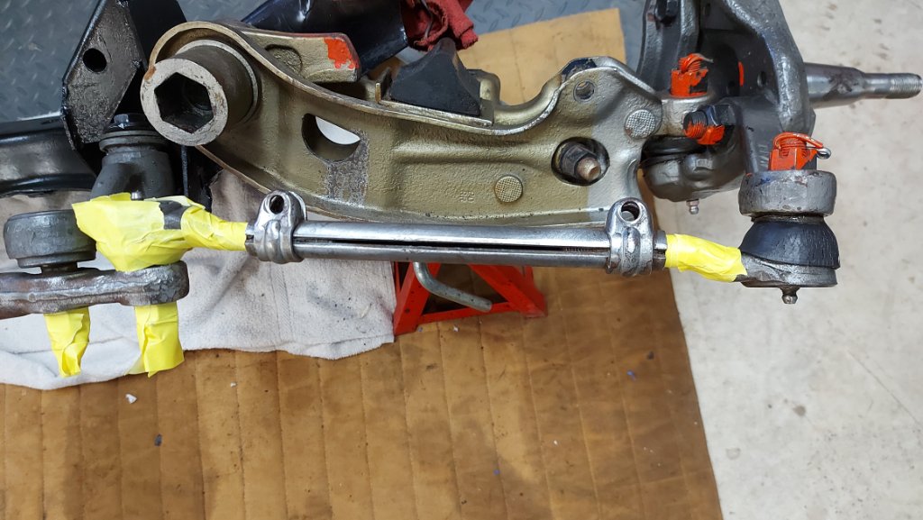

Post by 71Beeper » Mon Apr 10, 2023 8:06 pm

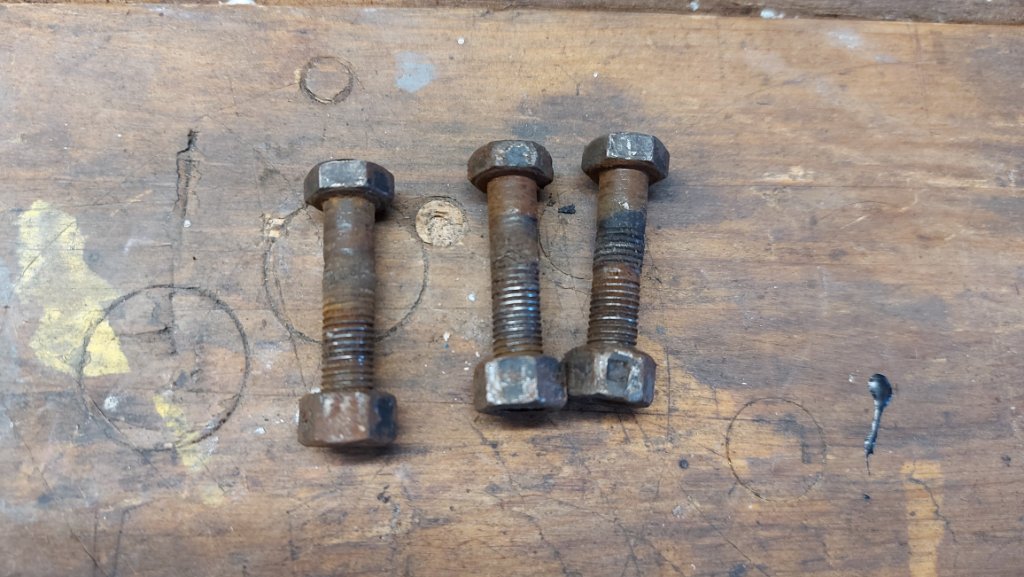

I did remove the old hardware that was on the tie-rod sleeve clamps.
April 10th (4).jpg (119.71 KiB) Viewed 249713 times
Not going to re-use those.

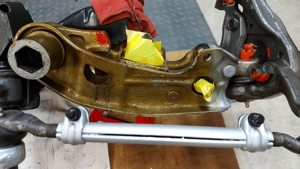

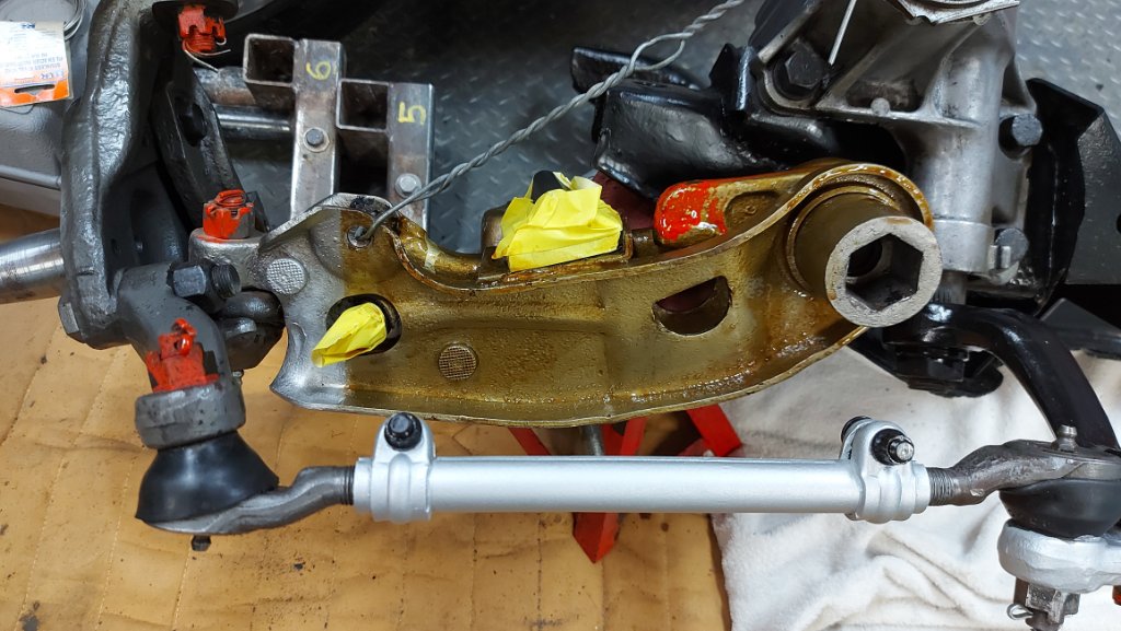

I also got around to applying actual cosmoline coating to the control arms just to bring back some of the amber color.
This stuff goes on wet and dries to a dry type of wax finish.

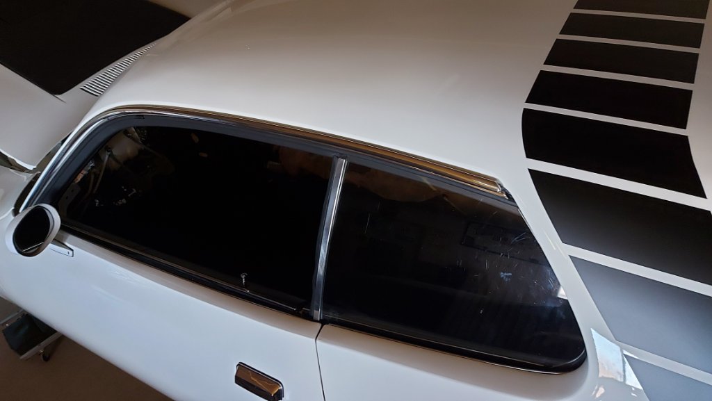

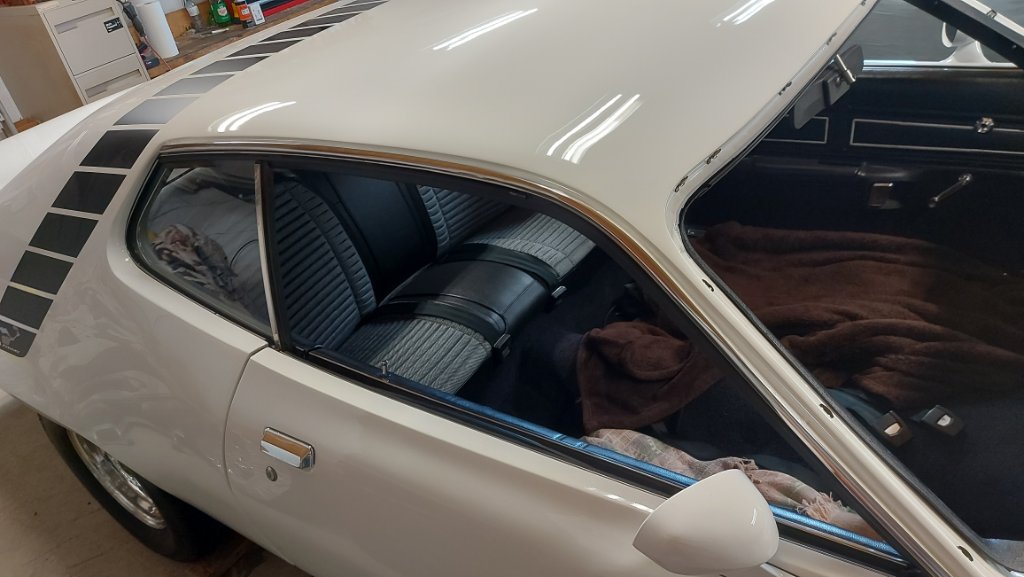

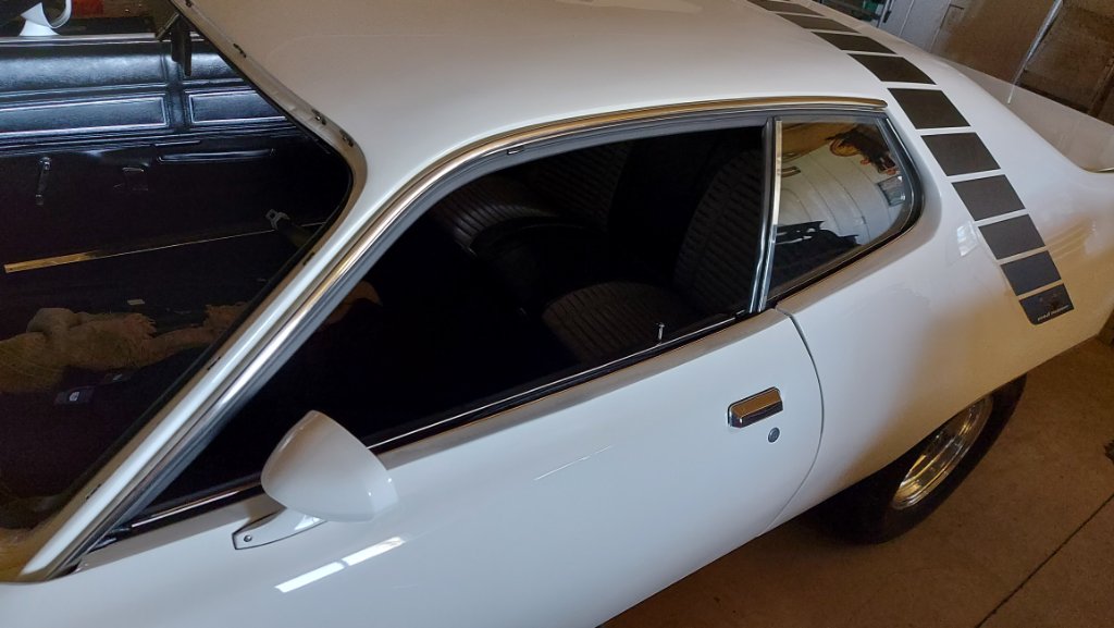

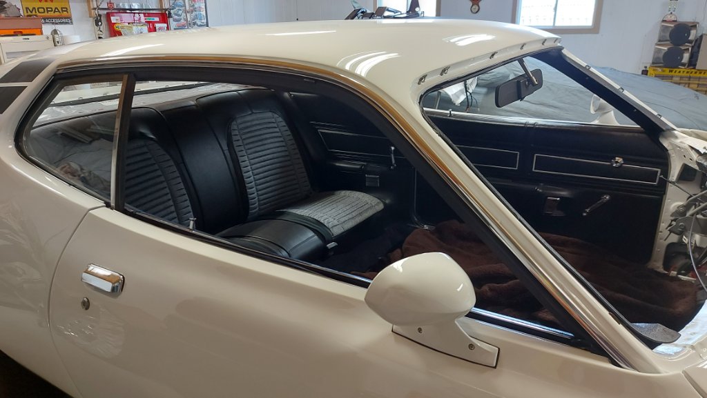

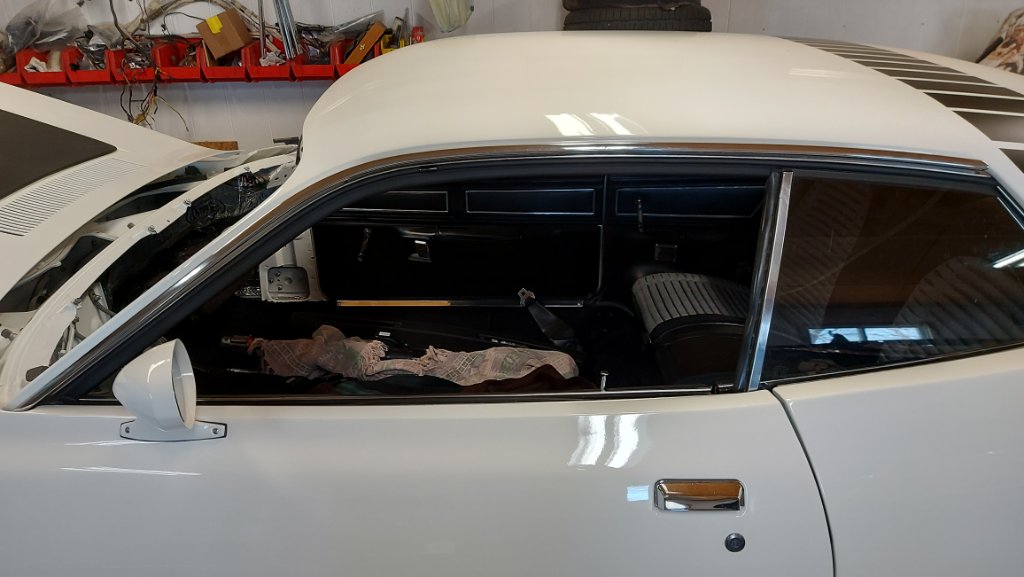

Finally I was able to put the rain gutter trim back on the car.
Problem with a white car is that stainless trim doesn't pop out as much compared to if it was painted a darker color.

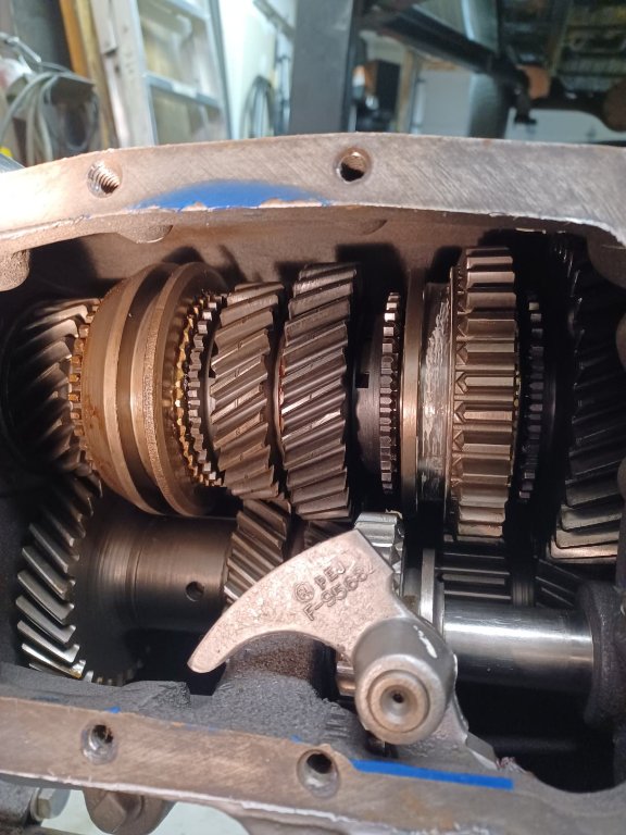

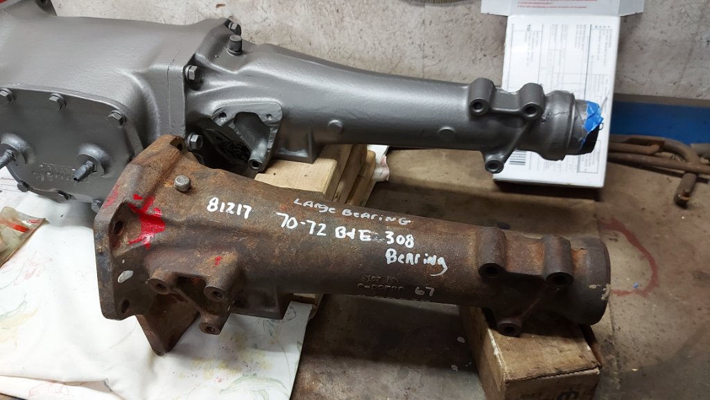

So I finally was able to get the tailstock on my 4 speed changed.
If you remember the shifter box mounting holes were damaged when I bought the 4 speed.
Feb 26th (4).jpg (91.68 KiB) Viewed 249620 times
And I was able to find a good replacement tailstock.
Feb 23rd (3).jpg (100.33 KiB) Viewed 249620 times
So, after ordering the correct gasket kit from Brewers I took the 4 speed to my good buddy Kevin's place to get it switched.
Here it is on the bench ready to go back together again.
April 22nd (4).jpg (114.64 KiB) Viewed 249620 times
Here's a look at the internals - Kevin said it was in great shape.
April 22nd (2).jpg (90.97 KiB) Viewed 249620 times
And here it is back together again waiting for me to pick it up.
April 22nd (1).jpg (94.57 KiB) Viewed 249620 times

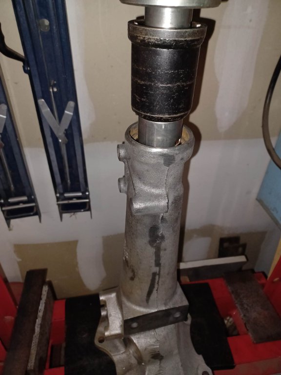

Post by 71Beeper » Sun Apr 23, 2023 8:11 pm
Oh, I forgot to mention, he did change out the bushing in the tailstock as well.
April 22nd (3).jpg (58.22 KiB) Viewed 249620 times

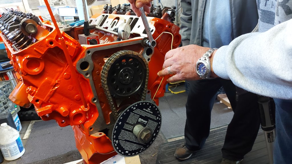

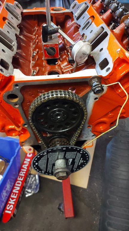

Post by 71Beeper » Sun May 07, 2023 11:37 am

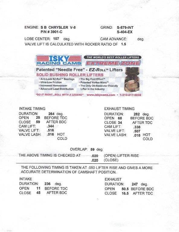

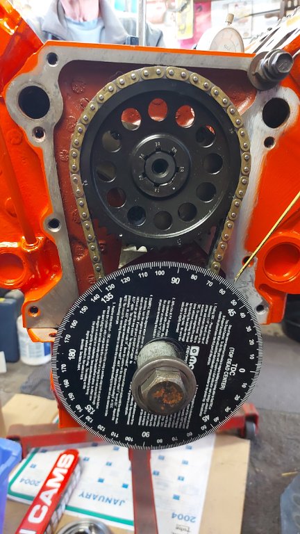

My buddy who assembled my engine, Brad came over yesterday and degreed the new Isky cam.
It was installed straight up as it already has 4 degrees of advance ground into it.
May 6th (2).jpg (146.67 KiB) Viewed 249517 times
May 6th (3).jpg (90.92 KiB) Viewed 249517 times
May 6th (4).jpg (87.34 KiB) Viewed 249517 times
Here's the cam info.
Isky cam info.jpg (77.7 KiB) Viewed 249517 times

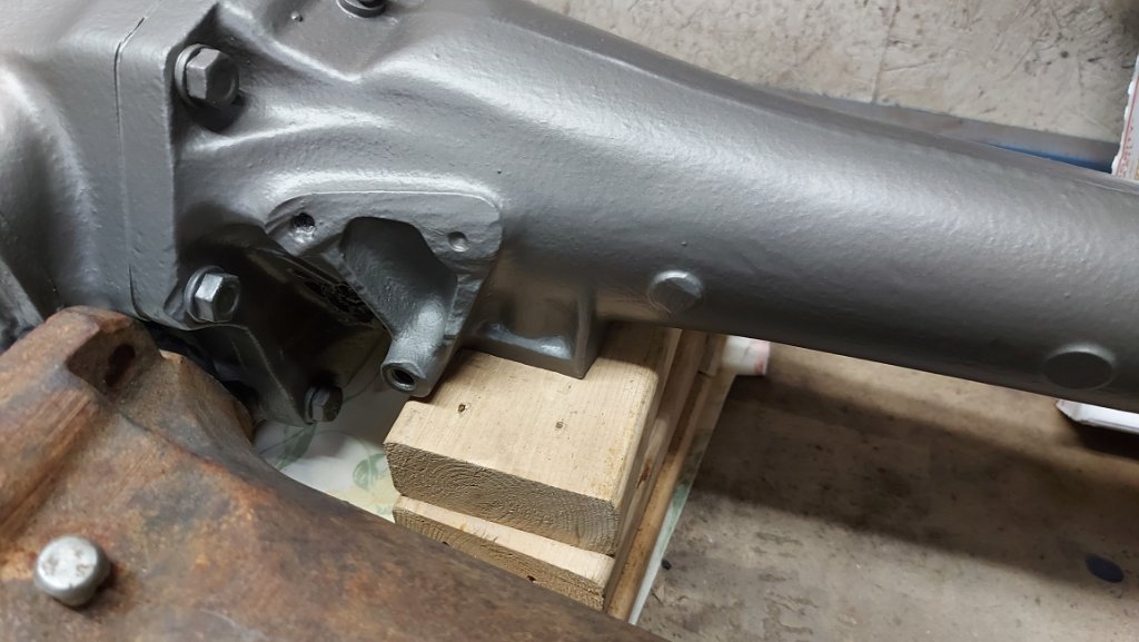

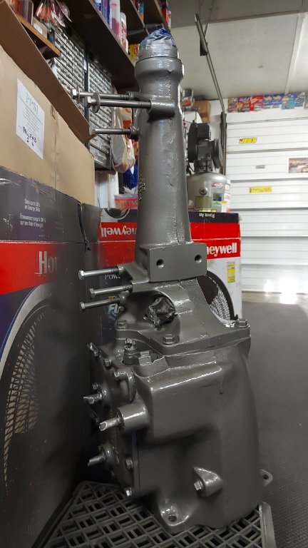

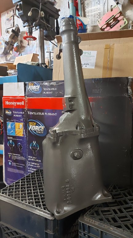

Post by 71Beeper » Thu May 18, 2023 7:30 pm

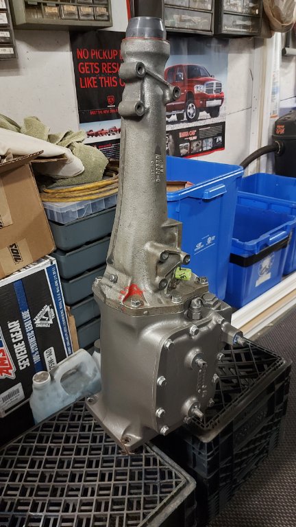

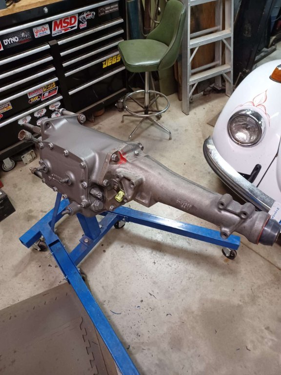

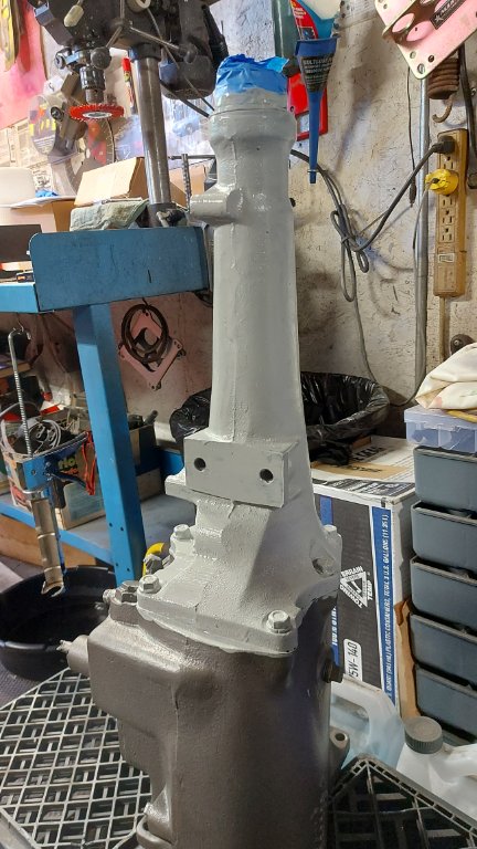

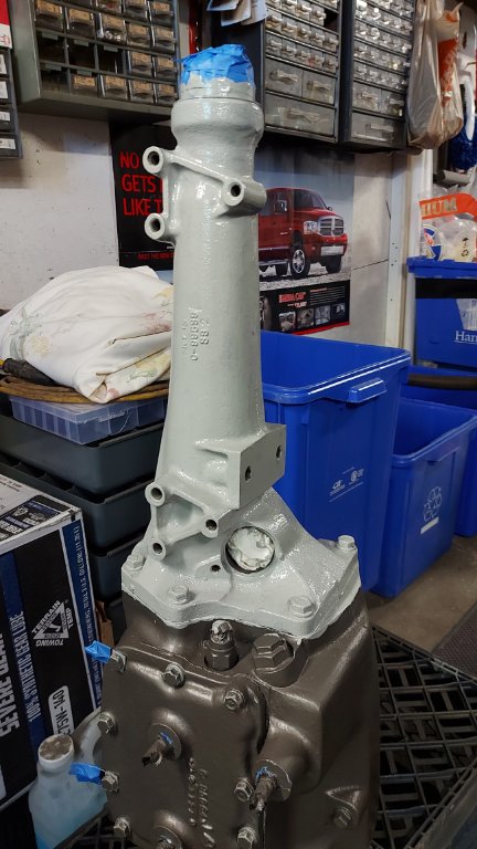

Finally got some time to put some primer on the 4 speed.
May 18 (1).jpg (77.9 KiB) Viewed 249356 times
May 18 (2).jpg (90.96 KiB) Viewed 249356 times
Then ruffed it up with some scotchbrite and sprayed some cast paint.
May 18 (4).jpg (81.84 KiB) Viewed 249356 times
May 18 (5).jpg (80.33 KiB) Viewed 249356 times
May 18 (6).jpg (66.31 KiB) Viewed 249356 times
I'll do a second coat tomorrow.

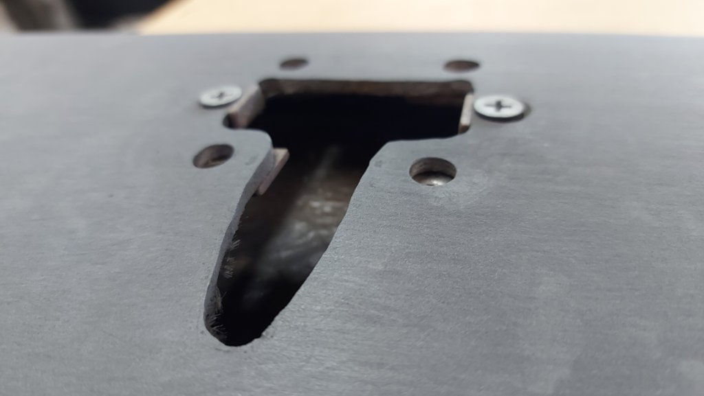

Post by 71Beeper » Tue May 23, 2023 9:24 am

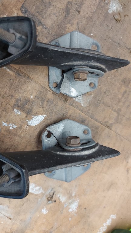

I did some horse trading and managed to get a gull wing.
May 22nd (5).jpg (87.72 KiB) Viewed 249308 times
But, the mounting brackets are broken.
May 22nd (8).jpg (65.93 KiB) Viewed 249308 times
Probably due to the fact the mounting surface was not flat...you can see the reinforcement plates and the screw heads are not flush.
May 22nd (6).jpg (50.14 KiB) Viewed 249308 times

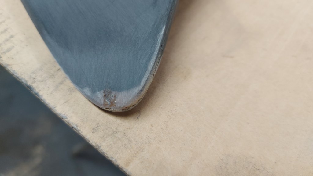

I've got new pedestals and mounting plates on order with Dante's.
And the corner tips need a bit of putty and clean-up.
May 22nd (9).jpg (49.89 KiB) Viewed 249308 times
May 22nd (10).jpg (30.34 KiB) Viewed 249308 times
