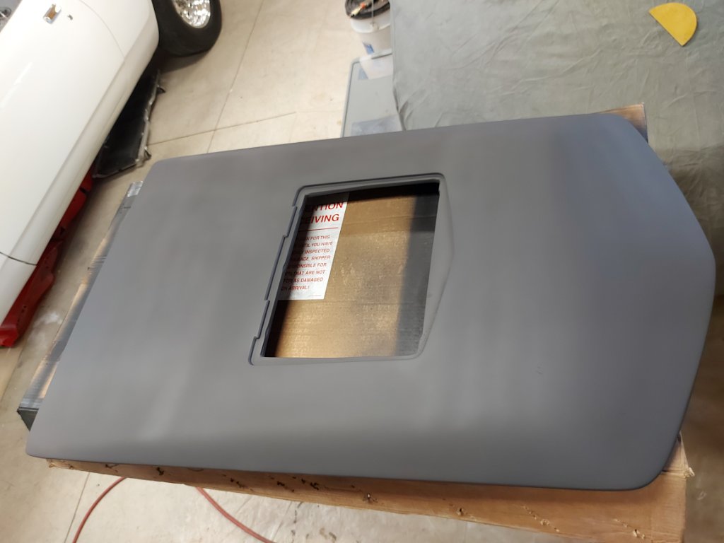

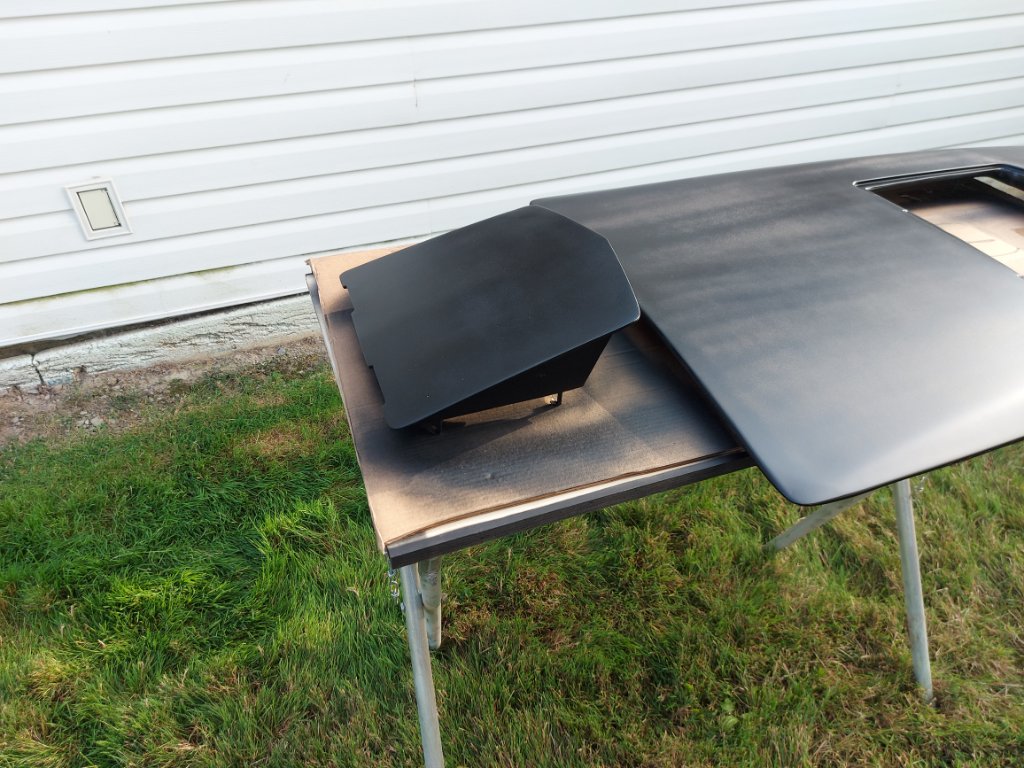

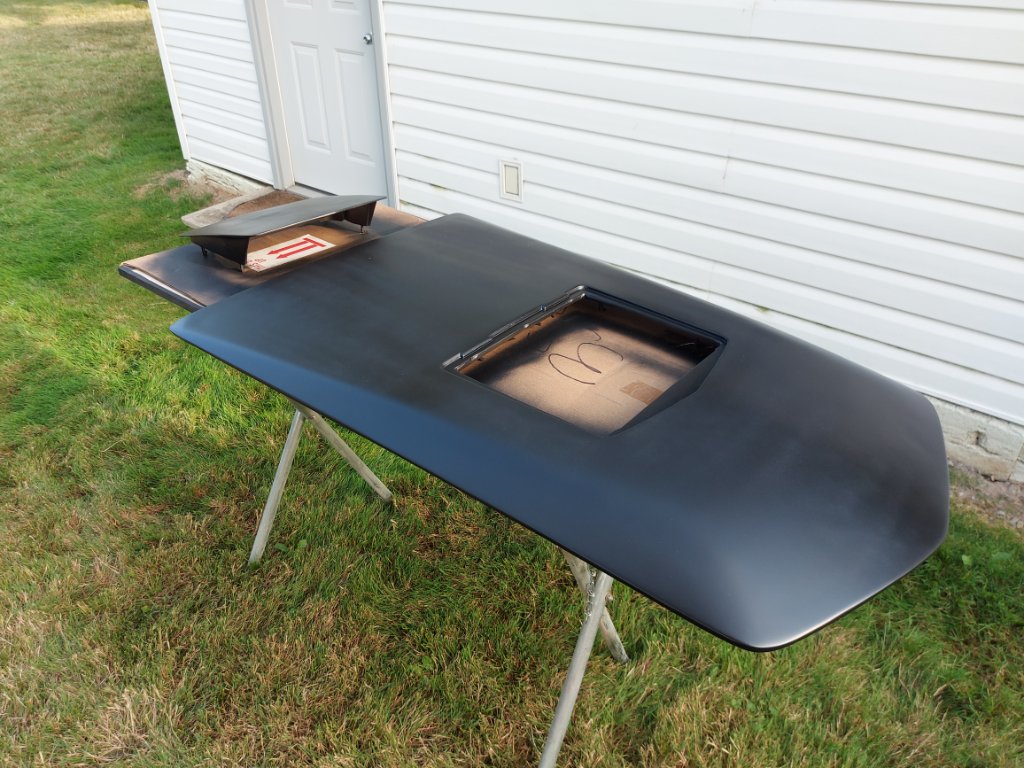

So I've been having some painting issues concerning the Air Grabber setup.
The initial primer application went on just fine.
The satin black application not so much.
Just a note - I'm rattle can spraying this Air Grabber. So the first product I used is the Mar Hyde satin black.
Marhyde paint.JPG (12.18 KiB) Viewed 45329 times
The underside of the Air Grabber....it went on perfect!
The topside..... :mad: not so much.
Aug 6th (2).jpg (170.22 KiB) Viewed 45329 times
Aug 6th (1).jpg (168.81 KiB) Viewed 45329 times
You may be able to see the streaking.
Anyways, it may be due to the excessive humidity we have had in this area the last little while.
Did I also mention that I'm painting this outside & nowhere near the car.... :shock:
So, my neighbor, who's a body and paint guy said to try the Rustoleum 2X satin.
Rustoleum satin black.JPG (28.52 KiB) Viewed 45329 times
So I did.......problem with that paint is it's too shiny like a semi gloss black, not a satin black.
Not to mention every time I sprayed a coat something just had to land on the fresh paint... :mad: making me have to go back and resand it.
So my third attempt I thought I'd try a flat black paint.
High heat engine paint..JPG (18.54 KiB) Viewed 45329 times
Since the satin black was too shiny I thought maybe the flat would be just like the satin.
Well, I was wrong.

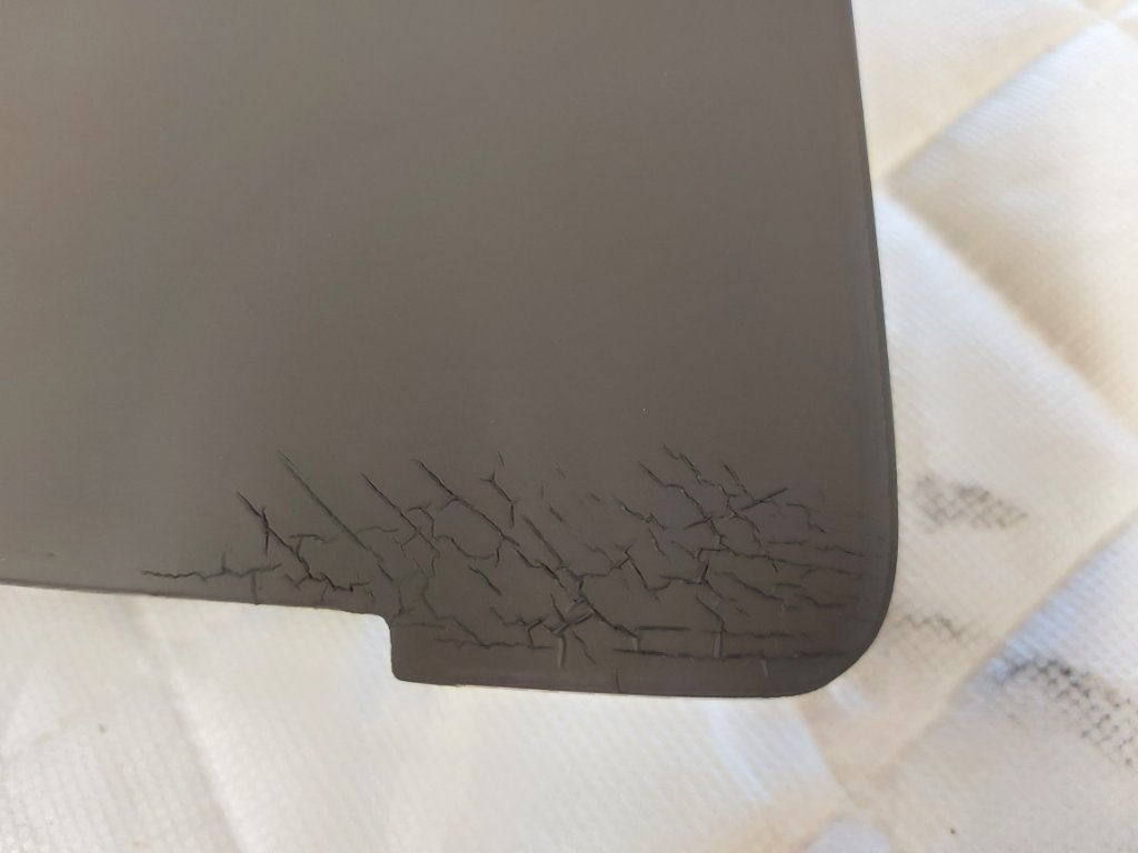

Not to mention the paint reacted and did this.... :mad:
Aug 21st (17).jpg (22.79 KiB) Viewed 45329 times
Aug 21st (19).jpg (43.35 KiB) Viewed 45329 times
So, I'm going to wait till the humidity goes away from this area and try it again.
I'm also going to try painting it inside in my other garage attached to the house and I'll sit the Air Grabber insert vertically.

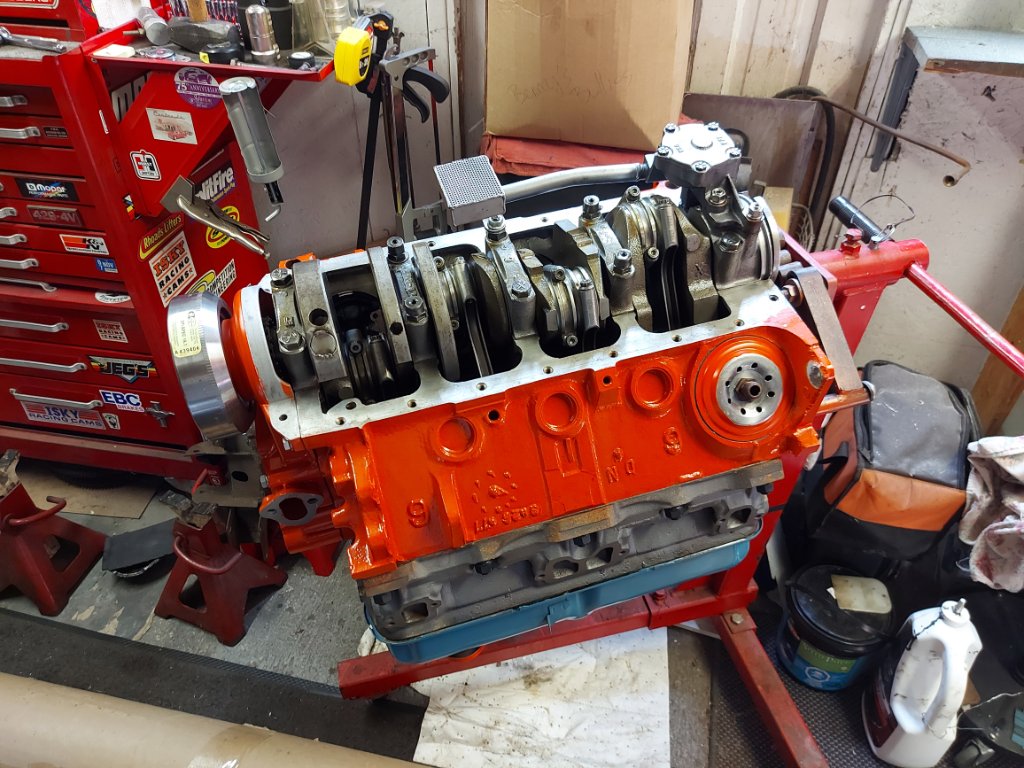

First order of business....get the oil pan mounted.
Post by 71Beeper » Sat Aug 21, 2021 8:47 pm

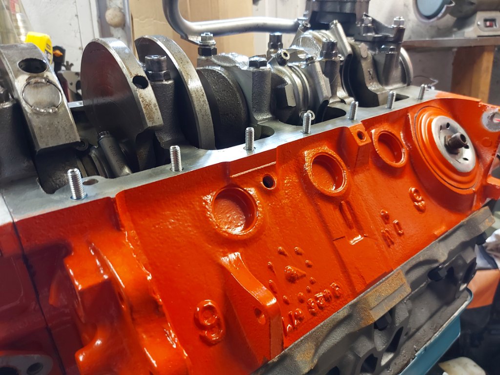

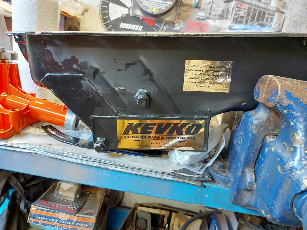

Here's the oil pan, it a Kevco pan I bought years ago.
Aug 21st (8).jpg (174.77 KiB) Viewed 45329 times
First order of business, get the stainless studs mounted with blue Loctite.
Aug 21st (21).jpg (149.72 KiB) Viewed 45329 times
Next step is to prep the gasket surfaces, but that's for another day...

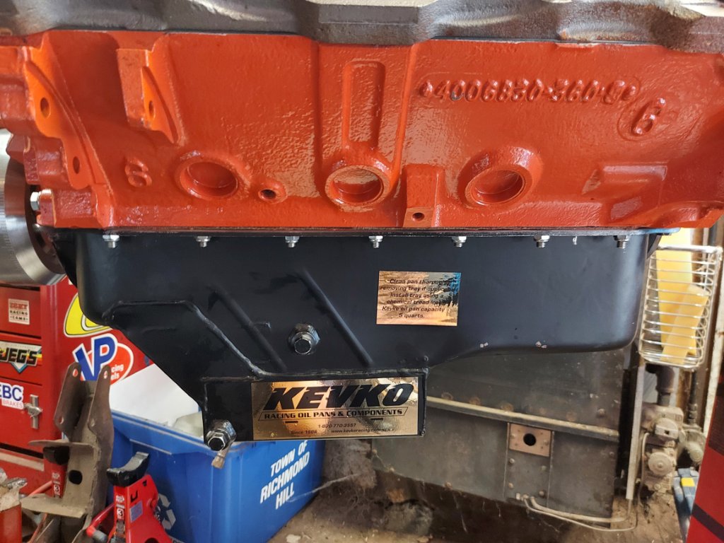

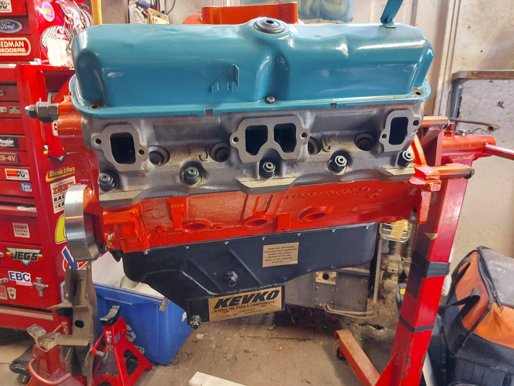

So this weekend was too humid to do any painting so I had some time to get the oil pan on the engine.
The engine is in a one car garage that's attached to the house and it too is an oven trying to work in there.
Aug 29th (1).jpg (161.5 KiB) Viewed 45289 times
Aug 29th (2).jpg (145.86 KiB) Viewed 45289 times

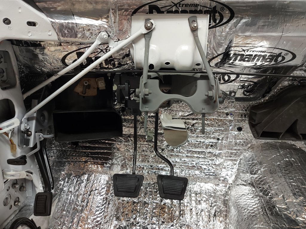

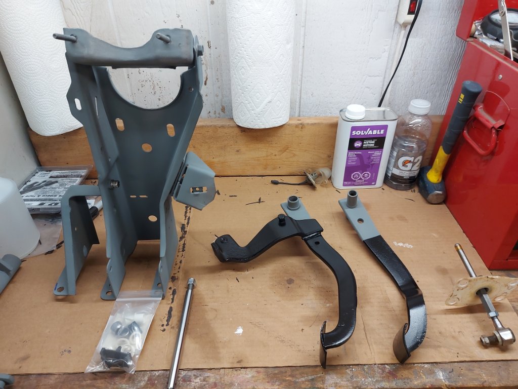

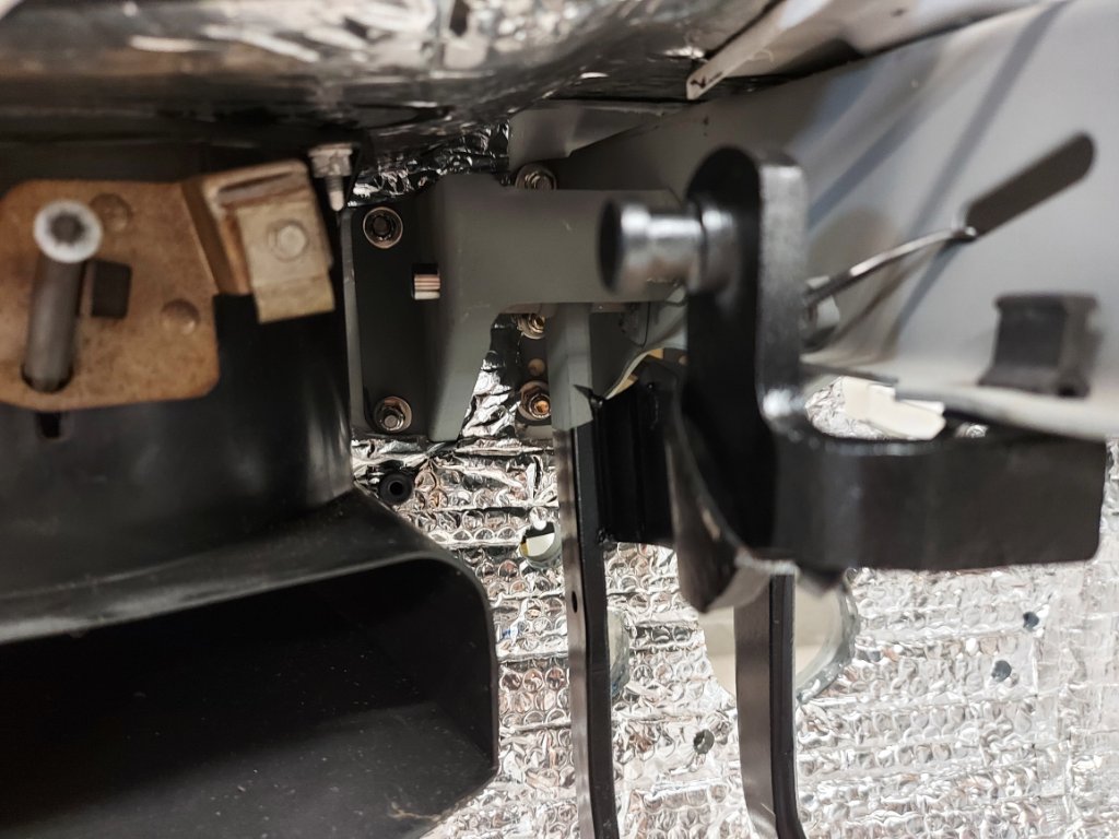

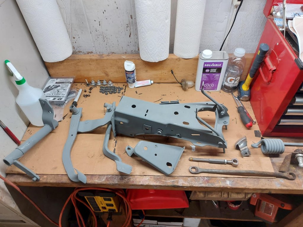

I also had some time to pull the clutch pedal/brake pedal assembly from the attic.
clutch pedal assy.jpg (143.38 KiB) Viewed 45289 times
I bought it from a buddy who was going to convert his dad's Charger to a 4 speed car and when his dad found out about he said no way.
So I bought whatever 4 speed stuff he accumulated.
So as you can see, he took it apart and had the bit primed.

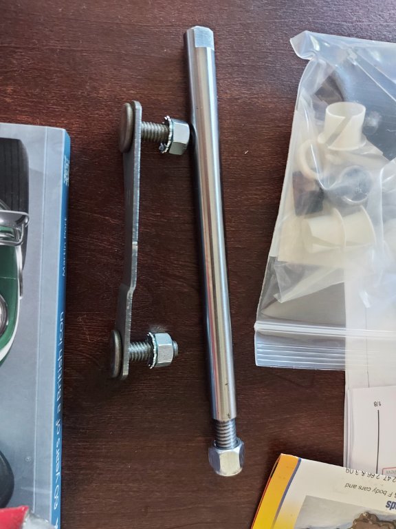

The most important piece is missing......the main shaft that supports the pedals, so I put an order in to Brewers and my parts came in.
Aug 28 (1).jpg (81.41 KiB) Viewed 45289 times
Aug 28 (2).jpg (69.22 KiB) Viewed 45289 times
So, I'll be able to put it back together and get it in the car.

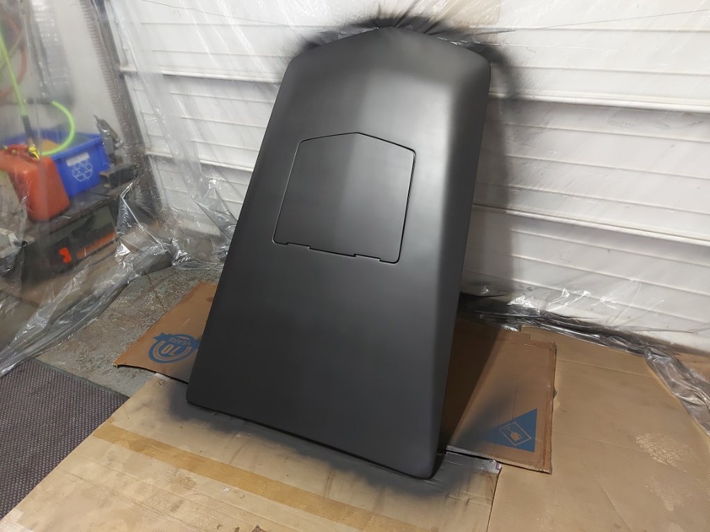

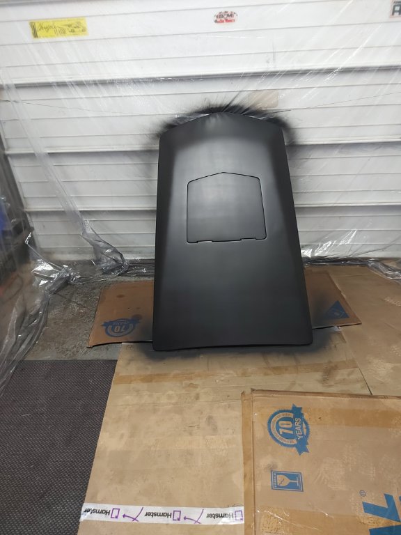

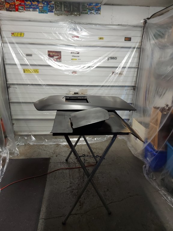

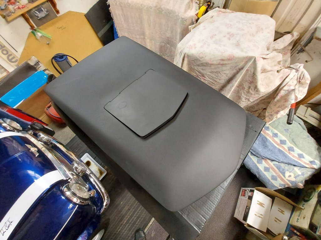

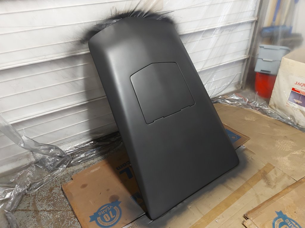

With the weather finally cooling down and the humidity gone I got back to painting the Air grabber setup.
I sprayed it inside the front garage.
First thing I had to do was to put the wife's Mini outside.
Sept 6th (5).jpg (216.97 KiB) Viewed 45218 times
Then put up some plastic to protect from overspray.

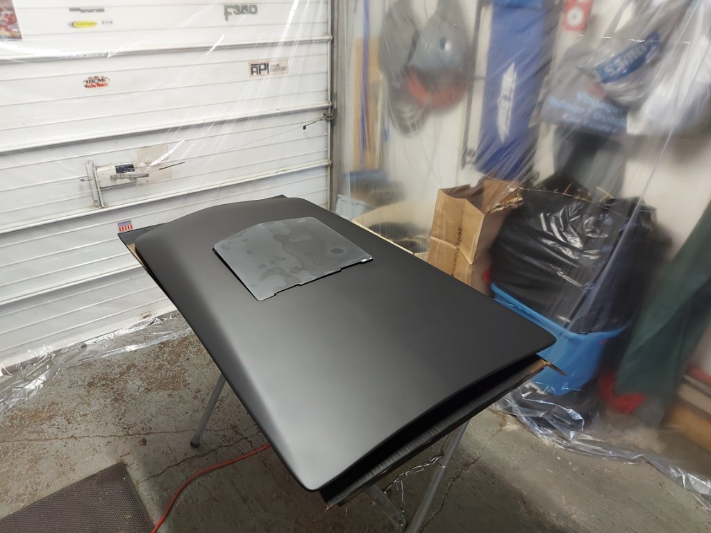

I sprayed some black primer on it but the same spot on the door reacted so I removed the door.
Sept 6th (2).jpg (74.18 KiB) Viewed 45218 times
Took it to the other garage to sand it down.
In the meantime I'm putting on light coats of the SEM satin black.
I cleaned up the door and put it ins its place on the assembly and am continuing with the light coats.
So far so good....fingers crossed.
Sept 6th (3).jpg (113 KiB) Viewed 45218 times

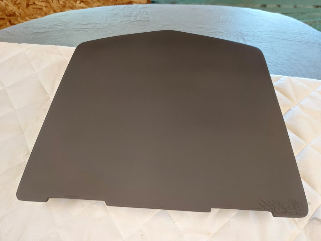

Post by 71Beeper » Tue Sep 14, 2021 7:41 pm
So I waited till the next day to put the finishing coats on it.
Here's how it looked before the final coats went on.
Sept 8th (1).jpg (158.57 KiB) Viewed 45135 times
Sept 8th (2).jpg (149.44 KiB) Viewed 45135 times
The light coats went on well with a good 45 min. wait time between coats.
I'm okay with the results.
I also decided to try and reposition the assembly to see if applying paint this way would be better.
Sept 8th (3).jpg (97.51 KiB) Viewed 45135 times
Sept 8th (4).jpg (101.11 KiB) Viewed 45135 times
Sept 8th (5).jpg (67.1 KiB) Viewed 45135 times
Is it perfect??? well... no but it's fine for me.
Besides, with the amount of coats of paint that are on it, it'll be just fine.
I want to enjoy driving this car.

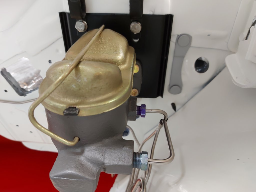

Post by 71Beeper » Tue Sep 14, 2021 7:52 pm

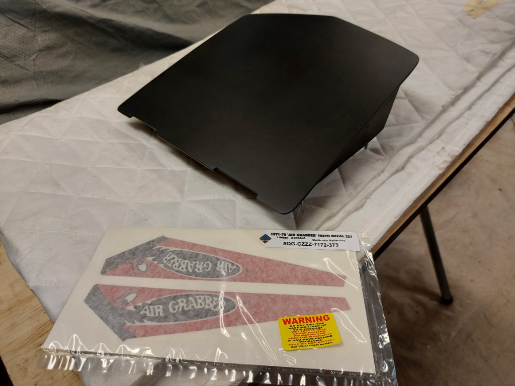

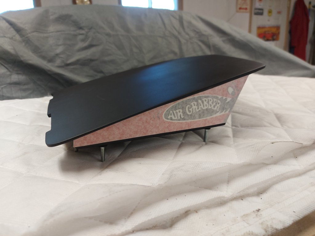

The next thing to go on now are the Air Grabber decals that go onto the sides of the door.
Then install it on the hood.
But, in the meantime I got all of the pieces of the clutch / brake pedal assembly ready to be put together.
Sept 13th (1).jpg (138.23 KiB) Viewed 45135 times

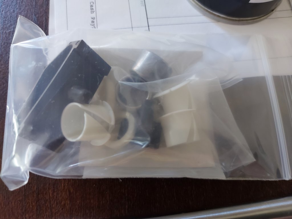

Install the roller bearings and felt seals in the clutch pedal housing and install the plastic bushings in the brake pedal housing.
Also, I installed this plastic retainer....it has a rubber bellows type seal on the other side of it, I assume its to keep any water from getting into the back of the master cylinder.
Sept 13th (4).jpg (175.59 KiB) Viewed 45135 times

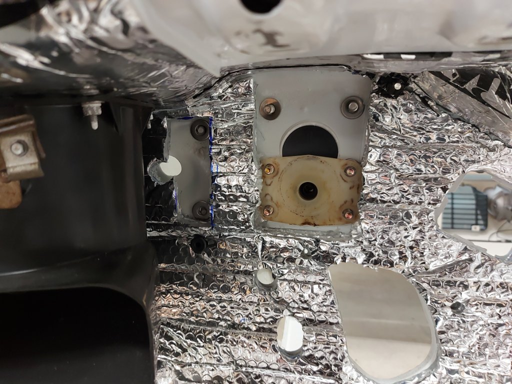

Then put the whole thing in the car.
Oh, and don't forget the rubber pedal attachments too.
Sept 13th (5).jpg (231.84 KiB) Viewed 45135 times
Sept 13th (6).jpg (228.6 KiB) Viewed 45135 times
Sept 13th (8).jpg (118.3 KiB) Viewed 45135 times
Post by 71Beeper » Tue Sep 14, 2021 7:53 pm
I almost forgot, I had to drill two holes in the firewall for the clutch pedal reinforcement to be installed.
Sept 13th (9).jpg (71.62 KiB) Viewed 45135 times

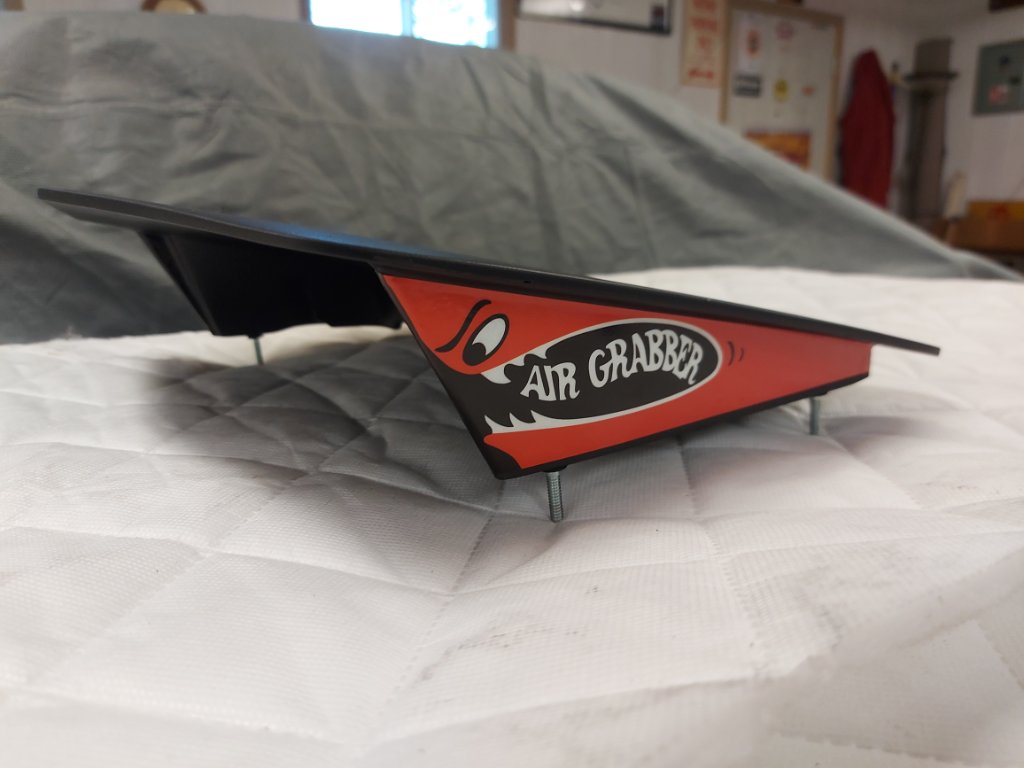

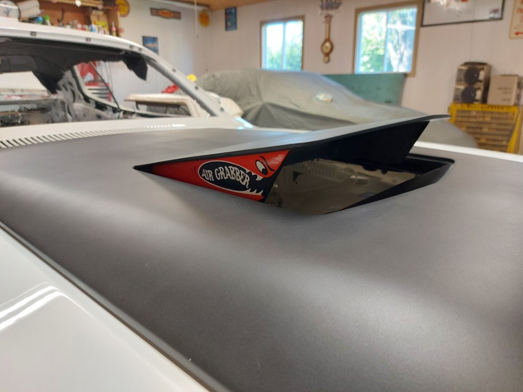

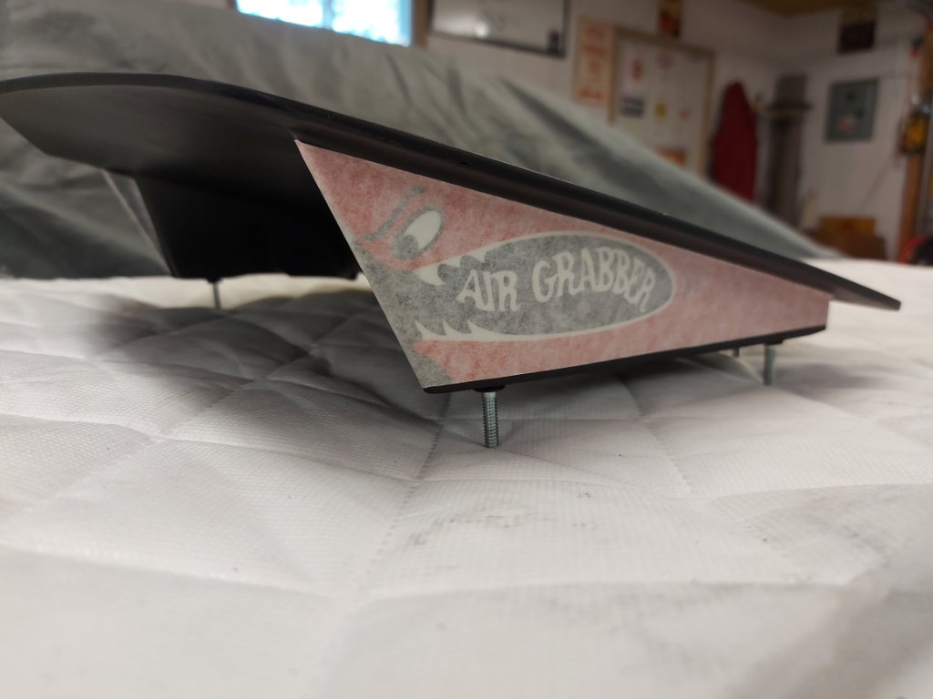

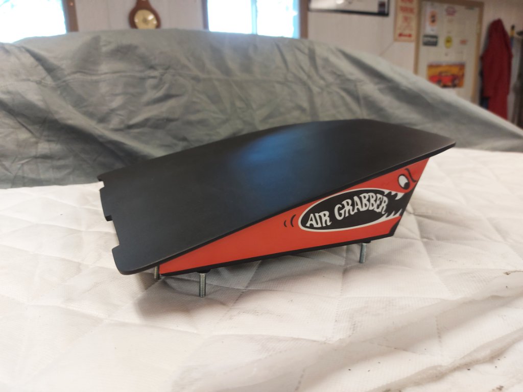

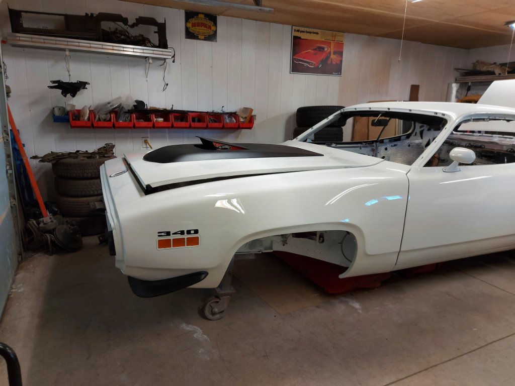

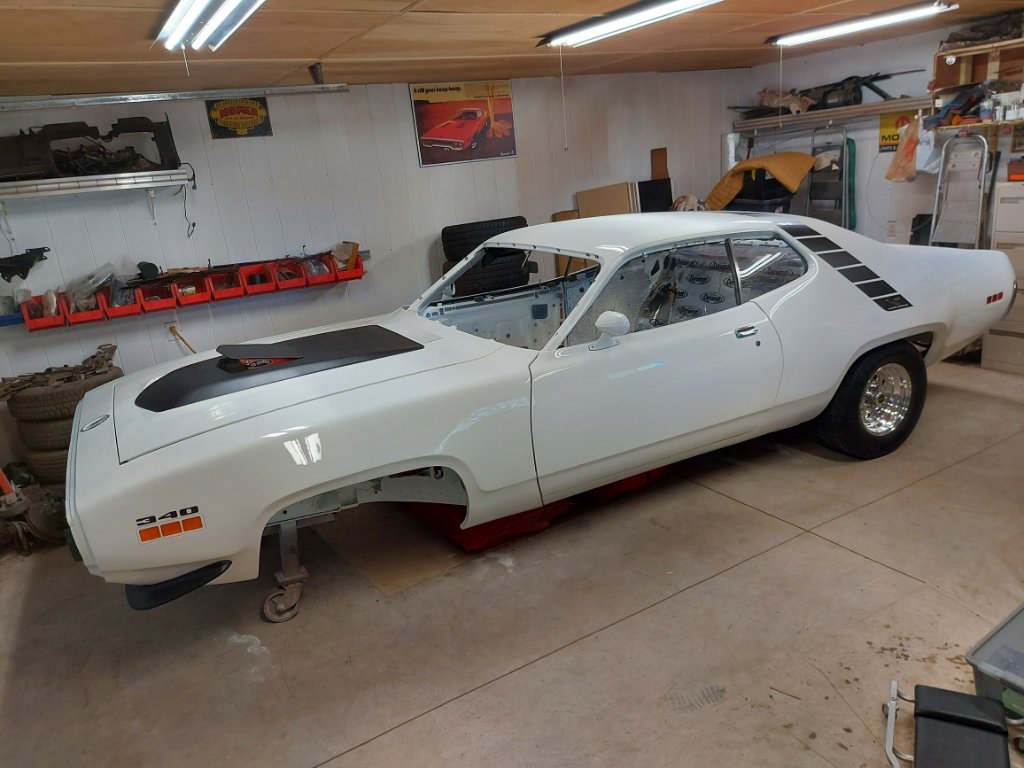

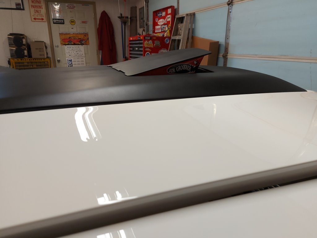

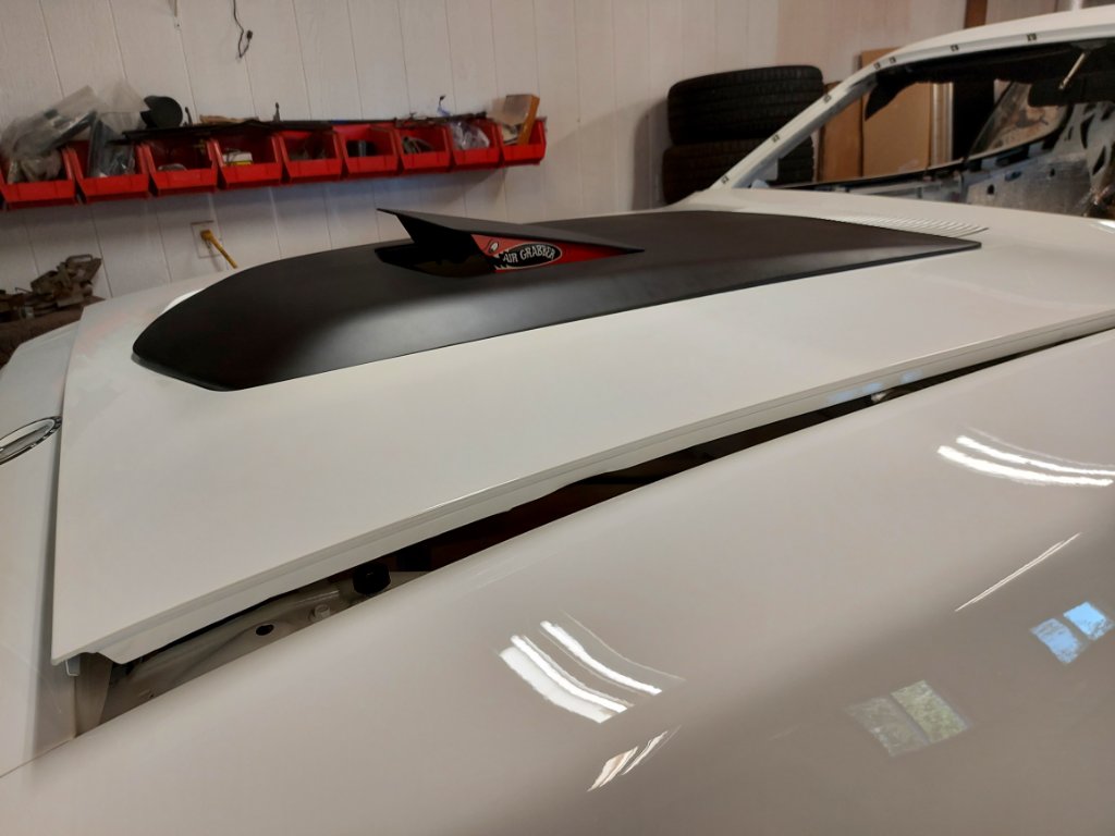

I had time this weekend to finally get the Air Grabber setup on the car.
First the Air grabber decals.
Sept 18th (5).jpg (102.26 KiB) Viewed 45078 times
Sept 18th (6).jpg (77.92 KiB) Viewed 45078 times
Sept 18th (7).jpg (68.84 KiB) Viewed 45078 times
Sept 18th (8).jpg (73.94 KiB) Viewed 45078 times
Sept 18th (9).jpg (73.57 KiB) Viewed 45078 times

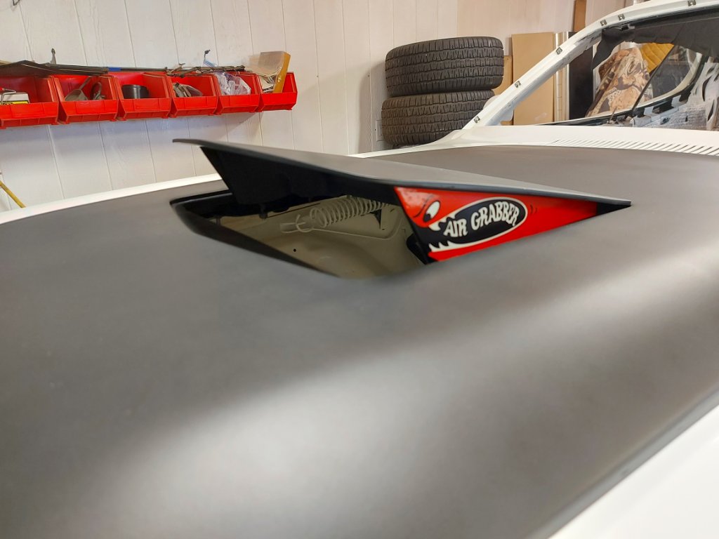

Post by 71Beeper » Sun Sep 19, 2021 9:38 pm
And now, the rest of it.
Sept 18th (14).jpg (84.67 KiB) Viewed 45078 times
Sept 18th (15).jpg (78.99 KiB) Viewed 45078 times
Sept 18th (12).jpg (71.57 KiB) Viewed 45078 times
Sept 18th (13).jpg (58.95 KiB) Viewed 45078 times
Sept 18th (11).jpg (98.51 KiB) Viewed 45078 times

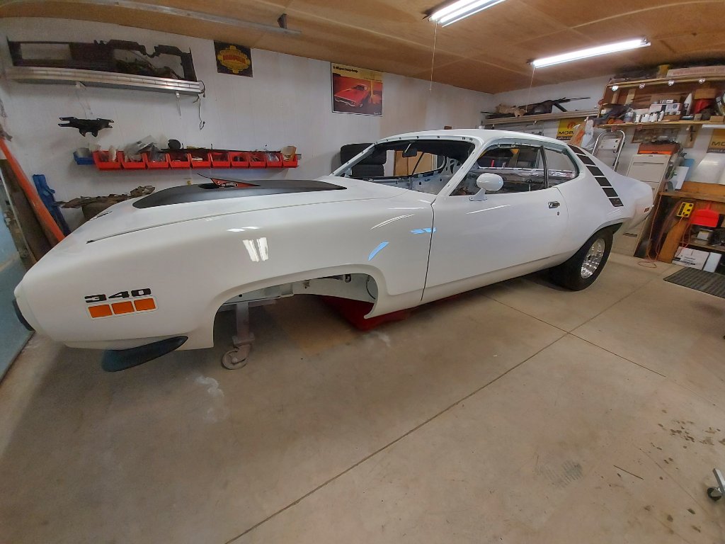

Post by 71Beeper » Sun Sep 19, 2021 9:39 pm
One last picture of the whole thing.
Sept 18th (16).jpg (115.01 KiB) Viewed 45077 times
Sept 18th (18).jpg (114.14 KiB) Viewed 45077 times
