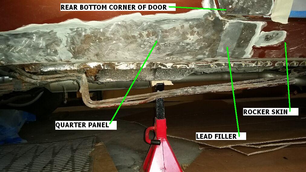

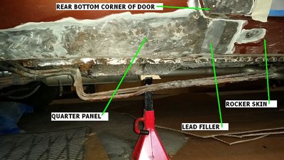

Wondering if you did anything with the outer rockers when you had the quarters off, and if you have any pix of the area under the B-pillar with the quarter and the rocker skin off the car. I butchered mine a bit cutting the rocker skin off, not knowing how that area was constructed. I'm still not exactly sure.

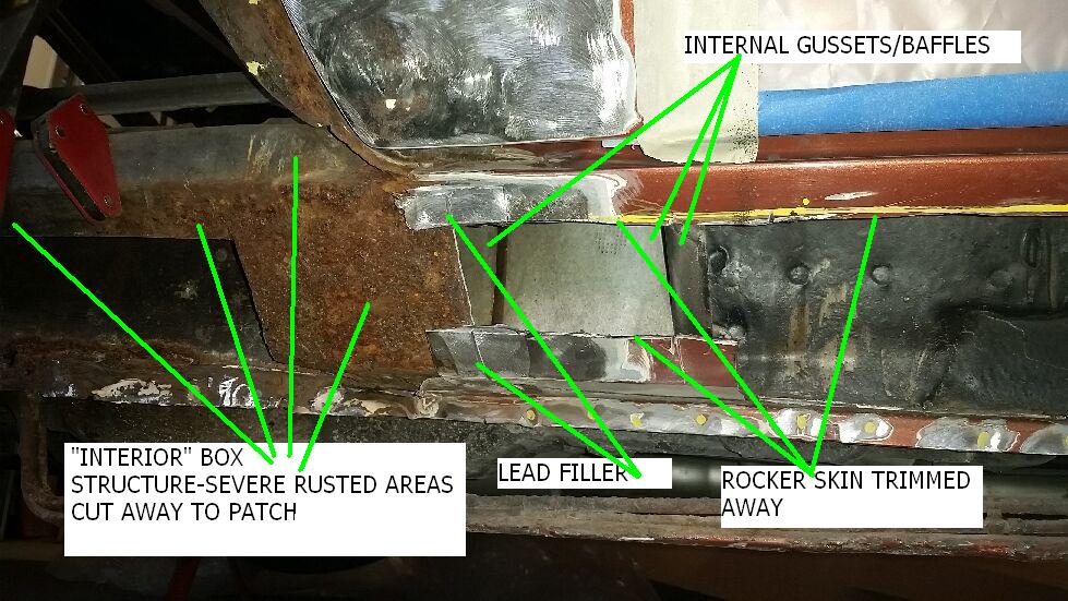

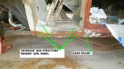

This is what I'm struggling with - not that it matters now on the passenger side. But when I start on the other side........
See the attached pics - what I'm thinking is that the area I call "interior" boxed structure which is hidden by the quarter, is actually part of the rocker skin / outer rocker. I think the outer rocker "dips" inward at the lead joint. This dip allows the receding flange on the quarter to butt up to the area on the rocker where it dips in. That's where the lead is laid in.
Does this sound right?

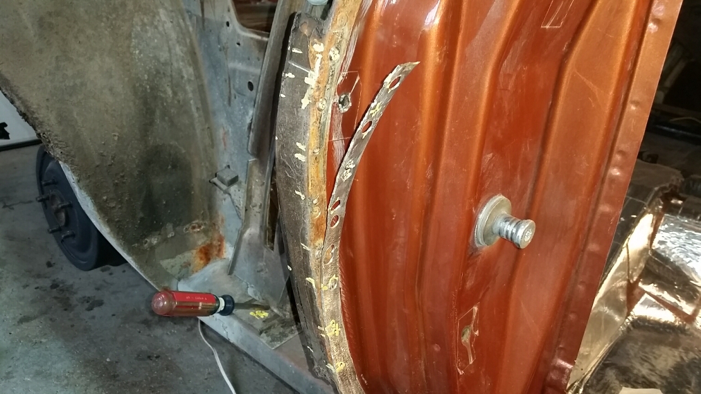

by 71_bronze_gtx » Tue Mar 14, 2017 3:01 pm
That looks like it's already been replaced. All those tack welds aren't factory. The original flange was spot welded. Here's mine as I was peeling it off the door jam one weld at a time. First used a cutoff wheel right on the corner to get the quarter skin out of the way. Then you can see all the welds from the back side. You're lucky, it will be much easier to grind off those tack welds than to locate and separate plug welds.
