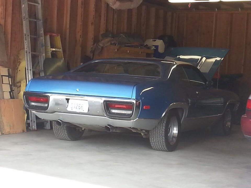

Doesn't fall into the 73-74 group but too neat not to share.  I bought a core dash pad from a guy with THE coolest Satellite Sebring Plus I've ever seen.  Factory 400-4bbl, front a rear sway bars, Sure Grip 8-3/4, power windows, buckets, console, A/C, disc brakes, Rallye dash with clock, fender mount turn indicators, machine gun tips and get this...sun roof.  All factory ordered.  Fender tag was maxed out.  Oh yeah, the guy was really nice.  Humble and friendly.  Battle Ground, WA

Hey sooopr - email sent. 71Satellite98661 T. - did you happen to get any pics of that sunroof car??
Thanks, Scott. EDIT - Whoops, just realized that the picture above is the car. I know you were working on a blue car - and thought you had posted yours - but yours is a 71 not a 72.
