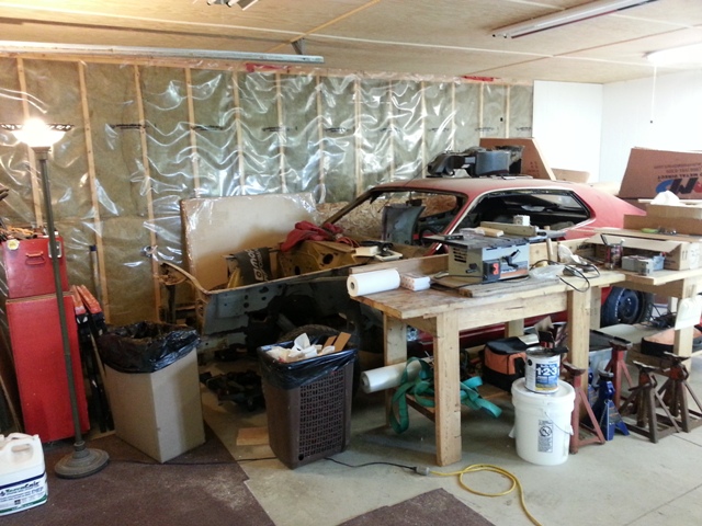

So, here I am back at it. Had to take a break to finish off the inside of the garage where my car is kept.
Here's what it looked like with all the stuff in it.

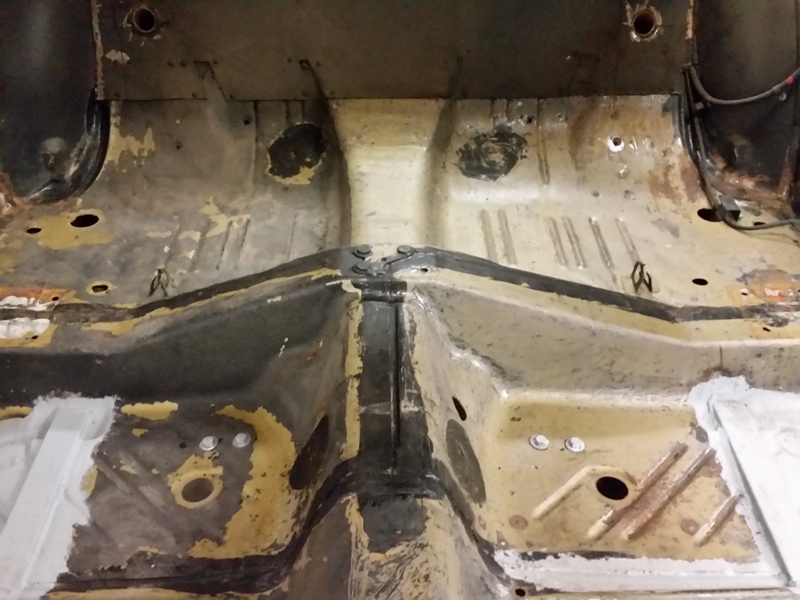

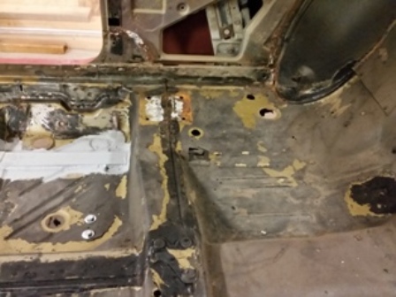

So now I've got all the crap off of it and all the stuff around it cleared away. I decided to remove all of the old seam sealer and clean up the floor area.
In the above picture you can still see the plate on the floor where the roll cage was attached, I will remove that.
Next, I noticed the seam on the passenger side in the front corner going up to the cowl.....looks like I'll have to give that some attention.
Next is the rear passenger side in front of the rear wheel well.
It'll need some clean-up. But it is nice to see some of the original gold paint on parts of the floor.

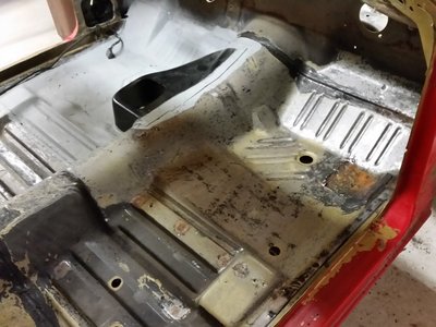

Post by 71Beeper » Sun Jan 03, 2016 5:30 pm
A little more progress today.
The drivers side (one the right) has all been cleared.
Compare it with the passenger side, that's what I have to clean up next.
At the top of the photo you can see the stubs where a roll cage one lived.

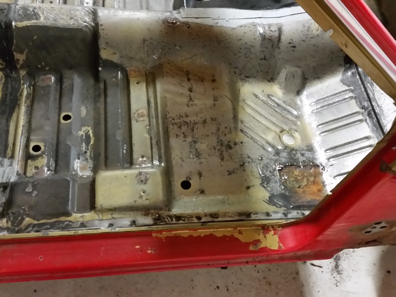

Post by 71Beeper » Sun Jan 10, 2016 8:12 pm
So more scraping done this weekend.
I have most of the front portion of the passenger side done.
I also removed the plate that was the mount for the roll cage. That little piece that is left I may leave as it's hard to get a grinder in there to cut out that piece.
Here's another picture.
There's gold (paint that is) under them thar undercoating!!!

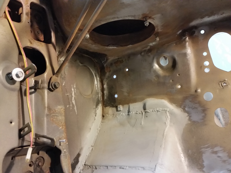

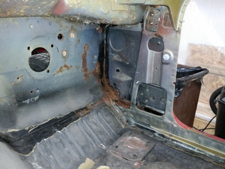

Post by 71Beeper » Sun Jan 17, 2016 5:32 pm

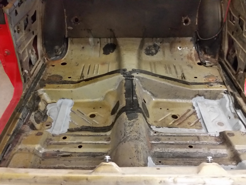

Finally, the whole floor is now finished.

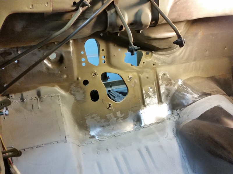

Now to move on to the inside of the firewall starting at the drivers side.
Got to get it cleaned up and put on some rust encapsulating paint.

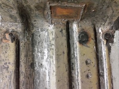

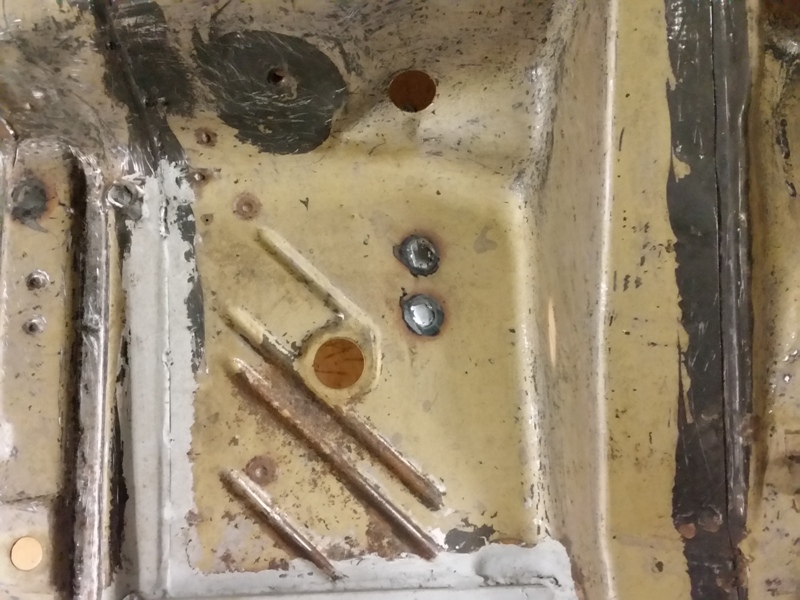

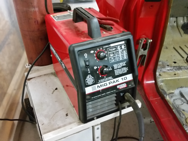

Thanks Scott, I figure just keep workin on it on weekends. This weekend I got to working on my welding skills.
First I had to hook up the CO2/Argon gas to my mig welder.

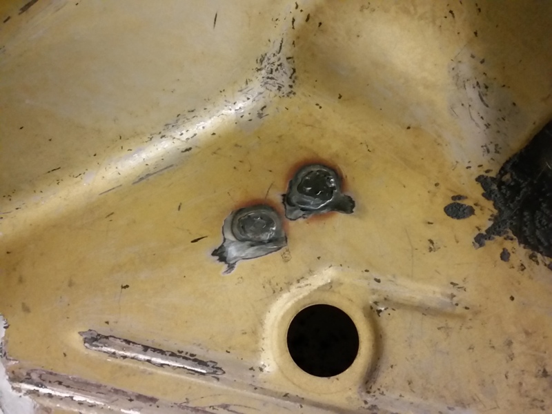

I'm no expert but I got some holes welded up on the floor. I welded up the holes that held the homemade drive shaft safety loop.
I'd rather have the loop that U.S. tool company sells, the one that bolts to the tranny mount.
Then I welded up some seat mounting holes that were for a pair of aftermarket ricer seats.
I still have one more to close up (the one on the left).

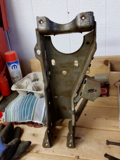

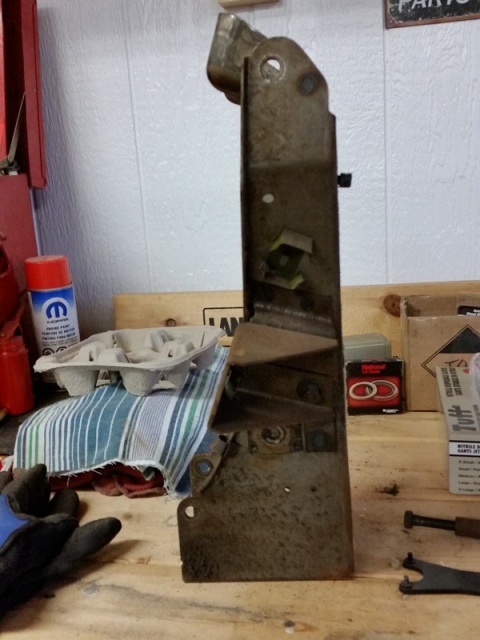

Post by 71Beeper » Sun Jan 24, 2016 9:08 pm
Guys, I do have a question. Is the interior bracket that holds the brake pedal and steering column the same for automatic cars and manual transmission cars?
Since I am converting mine to a 4 speed will I need a different bracket to hold the clutch pedal?

Post by farmboy70 » Tue Jan 26, 2016 9:36 am
Here is a picture of a four speed pedal assembly.
This is out of my 71 SSP.
DaveImageImageImage

Post by 71Beeper » Tue Jan 26, 2016 9:25 pm
Thanks for the info and pictures farmboy70 . Now I see the extra piece I will be needing that supports the clutch pedal. Time to start lookin.

Post by farmboy70 » Wed Jan 27, 2016 12:32 am
You will also need the longer rod, the firewall side brace too.
These are available at Brewers Performance if you can't find used ones.
